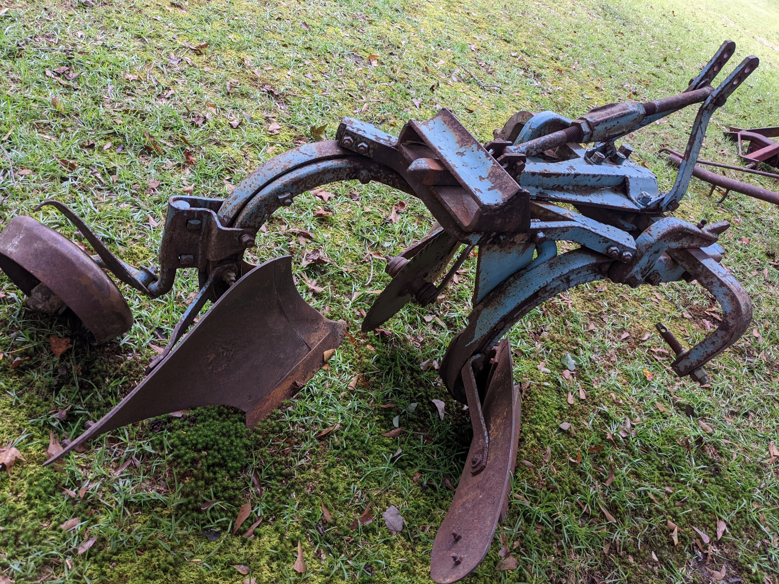

We have had a few bottom plows before but none made like this one. Anybody have idea on make and model?

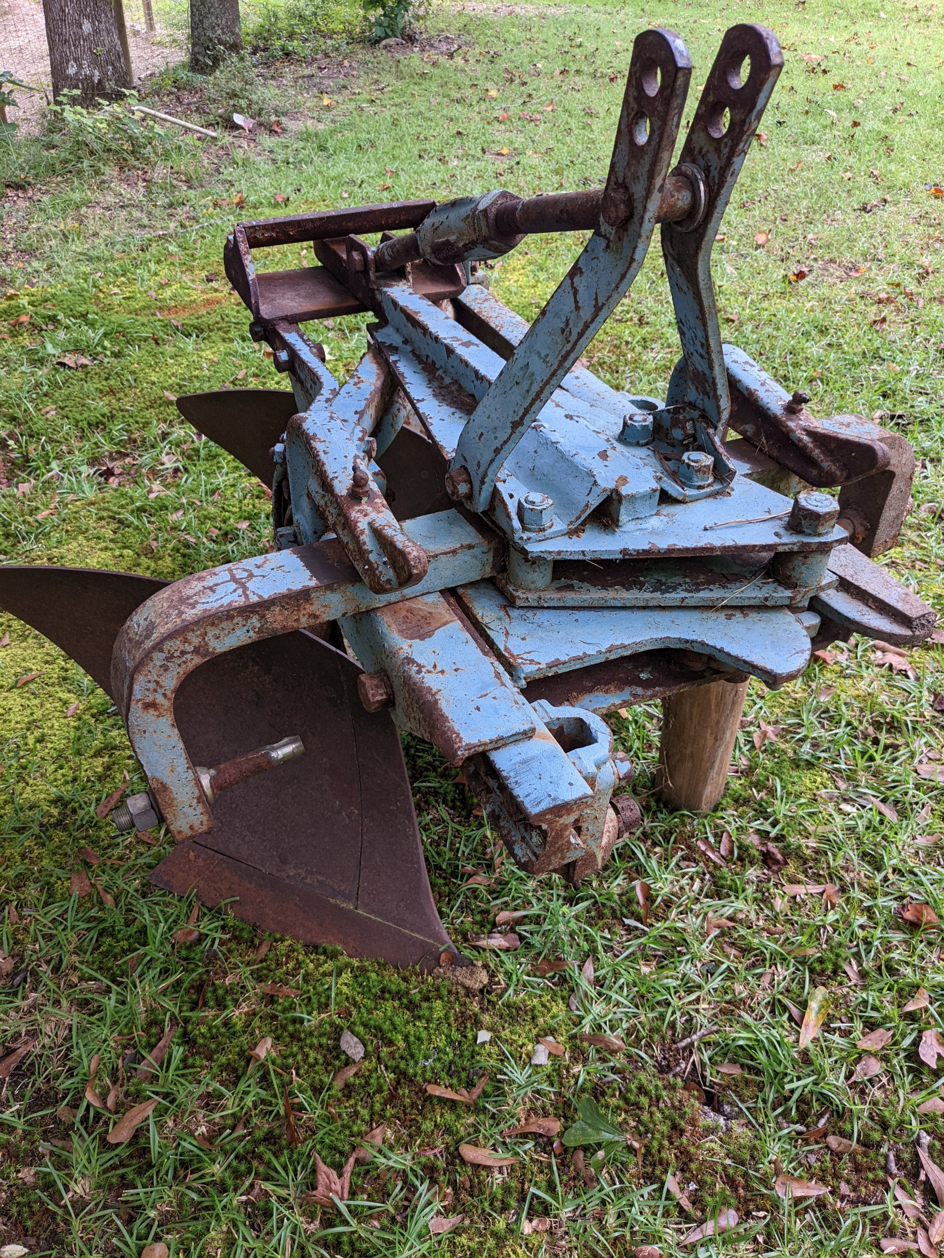

Not sure if the blue is original or not

Looks like an old case BAR plow... BER plow I mean:)
   / 2 Bottom Moldboard What kind? Model? #4
That is a Case BER plow with the Eagle Hitch that somebody changed the lift pins on, the original lift pins looked a lot like quick hitch lift pins. It would have been orange from the factory.
I have the successor model plow to that one, a 3-14 MRB, that came from the factory as a normal 3 point plow. We also had a 4-16 MTA (semi-mount) growing up. You can still get shins and shares for the plow if it's an EX bottom plow but they are getting a little bit more obscure than they were a few decades ago, where you could just walk into a farm store and get wear parts.
