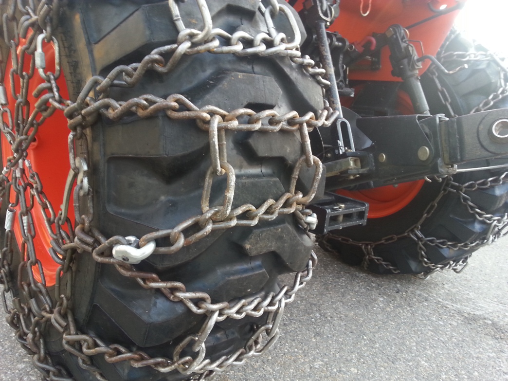

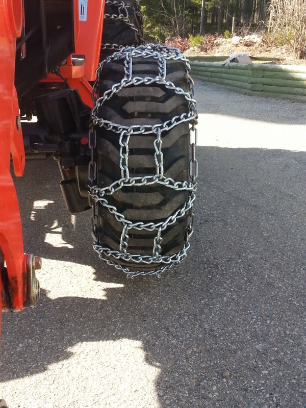

Fallon, my DK35SE has 27x10.5-15 R4 front tires to your 27x8.5-15. I bought non-v-bar H-patterns like you are considering:
I fitted them last year after getting spacers but have not used them yet. However I am sure they will work well.

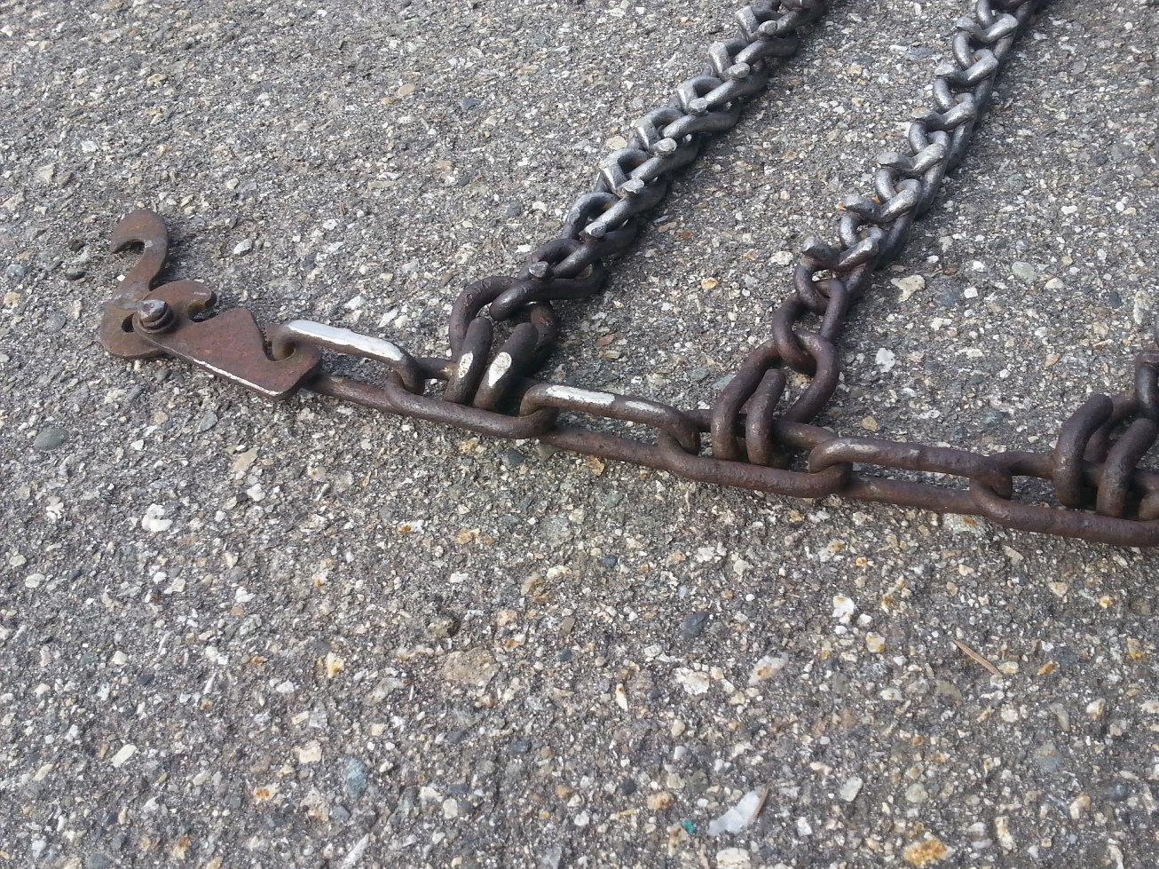

I previously had old 2-link ladder v-bars on the front and they did a great job. I changed them because I had clearance problems (and added spacers) and because they are quite worn out:
The shiny sections are from hitting the front wheel assembly and the welds on some cross chain links were starting to separate.
Either H-pattern or ladders should work fine for you. In addition to being cheaper, 2-link ladders would be easier to fit. Something I found that made fitting chain easier is the pin couplers (instead of screw links) as seen in the 2nd and 3rd photos.
I have front and rear chains mounted all winter but don't use 4-wheel drive unless I need it. The front chains help for steering even if not in 4WD.
