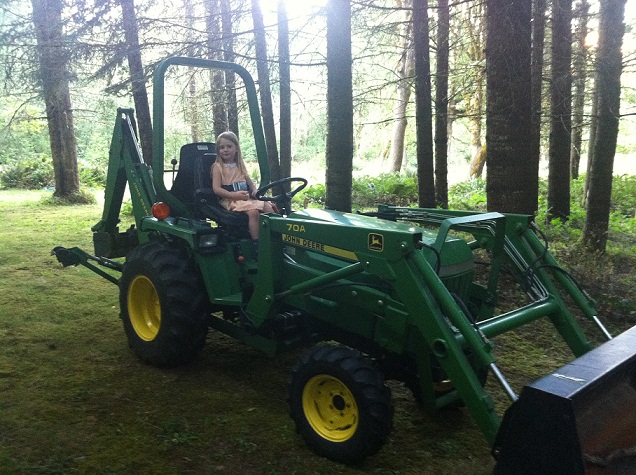

Here's a picture of my assistant sitting on my new little mule...
