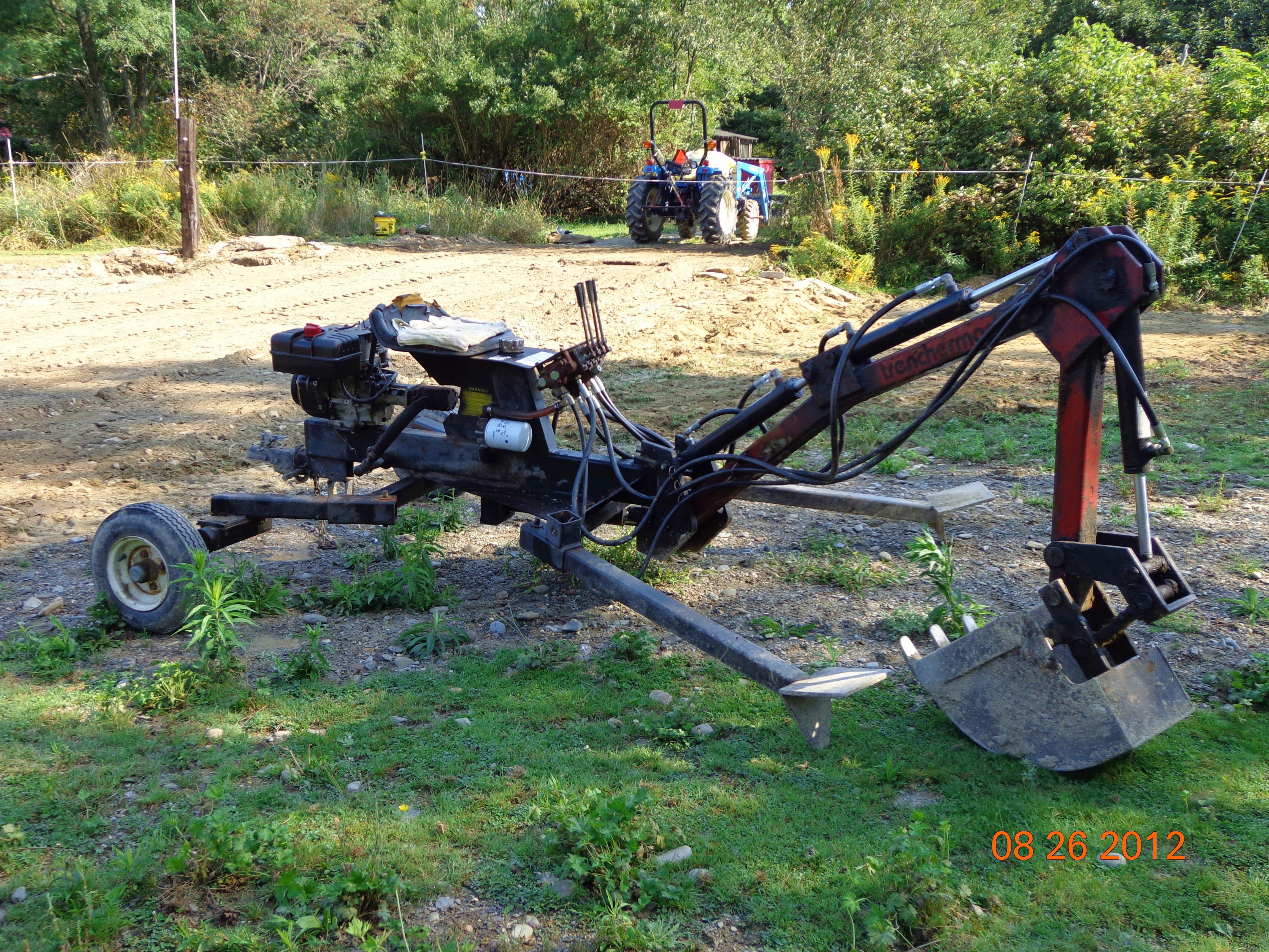

With the right setup, you can do a lot more with a 16hp engine and a high low pump setup than you might think but there is a compromise. The 28gpm 2 stage pump only rated for about 900psi at full flow. Then it drops down to about 8gpm@3000psi. I aint going to do all the math, but using 2 single stage pumps with a unloading valve would allow the use of up 12gpm@2000psi, which should be enough flow and pressure to run a hyd chainsaw with one pump and set the other pump at 8gpm@3000psi for high pressure for the splitter and with the combined flow still have 20gpm for high speed. The compromise is you only have 20gpm at low presssure instead of 28gpm with the two stage pump. The advantage is you are able to pump enough oil at a decent pressure range to run a hyd chainsaw. The 12 gpm@2000psi will get you in the ballpark using one of these motors, .7 cu in Parker MGG2:(-BB1B3 Hydraulic Motor | Parker | Brands | www.surpluscenter.com, which personally I think would be the minimum size motor I would use for a hyd chainsaw. Going with a 20hp or larger gas engine would allow for a better motor as well as bigger pump choices. A 25hp engine will get you in the 18gpm@2000psi for a chainsaw motor and would allow you to use a 1.2 cu.in axial piston motor and make about 23hp of chainsaw. Throw a big 14pin sprocket on the saw motor, a ,404 chain and cut with the big boys. You would also be able to run a 18/12 double pump setup and potentialy have 30gpm of oil to split with. Anyways, just a few thinks to think about.
   / 2 stage pump question #18
I bought a mini backhoe a while back with a 6hp engine. It was slow. I swapped out the 6hp for an 8 hp tecumseh. The original pump was a 1.2 GPM single stage. I swapped that out with a 11 GPM two stage. Just moving the bucket around into position was faster and when it came to digging it dropped down to 1.5 GPM. I was pleased with the outcome. Much faster. Plenty of power. Bought it new and it has done a lot of digging, Frostline is 4-5 feet - done well.
