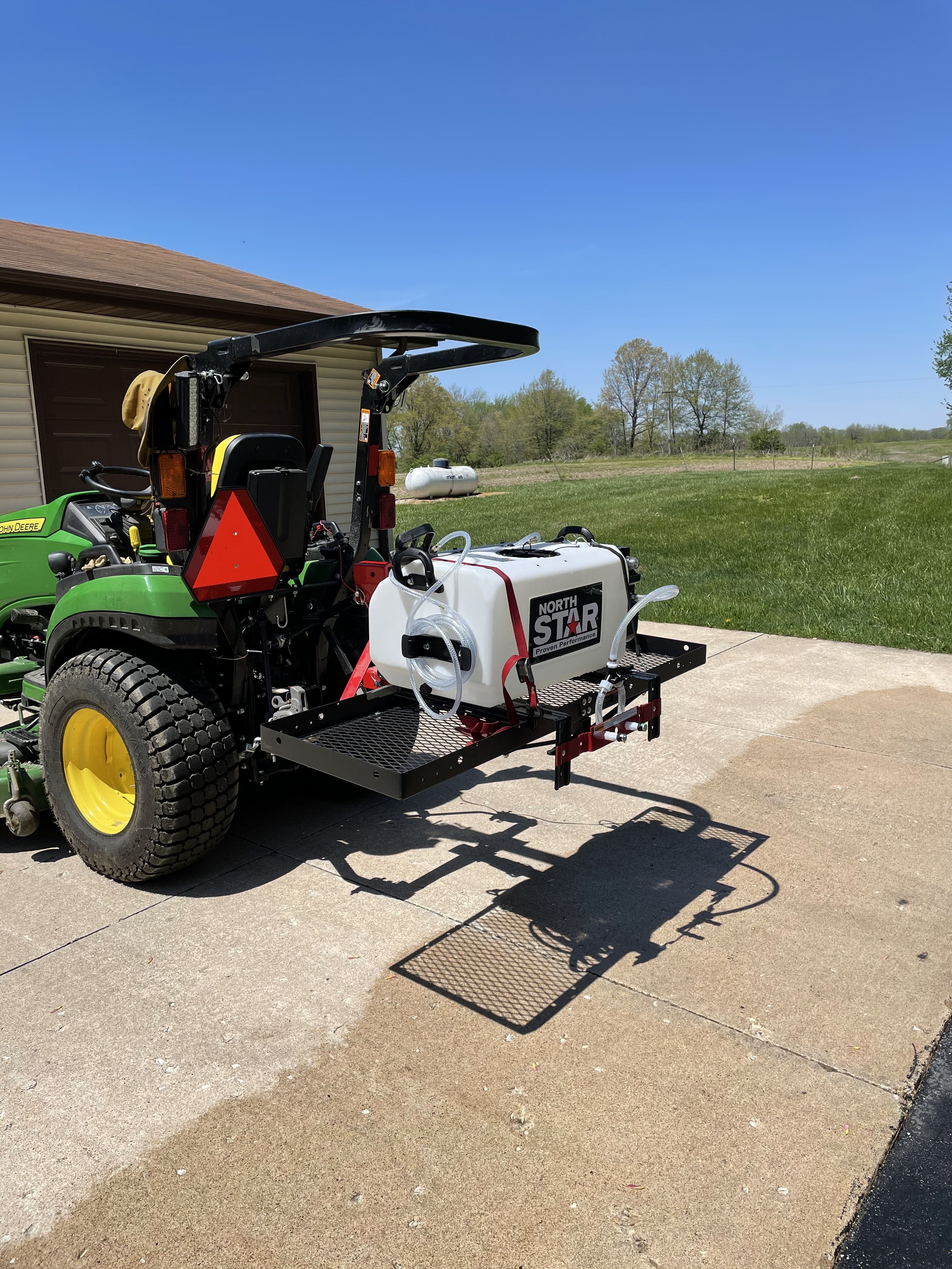

I have a northern tool sprayer, it has a pair of broadcast sprayer nozzles and a spray wand. It works pretty good after I fixed a couple of leaks. I set it on a cheap carry all on my 3 point but it’s not really a 3 point sprayer.

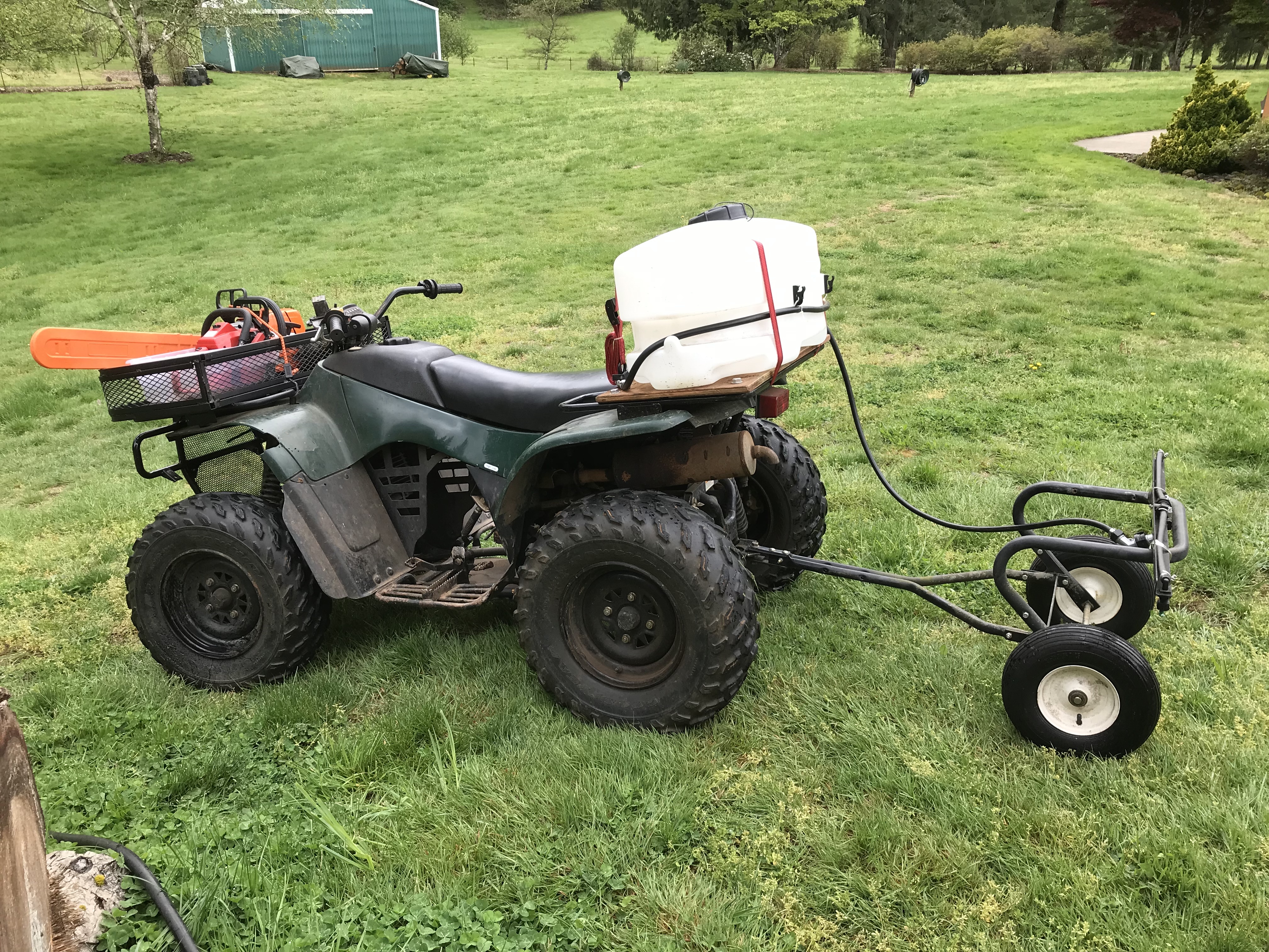

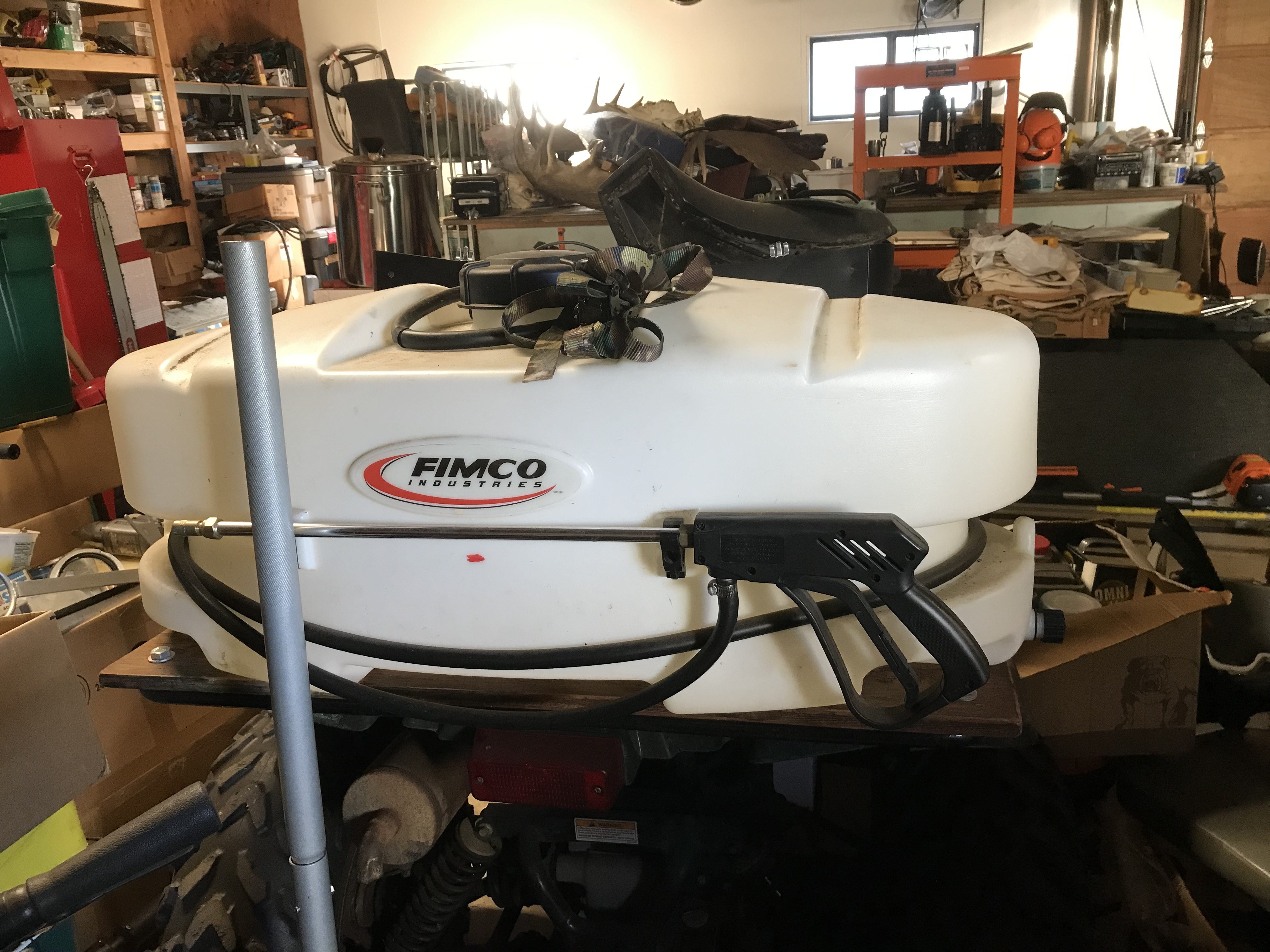

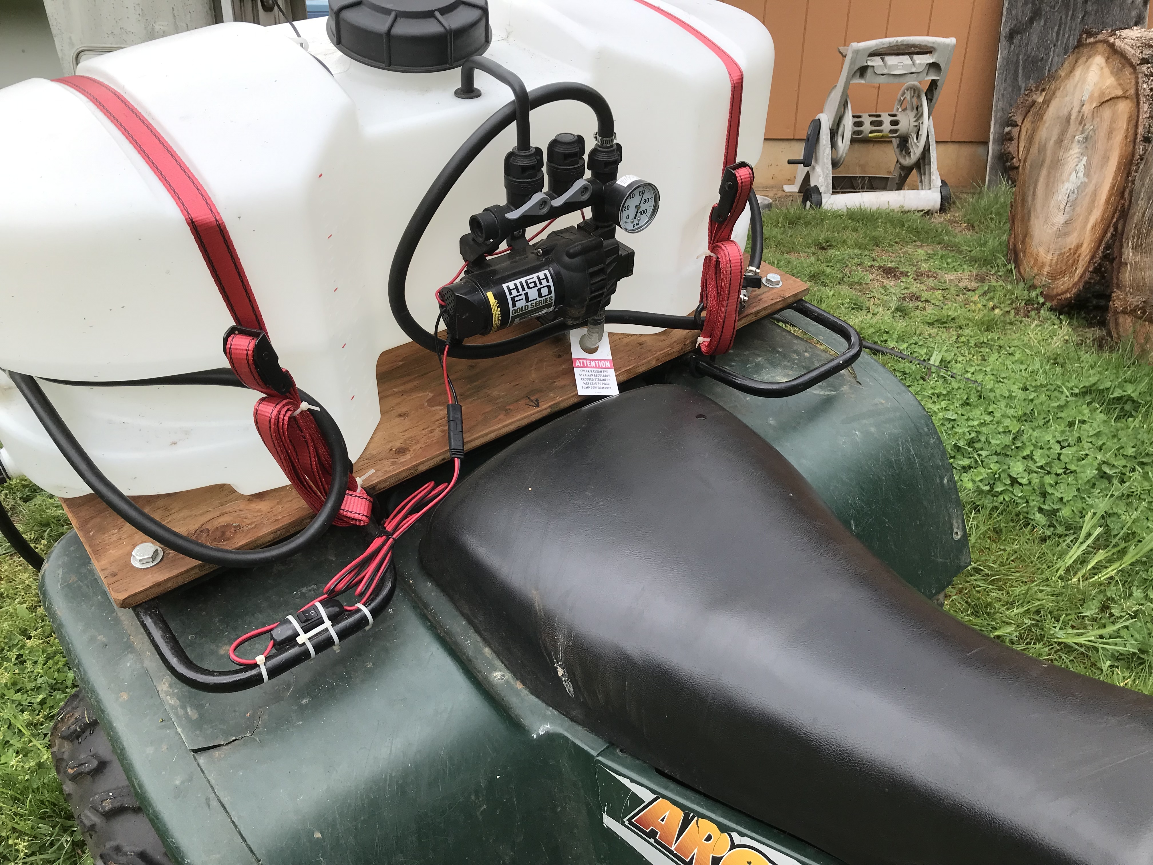

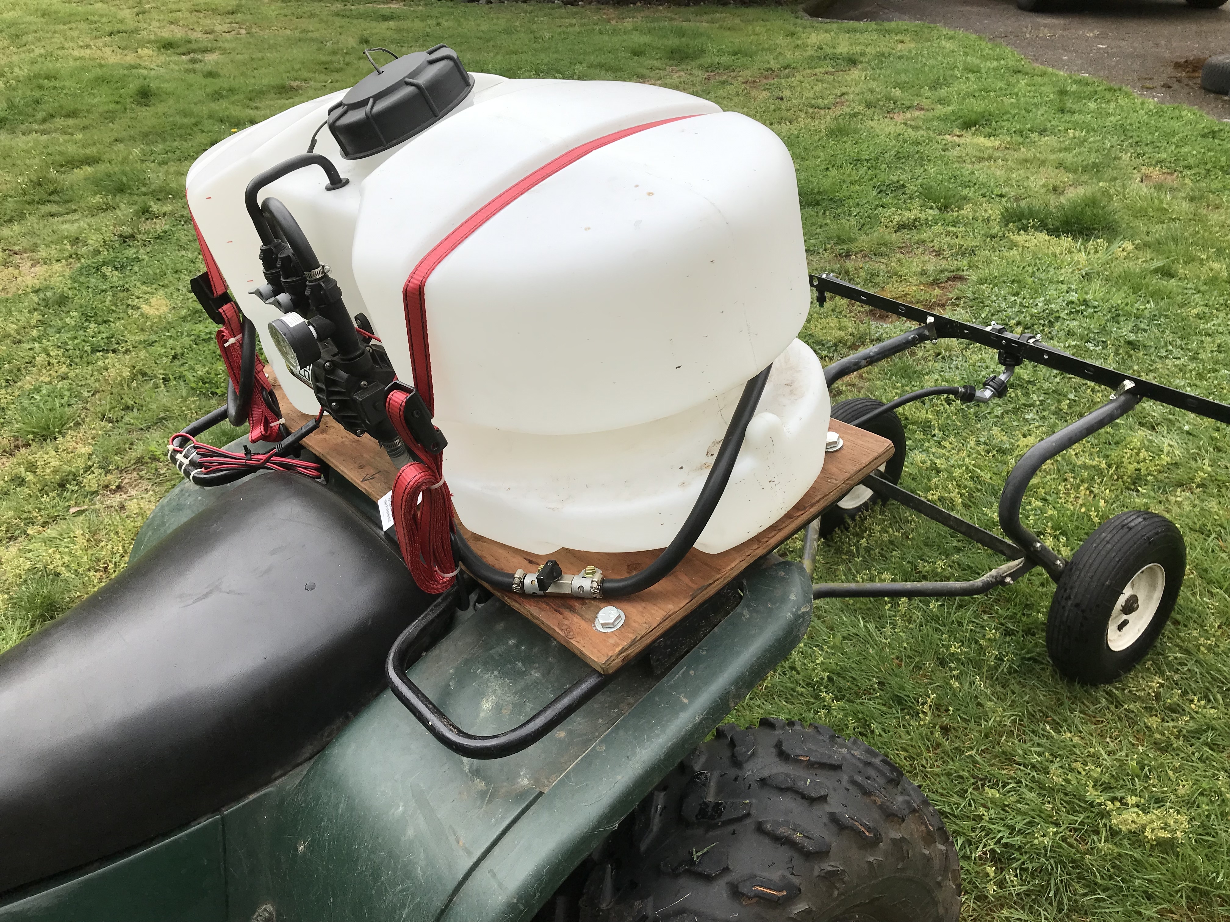

I have been using FIMCO 25 gallon sprayer, sometimes with handheld nozzle and at times with simple Chapin boom sprayer setup on wheels (leftover from busted fertilizer spreader).
Spare parts are available from FIMCO if or when needed.
It's been a pretty good setup for many years of use.
FIMCO Industries

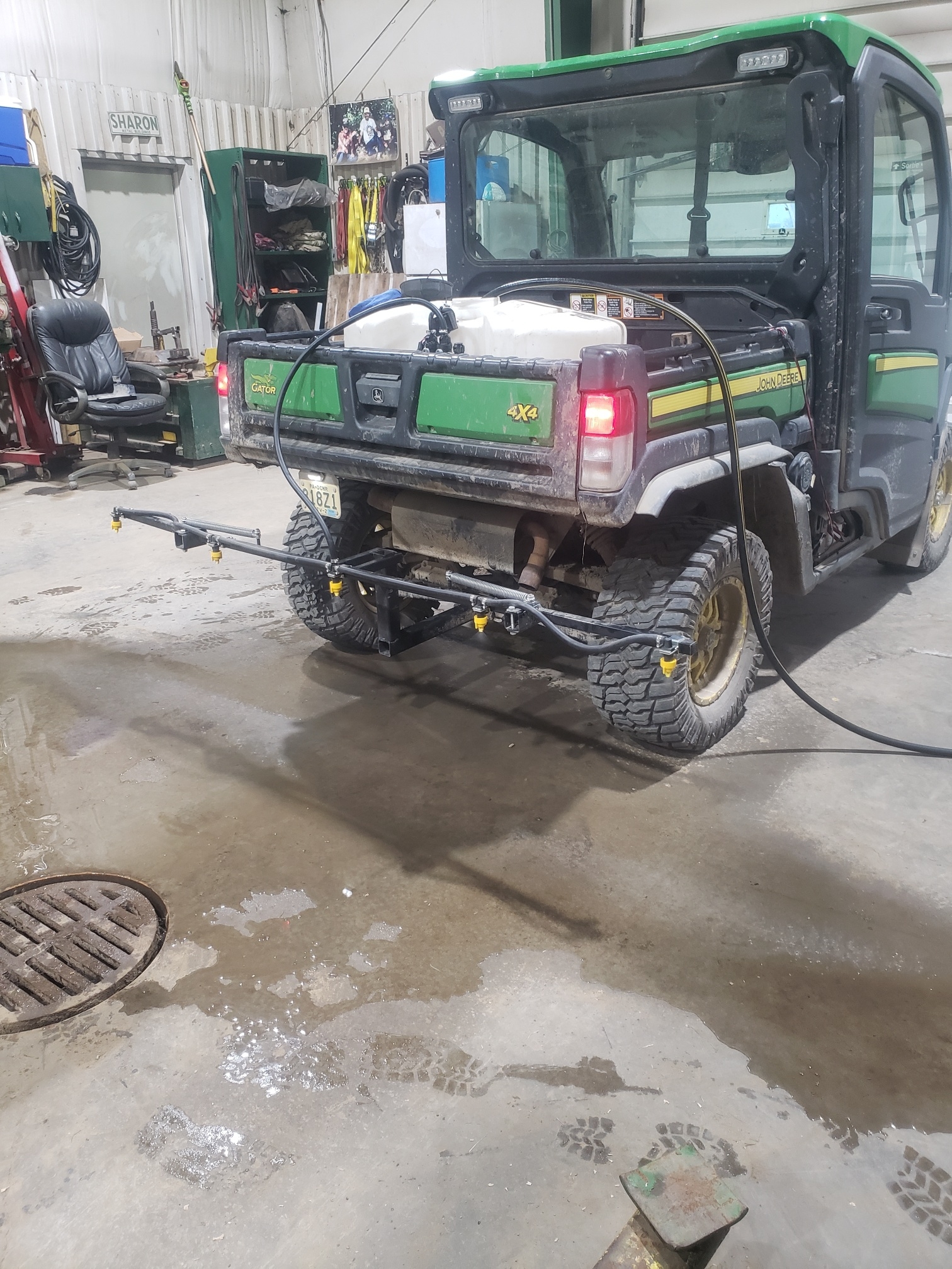

I had a FIMCO 25 gallon sprayer for probably 20 years, doing hand spraying of Roundup, 2.1 GPM pump. Last year I purchased a spray bar and mounted it on my Gator. It was a 7 nozzle spray / FIMCO/ bar that I cut off the 2 outside nozzles because of clearances. I also purchased a 4.5 GPM pump/ FIMCO/ last year. The pump had a pinched o ring that I did not discover until this year so I had to purchase 2 $20 items to fix it. Now it works as intended. I do the 24D on my yard, approx 2.5 acres, and also a relatives yard of about the same size. I can't find my pump order but here is the Amazon link. I think I ordered it directly from FIMCO last year because of delivery times although now it is much more expensive than Amazon and Amazon has good delivery times now.
Amazon.com : FIMCO 5151088 High Flo 12Volt Demand Diaphragm Pump (Upgrade), 4.5GPM, 60PSI, Can Use with Roundup : Patio, Lawn & Garden
I also added the FIMCO remote control, it a nice option when I am inside the cab. I pickup the 12V from under the side panel on the passenger side.
This is the only picture I have of the set up. I was filling the tank with water just to check the nozzles before spraying.

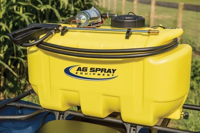

I had a fimco farm&fleet 25gal sprayer, with a hiflo pump and broadcast spray boom. In the middle of the 4th tank, the pump came apart, and the valve assembly broke off of the pump. The highflo pump has plastic engaging screws holding two plastic housings together. They would not hold. Also the valve assembly has a bayonet type quick tach feature attaching it to the pump, that also would not hold together. Basically the two most expensive parts were irreparable and laid in pcs. I researched and came up with Agsprayer 25gal as an alternative, their so called platinum model. A little more money, but the difference was stark. High quality shurflo pump, easy and quick access filter, npt fittings attaching the valve assembly vs the other plastic clip on type, quality fluid filled gauge vs cheaper mechanical type. One thing I noticed though, is to not only clean it good after using, but more important disconnect the wand and boom hose and spray some silicone into the ball valve to keep it moving smoothly (I use dielectric grease). There's a chance we have water here that is hard or with minerals, whatever, and it tends to seize the ball valves. Our garden hoses etc suffer the same, so it's not just the sprayer. The sprayer has plastic ball valve handles and can break if torqued too much. Another note, is that Agsprayer is Fimco's commercial agricultural brand. I've used this second sprayer 5yrs, 20-25times with no issues.
   / 20-25 gallon sprayer recommendations #17
Ag Spray certainly looks like a step up from consumer or homeowner sprayers.
