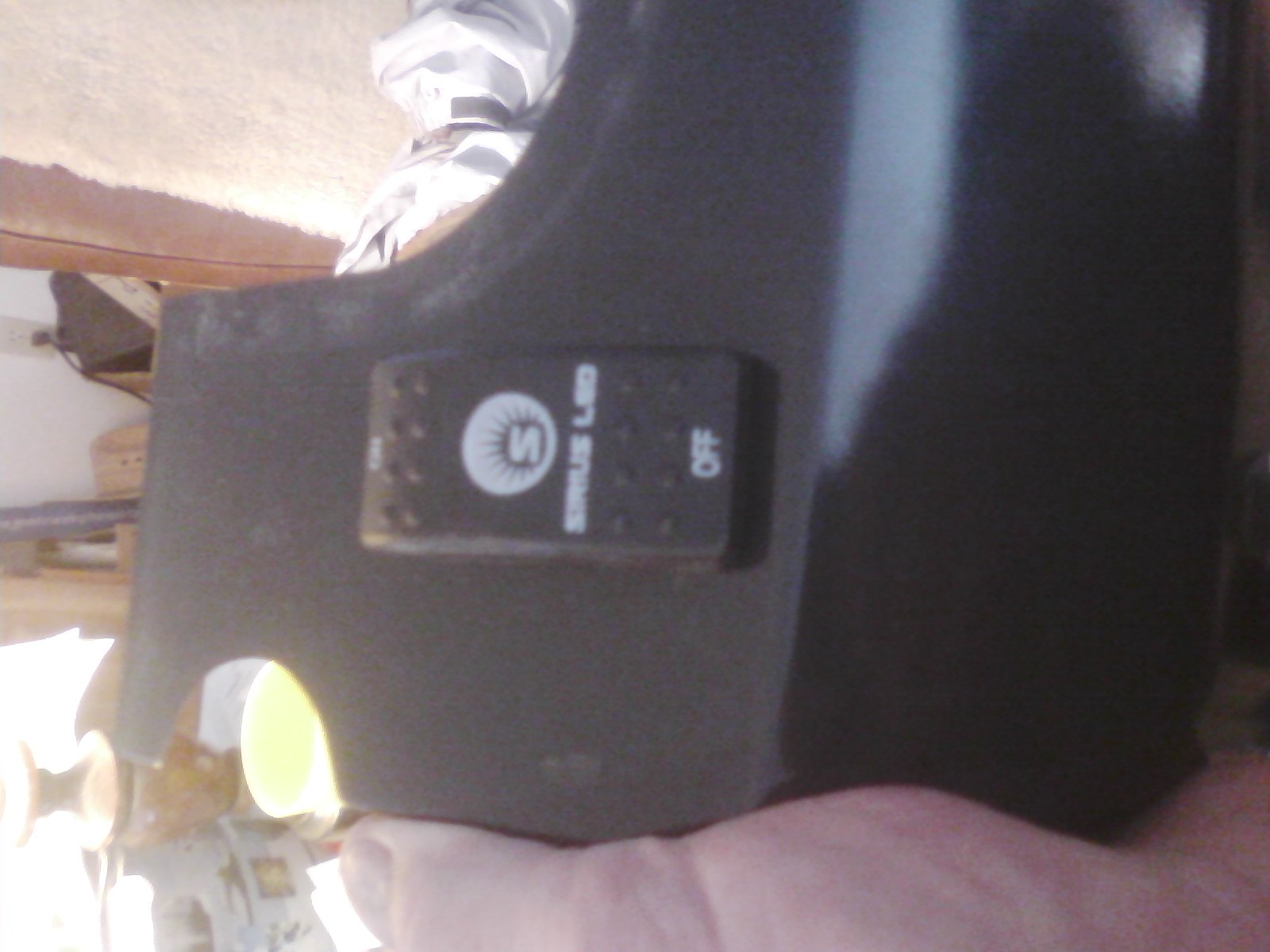

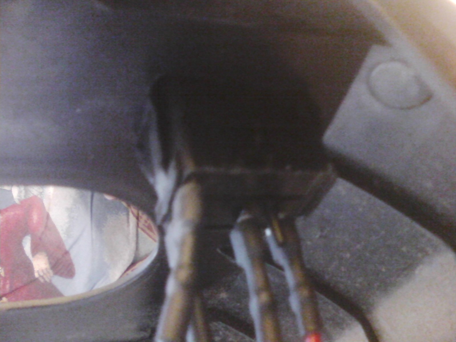

First thing I did measure up the included wiring harness, taping it to the tractor to determine where everything would fit. The harness comes with a plug to the light bar, about 8' of wire to a relay that is connected to the dash switch I selected. It is also connected to the power wires that has a fuse in line. both of those wire runs are about 3'. Once I determined everything would fit I started by putting the dash switch in. My tractor has a center cover which is plastic. I pulled it and checked for clearance. For my switch I needed about 3". I used the template you can find on the motoalliance site. Dremel tool made quick work. Note - cut inside the template first then widen. The switch does not have much of a face plate to hid any mistakes, so be careful.
First picture is of the switch in the dash. Second is of the tools and third is the backside of the dash with the switch clips in place.

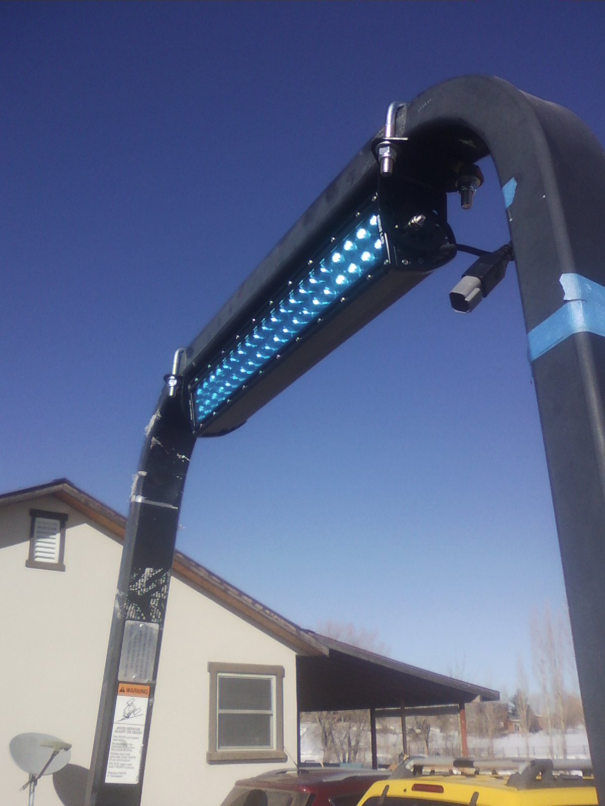

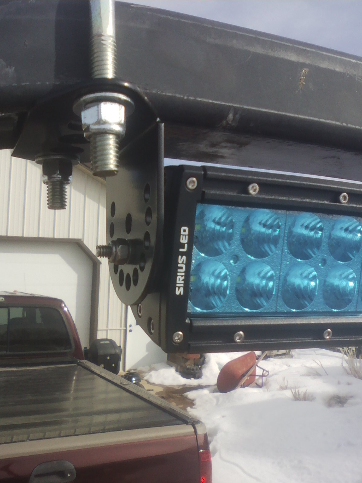

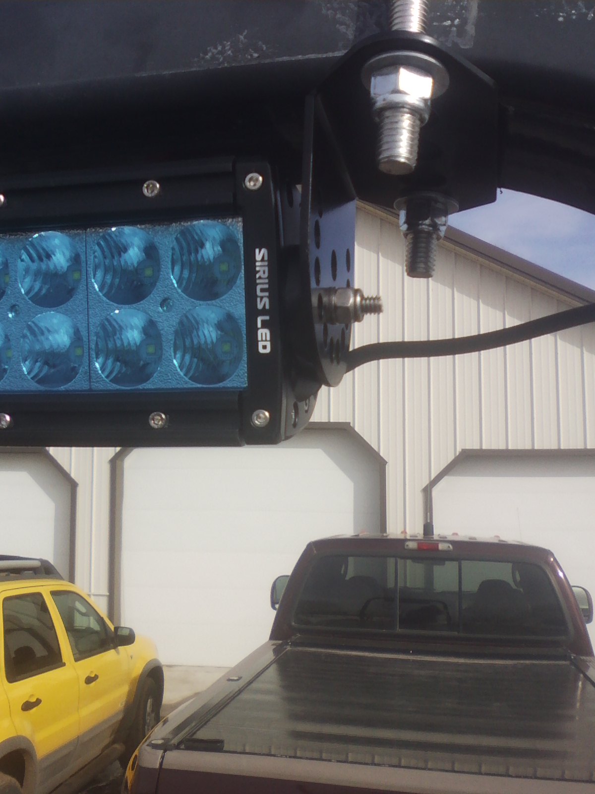

Then on to mounting the light bar. This is straight forward using the mounting kit. Keep in mind where your running your wiring harness and orientate the light bar accordingly. This was a two person job for me so as not to drop the light bar. :eek: Boss unit helped.

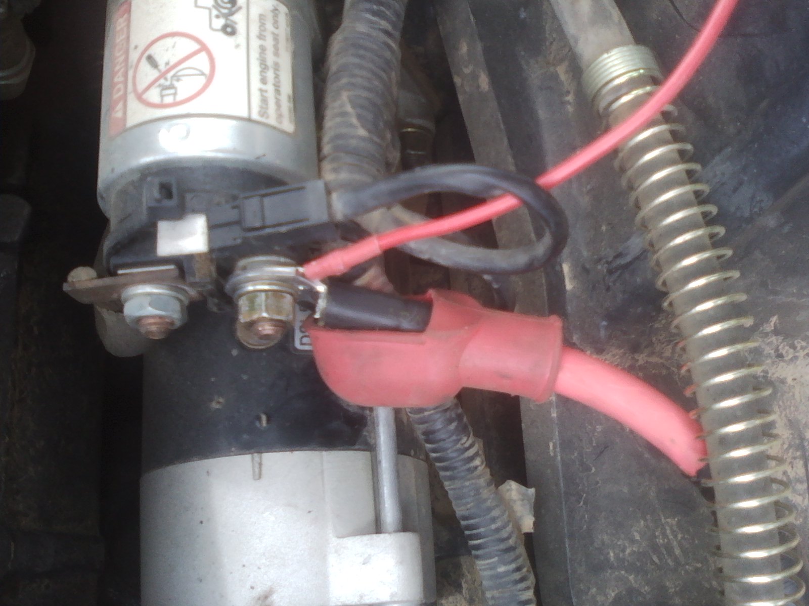

Next up was running the harness and finding spots for everything. I mounted the relay next to a floor mount and secured with a zip tie. then ran wires for and aft to the light and power. I took the power off of the starter. Fuse is tucked up under the floor board too. I found a good ground screw under the floor too, so everything is in place.

Also the supplied mounts will work - I was lazy and not wanting to drill and tap the ROPS. If I had to do over, I would probably take the time to drill and tap the ROPS and used the supplied mounts and hardware.
