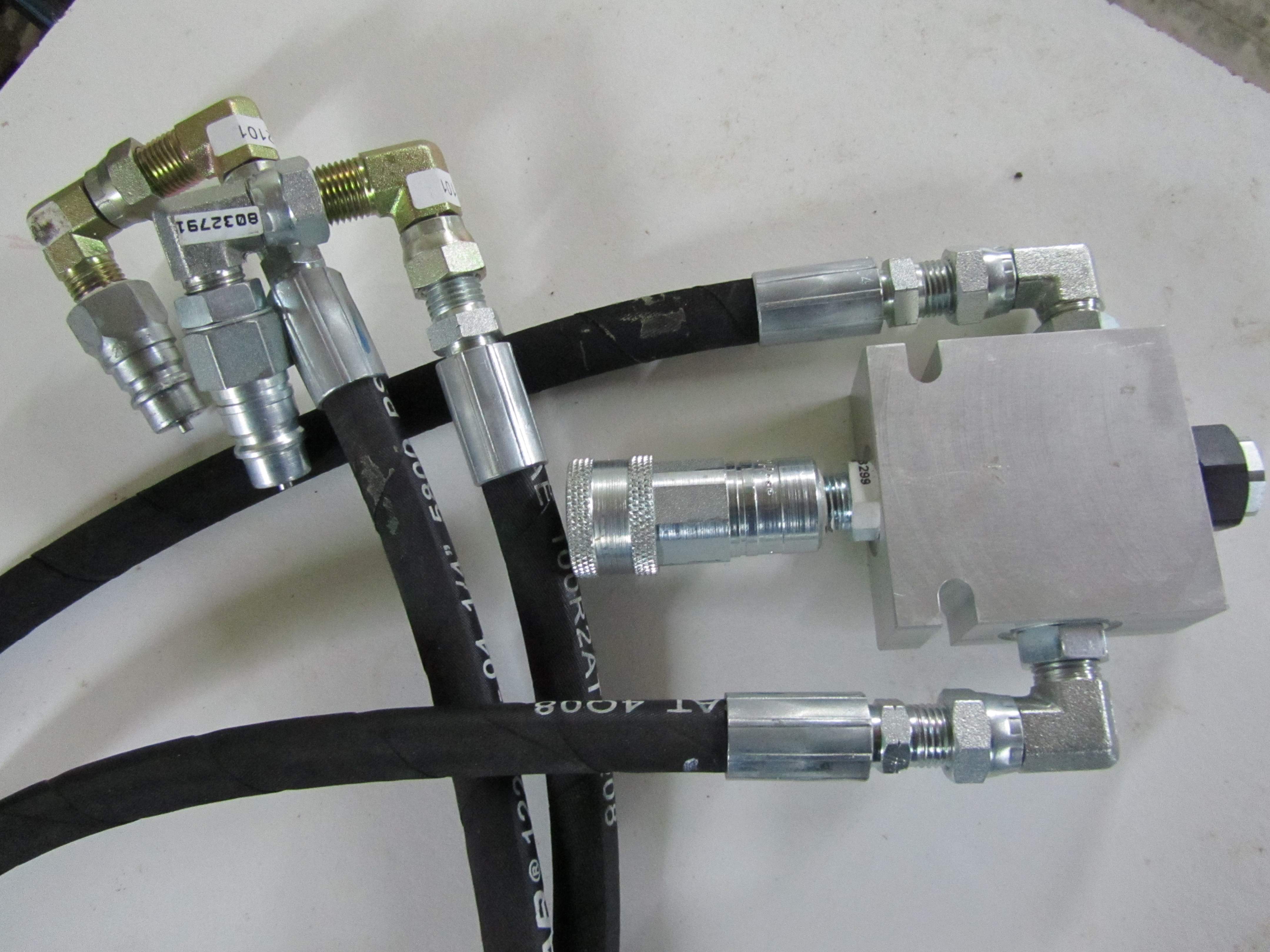

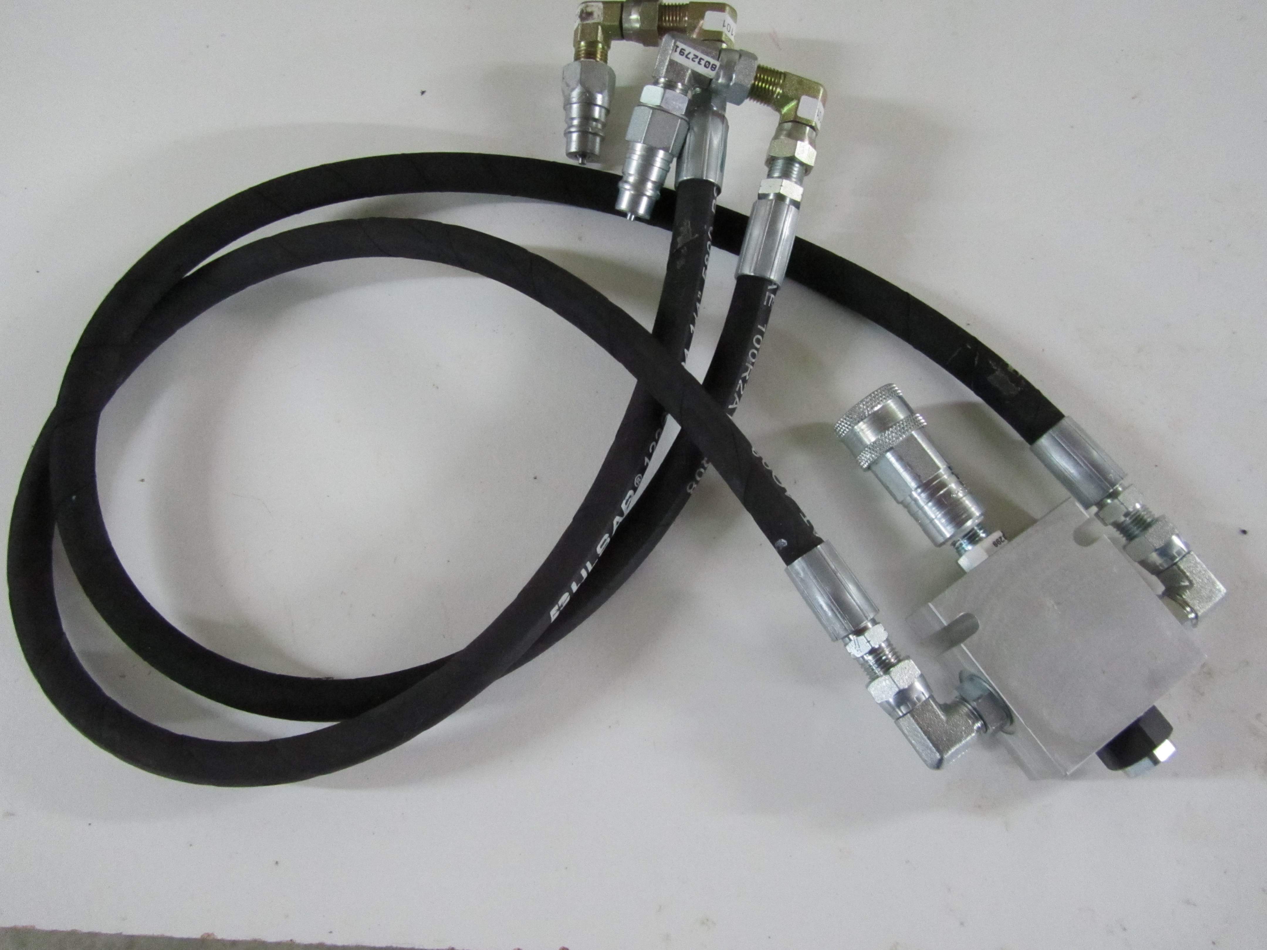

Hey guys,
I bought a 2305 last spring mainly for mowing and light 3 point stuff. I bought it knowing about the fan/ filter being vulnerable, lack of position control, and some other minor annoying things, but as it turns out only one thing drives me crazy;:mad: the deck leaking down in a few minutes. Other than that this little tractor has blown me away with how much it can do.
Back to the leakdown solution, I noticed on my 5M that if I left the loader up a little bit that it would stay that way indefinitely. This got me thinking about PO checks because I realized some or all of the 5000s (at least the 5Ms) have excellent load holding checks in their SCVs.
Here is what I came up with: a one way POCV. I just plugged the deck hose into the female coupler and the two hoses from the valve into the mid SCV and voila, the deck didn't leak down after several hours. The only negative thing so far is the engine has to be running to lower the deck (to get the pressure signal to release the valve). This could be fixed with a needle valve bypass but this adds expense. I got everything at Princess Auto for about 120 bucks. The valve was $75, hoses $4 each off the clearance shelf, and fittings were the rest.
Regards,
Tom
