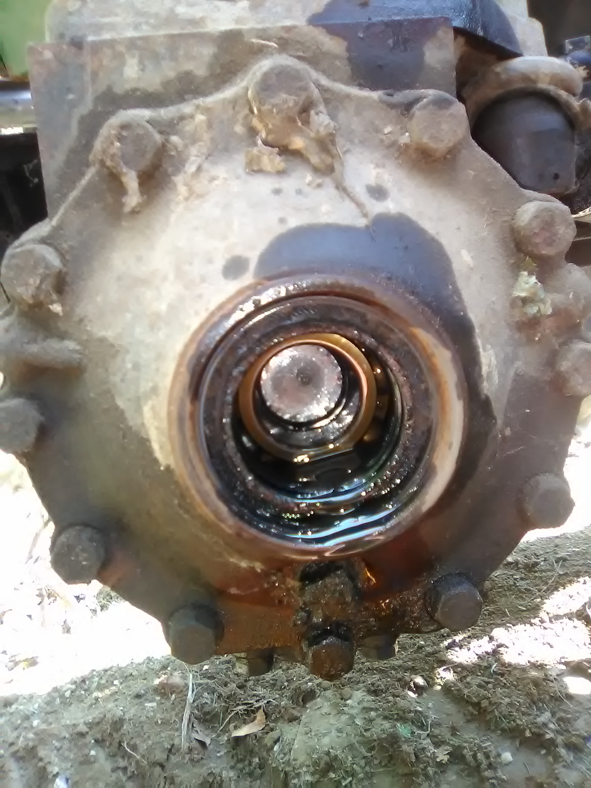

Looking for someone to help me with getting the parts I need to fix please

Tommy at affordable tractor might be able to help. Not sure of the origin of the avenger, but he may be able to help. Looks a lot like my jinma, and been there-done that...

I allso had it and the new axle came without the securinggroove. Had to cut one
   / 2002 35 hp avenger broken front axle #6
From your picture, the as le look like the one on my Foton that break last year. There is a desing flaw on these. The locking groove is between the crown and the other bearing, so on the week side. The newer one comes with the groove on the end of splines near the inner bearing. This design is better as I understand and worthit. The bad thing I had to order a new crown to fit in the tractor hub that cost around $300 each side for those kits.
Don't forget to order gasket shims to be sure to have sone back lash between gears when reassembly. New seals too as by the time you are there, won't cost much to prevent possible leak soon.
Good luck.
Jacques

Thanks for the info, you remember where you got the parts
   / 2002 35 hp avenger broken front axle #8
Asian Tractor Parts, in Ontario Canada.
For me it was easier as I live in the next province (Quebec) and maybe save (?) on duty fees.
