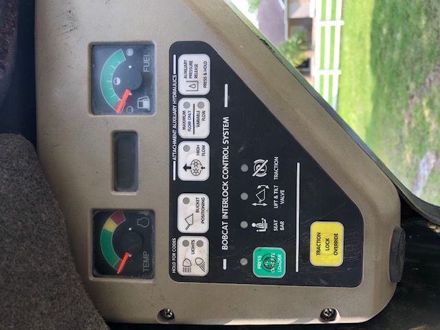

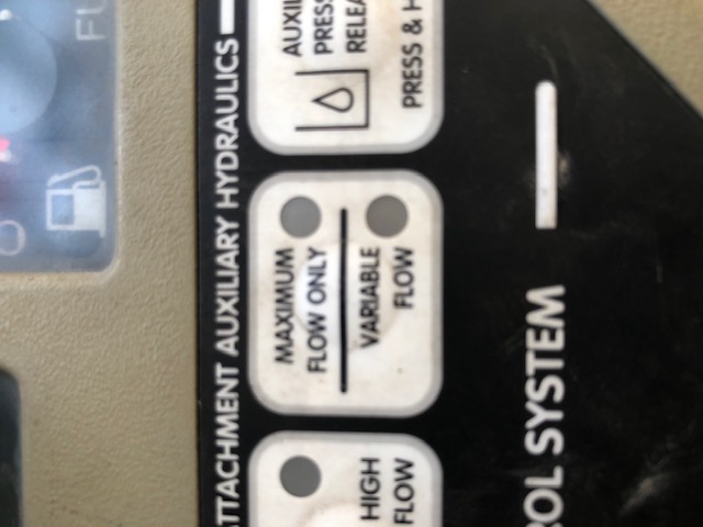

Hello, I have a 2002 753 machine I had it in for repairs on the auxiliary hydraulics and they found a bad controller, all fixed. I worked the machine all day yesterday with no issues, came home to unload it and I cannot get the green lights to come on to activate the variable flow or Maximum flow hydraulics on the dash Any suggestions? Can the switch be replaced in the left side dash or is it a complete unit? I did not see a bad fuse, there is one marked "attachments" I am guessing that would be the one. When this button is pushed is it turning on a separate pump or just sending power thru the computer?
Sorry the pictures are sideways!

Switch is part of left panel not replaceable as separate part and feeds an input to controller to send power to handle buttons.

OK thank you, have you ever heard of just this button/switch going bad? I just had the controller replaced so I would like to think that it has not gone bad already, possible but I hope not.
   / 2002 Bobcat 753 auxiliary Hydraulics #4
Anything can happen, but since controller was just replaced I would carefully unplug each of the controller and look at each pin connection. Possible one or more of the pins were bent and is slid along side its female connection, or locking clip of the female side in the plug is loose and connection is sliding back in the harness plug.
Can also check connections of the left panel without removing it by the headlight.
