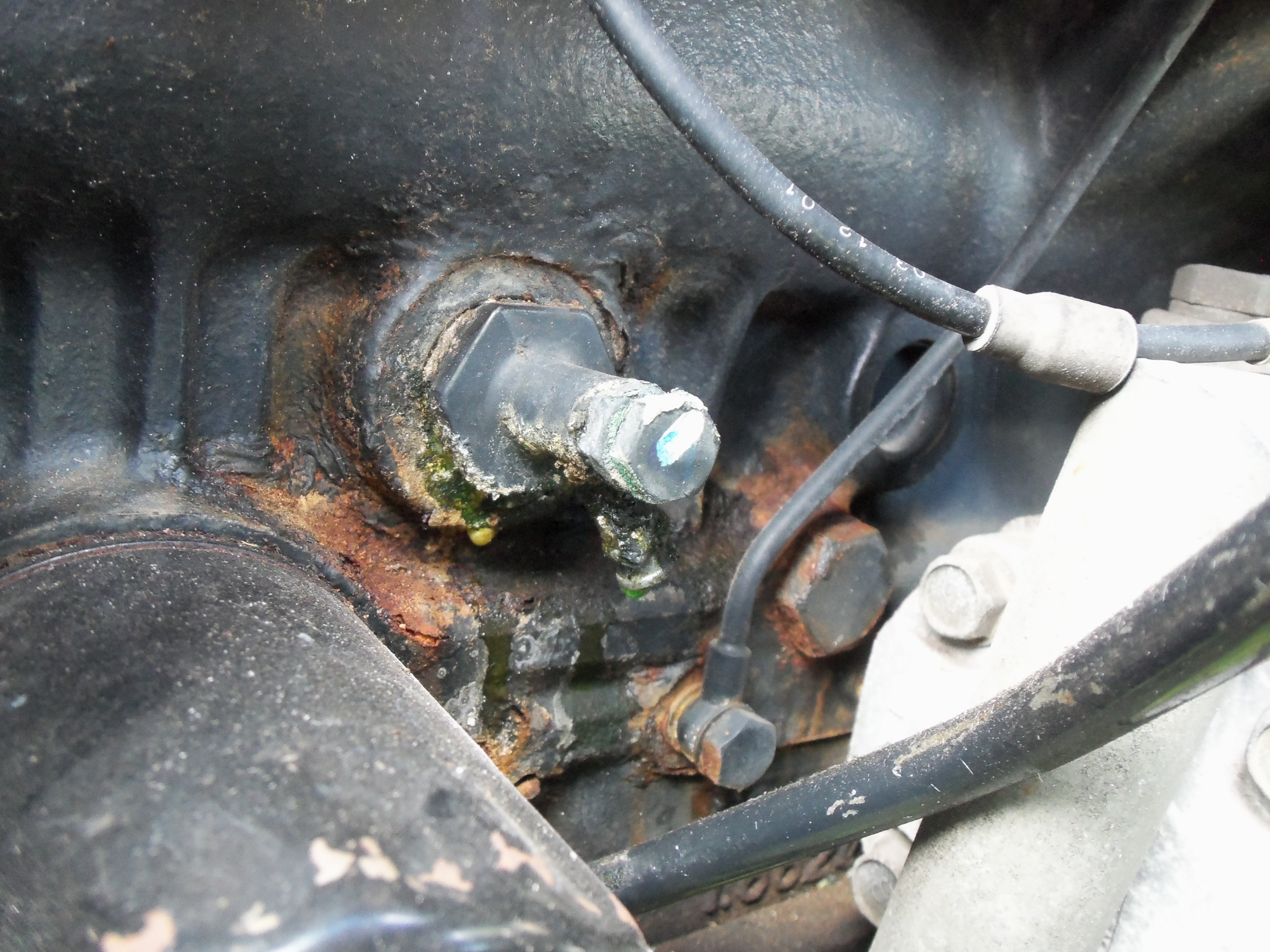

Hello all,
Hoping you can help me out.
There is a blue tube that runs adjacent to the fuel overflow drain tube and valve vent tube that I can't identify. Looked at quite a few diagrams and no luck.
This blue tube terminates into the block behind the fuel filter via a 90 degree fitting.
The reason I ask is that I am dealing with an issue with coolant dripping from this line.

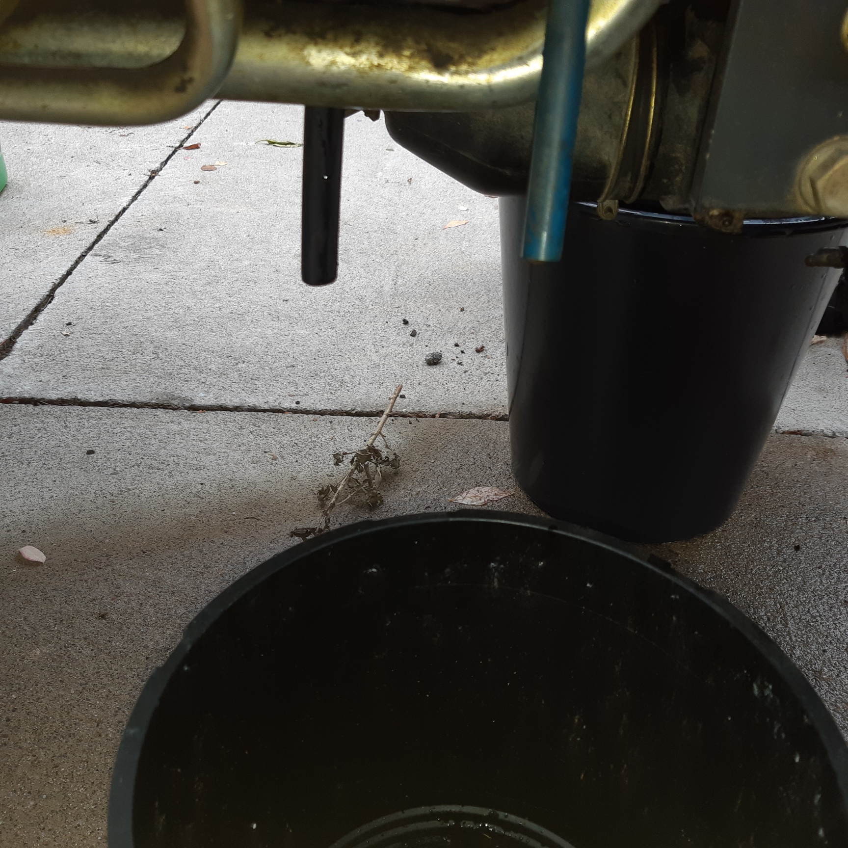

Thanks for your reply..... the 2nd pic illustrates the tube at its bottom.... the 1st pic illustrates where it is connected to the block behind the fuel filter. Sorry for the bad quality but pretty crowded area of the tractor. Did look at manuals sourced online but could not find or id this tube..... thanks for your interest and cheers,
   / 2003 TC30 Shibaura Motor - Trying to ID BLUE tube #4
Looks like it's just the crankcase breather pipe. Definitely shouldn't have coolant coming from it though.

The hose with the coolant leak in the first pic is the engine block coolant drain hose. It connects to a drain fitting bolted on the right front side of the front axle support. That drain fitting also accepts a similar hose connected to the bottom radiator tank. The common drain fitting allows complete draining of the cooling system at a single point. Your leak is either from the hose/nipple connection at the engine block or from the threads where the block fitting is screwed into the block. The tapered thread connection between the block and fitting is a common leak point. Shibaura was very stingy with three sealant at that spot.
The two hoses in the second photo are the fuel filler neck drain tube and the crankcase vent tube. Coolant dripping from either of these tubes is probably running down the OUTSIDE of the tube from the coolant leak identified in photo 1.

btw, agree that it's as likely leaking at the installation (o-ring?) and running down the outside of the tube.
