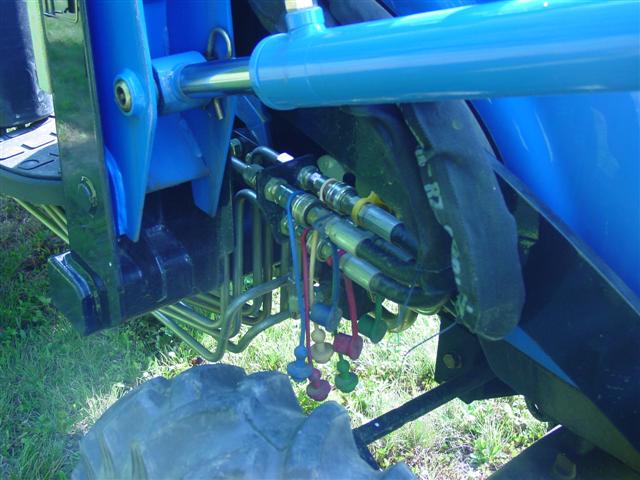

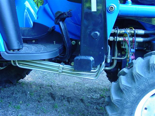

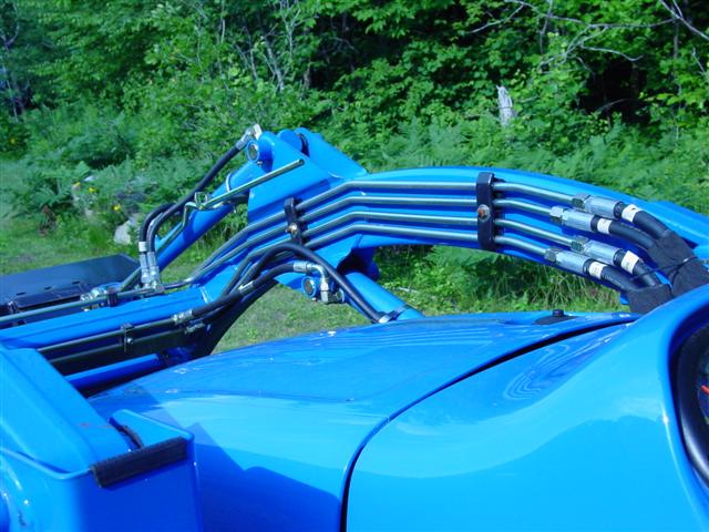

Well, she's either a 2004 or 2005. Anyway, the Bush Hog #2246QT loader I have has been seeing some issues. Extremely slow to lift, lower, curl, dump. Fluids are fine, filters just changed, and still the same.
So, I was curious as to if the 14LA will work on my 29D. Again, bought her in 2005 with 1.2 hours on her so she's either a 2004 or 2005.
AND, if someone out there has a "D" series with a newer "LA" loader on it, e-mail me a few pictures in regards as to how it looks overall and the routing of the hoses. I've read on the DA series, people aren't happy with it rubbing on the blue painted parts but the older D series it would be on the black panels. Not that that's ok - I mean, I DO wash and wax my tractors, er... toys!!

Glthorne:
Welcome to TBN and the Blue Forum :D! I did a brochure and internet search last evening about the compatibility of a TC29D and 14LA without much success as NH has upgraded and renamed its FEL's. I believe that the only difference between the TC D and the DA series is the "advanced" technology which included somewhat higher hydraulic capacity and some bells and whistles like breakaway hazard lights, cushioned seat, and some additional electronics, etc. I would assume that the 14LA would be compatible with the TC29D, but I would confirm that with a dealer if I was you. The 7308 is still made and is advertised as being compatible with the TC30 and "small CUT's". Good luck in your search :). The TC29DA meets my needs. Jay
PS: I will try to take some 14LA pictures for you after work tonight. My wife gets extremely jealous of the "TOY" as I take more pictures of it and my attachments than of her and/or anything breathing :rolleyes:.

Glthorne:
Some pictures :). You can see the black canvas-like material encasing the hydraulic ribber hoses at the edges of the pictures. They do minimize rubbing. Jay

   / 2004/2005 TC29D with 14LA Loader?
Thanks Jay. Looks like you've got them ran on the outside of the lower bracket thus not having the rubbing problem to begin with. Assume all operates very smoothlt that way opposed to the way most dealers run them - right up against all that pretty new blue!!!
In regards to the 14LA and supposedly front axel problems due to weight, the 14LA, 7308 and Bush Hog 2246QT all spec out around the same lift capacityies but break out force is CONSIDERABLY more for the 14LA. However, moving dirt and gravel, that shouldn't cause any problems!
