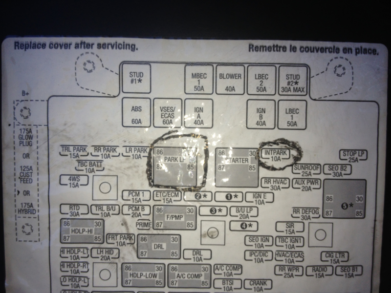

Today I am fiddling with my Dad's 2004 GMC 3500 Duramax. The marker/park/running lights (whatever you wish to call them) will not burn. The problem started when he took the center cluster of cab lights loose due to one bulb not burning, after he put it back together none of them work. We put a tester on them and we are not getting power to them. I can not seem to find a fuse for them, only the head lights and daytime running lamps. Does anyone know which one it is?

The engine compartment fuse panel is where you need to focus. There are three fuses (4 if you count the one running the trailer plug) and a relay. RR PARK, LR PARK, and FRT PARK all 10A micro fuses. Since none of the lights are working I'm wondering if something damaged the relay. You can swap the STARTER relay, which should be right next to the PARK LP relay, in it's place just to check. The micro fuses can be a bugger to pull out even with the fuse puller, especially if they're right next to something that makes it difficult to squeeze down on the puller. If the relay is bad you should be able to pick one up at an auto parts store, if not and all the fuses are good then we'll need to break out the multi-meter. GOOD LUCK!

Alright gentlemen, after reading the replies and looking some more I found the problem(s).
At first I switched the park lamp relay with the starter relay. That solved half the problem, the ones under the head lights came on but the ones on the roof still wouldn't work. I was stumped.
I looked at the chart again and saw a 10 amp labeled INTPARK. Yesterday when I read it I thought it had to due with the "park interlock", You knToday when I saw it I instantly thought "integrated park", aka cab lights.. I pulled it out and it was clearly blown. Switched it with another 10 amp and we have a winner.
All the lights will now work as they should, he just needs to get a new relay and 10 amp fuse. I really appreciate the responses here, thanks guys.
