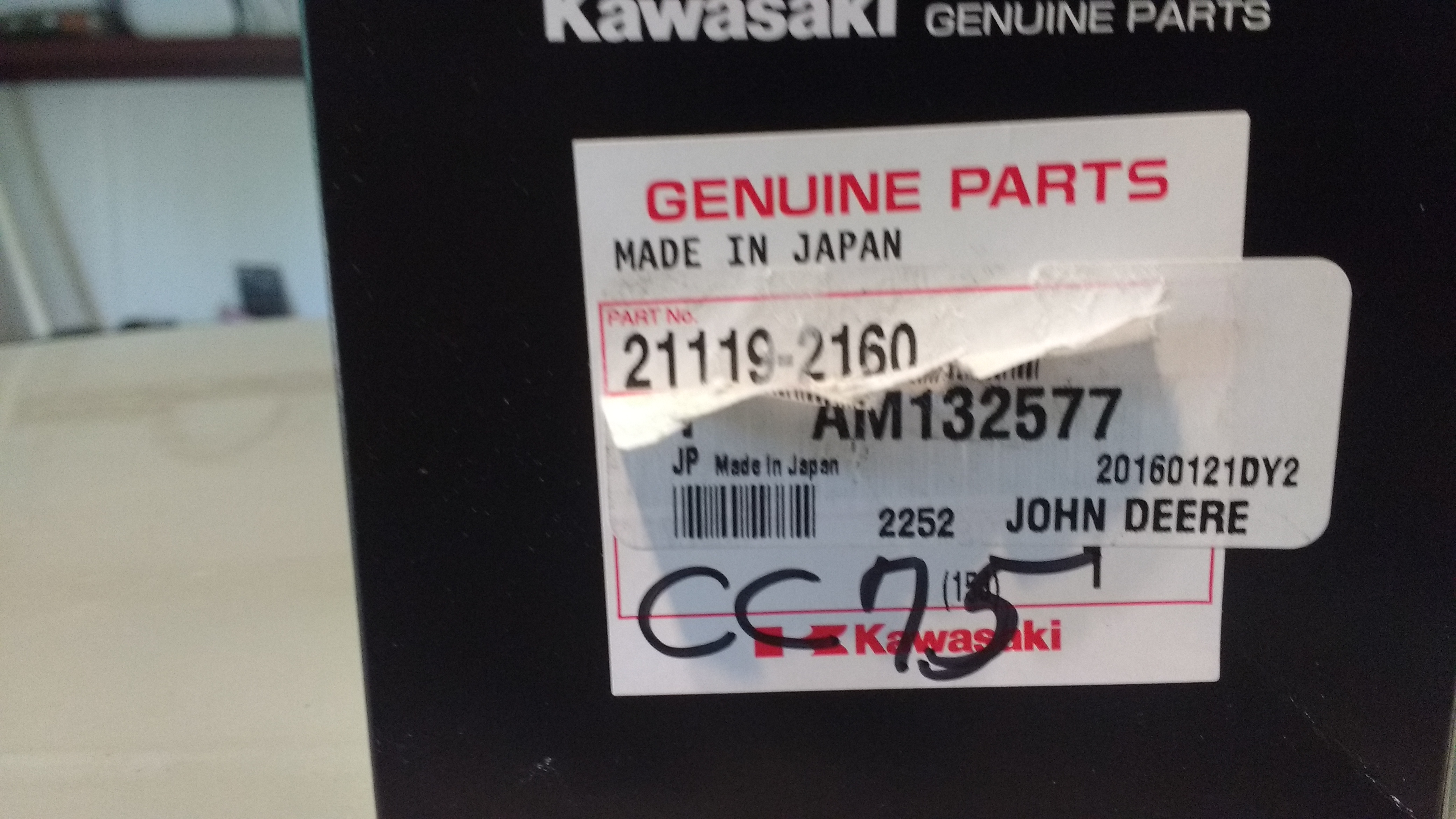

Well.after 6 months, we finally got a new ignition for it, and it fired right up. Now we need new tires. Here is a pic of the box it came in. A.Kawasaki part with a Deere label over the kawi label. IMG_20160417_100721976.jpg
   / 2004 John Deere HPX 4x4 Gator Will Not Start #10
I put the picture to show that the
Kawi 21119-2160= Deere AM132577
I have been able to find the Kawi part discounted online.
