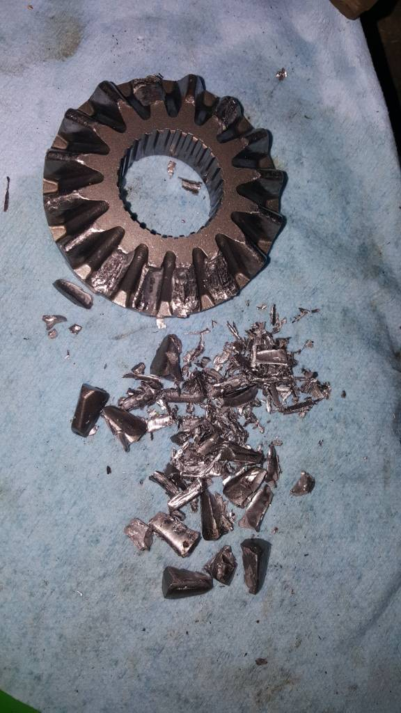

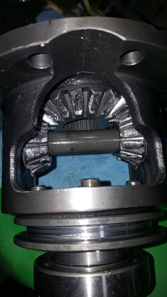

Small flakes like this?...LOL

Thanks for responses guys. So no chunks...definitely not like the pictures, but basically glitter size...a fair amount of it. I might strain the oil pan to get a better idea of quantity. The tractor has 2k hours. The fluid isn't old because its been leaking. I don't know how much exactly but both tires had a fair amount of coating on them..strangely the side that had the most, had less flakes.
The gears in the front diff look good from what I can see.
