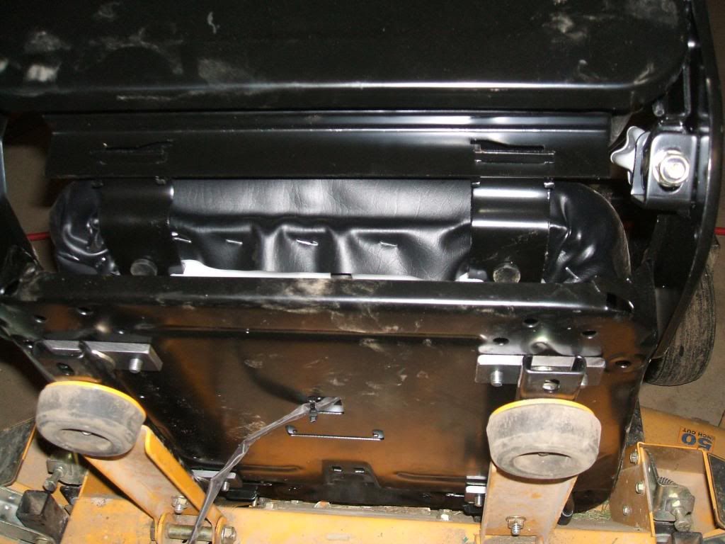

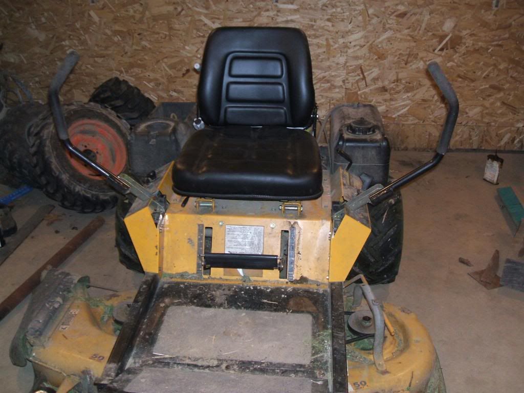

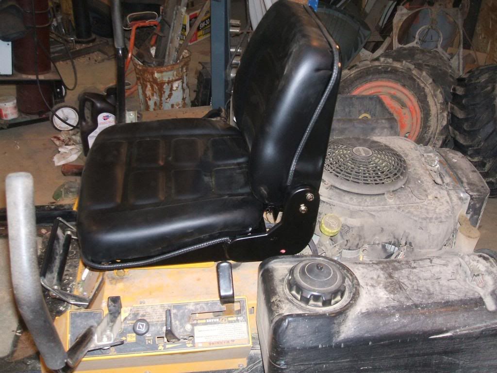

Finally got tired of the kidney punching low back seat and installed a fork lift truck suspension seat.
I've got 754 hours on it.

OM - Yer back will love you for that little treat... a lot more substantial,yes. Wus the mounting hole pattern a direct fitup?
   / 2006 Z Force 50 got a new seat today
I had to make some adapters to match the 11.25" width of the Cub seat rails.
Also had to wire in a relay to reverse the seat switch wiring since Cub used a normally closed switch in the original seat.
   / 2006 Z Force 50 got a new seat today #4
Well done, OM - some pro work there. Enjoy!
