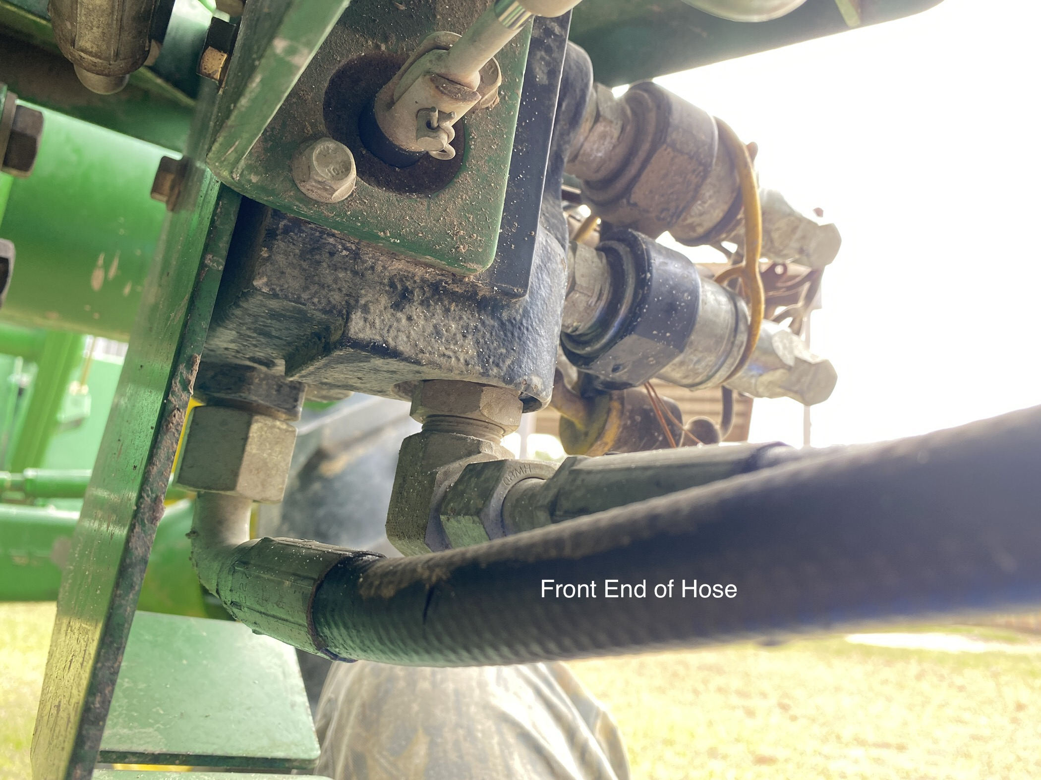

Looks like this is it. Will check with dealer tomorrow.
   / 2008 JD 5303 With JD 522 FEL Hose Issue #22
Key 20 is P/N T77932. It is for a -10 ORFS fitting. -10 is 10/16 or 5/8. If you have a local hydraulics shop closer, ask for 5/8 ORFS O-ring or a -10 ORFS O-ring (both are the same thing)
#23
Thank you for your efforts looking that up and explaining. I contacted the dealer this morning and they have them in stock. I will be picking one up Saturday morning and seeing if can get it fixed.
#24

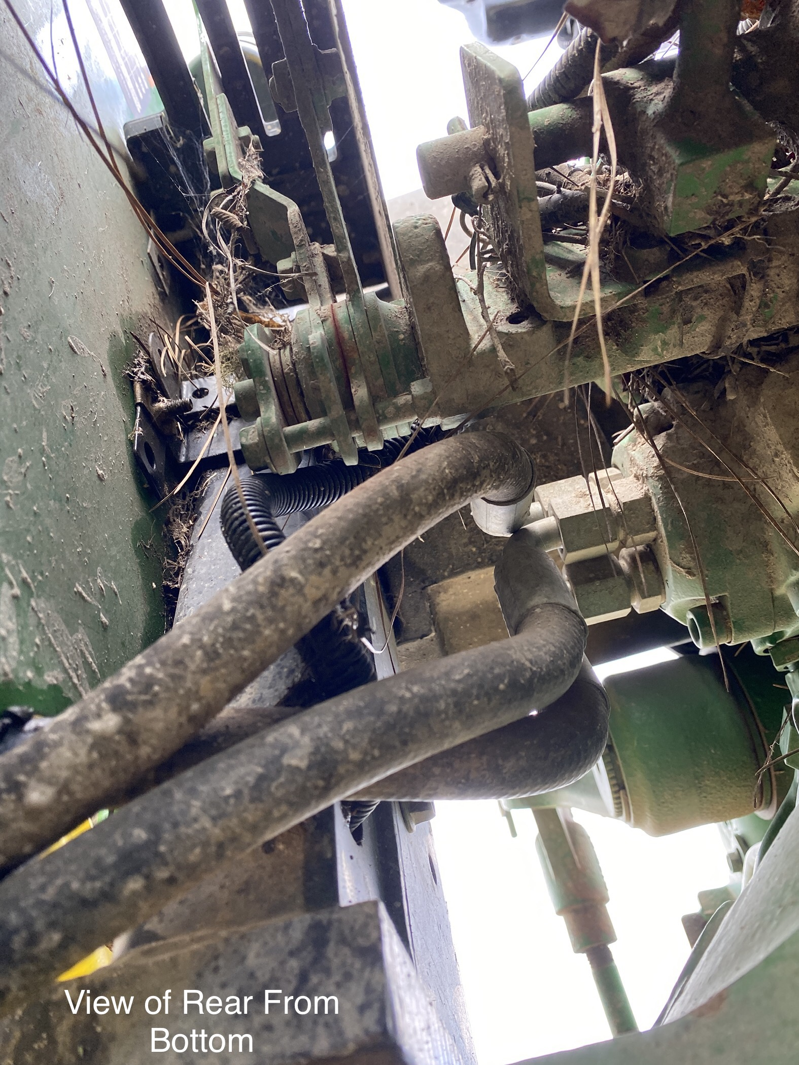

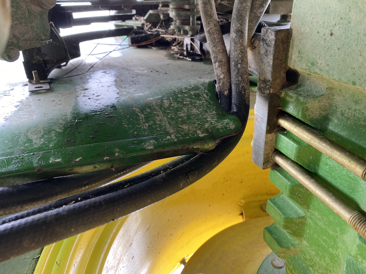

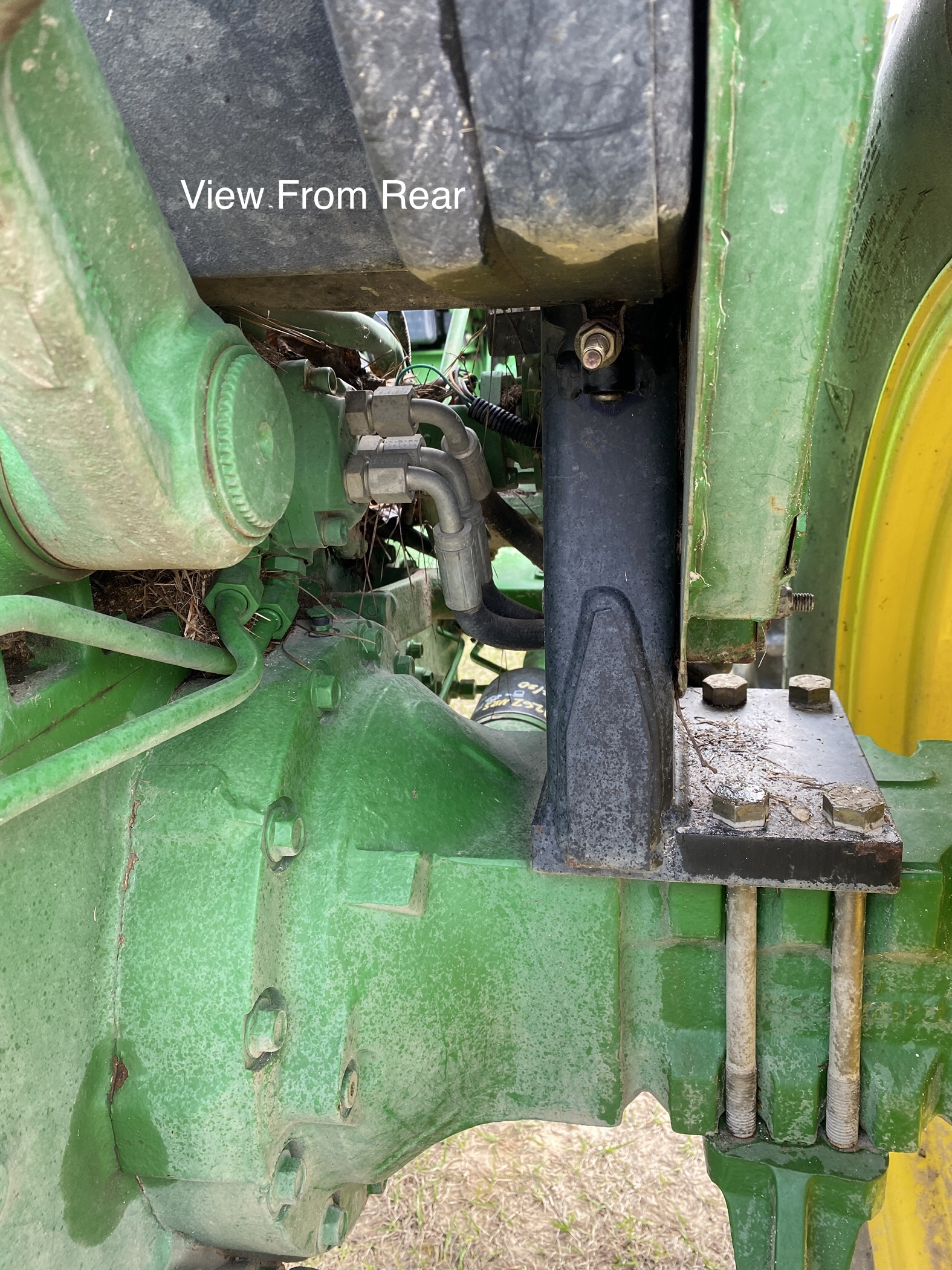

Fitting circled in yellow is the new fitting that was leaking. Picked up O-ring yesterday morning. Other two pics are of the old hose taken off. No O-ring was left on it and the O-ring picked up didn’t really seem to “fit” tightly anywhere. It was bigger diameter than the fitting opening so placed it as best as could centered and reinstalled. So far so good. Leak appears to be stopped. Thanks again for the helpful suggestions.

The "face" of the male fitting has the groove machined in it for the O-ring. So, ORFS = O Ring Face Seal
#26
In that last pic I was able to zoom in and see the groove. I don’t believe it was visible by eye. I appreciate your sharing the info.
