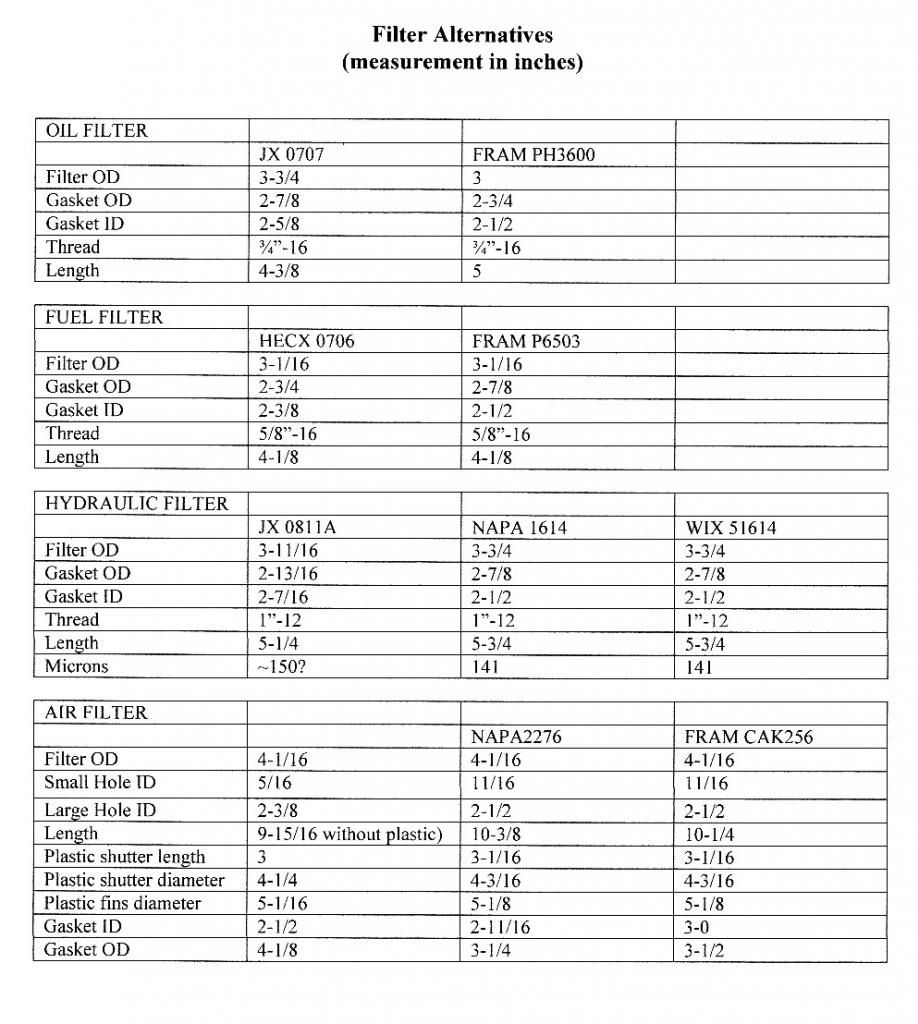

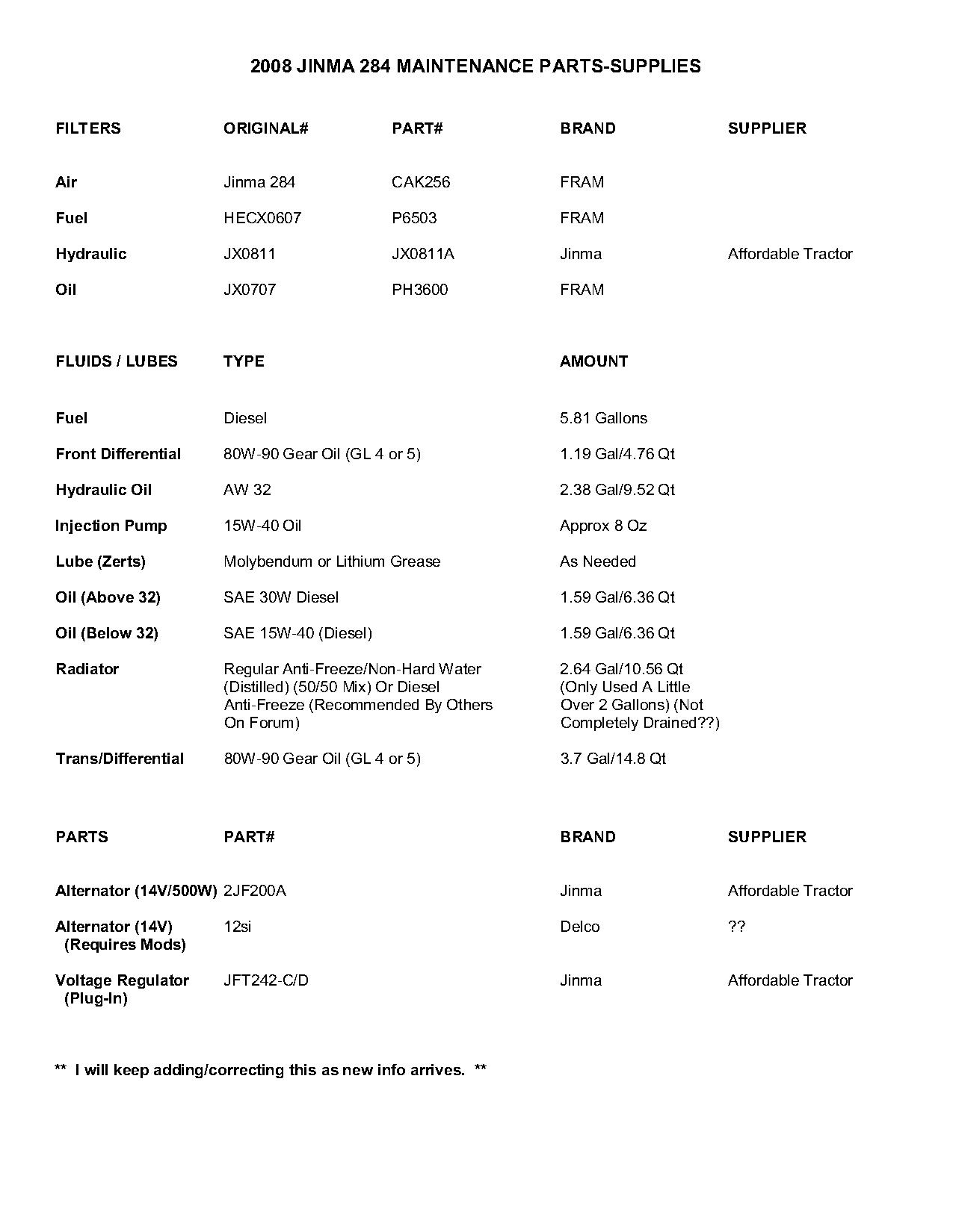

Oct 19, 2014 / 2008 Jinma 284 Maintenance Info Thread Starter #33 OP M MadMopar Member Joined Oct 12, 2014 Messages 41 Location Bennett, CO Tractor 2008 Jinma 284 OK, so here is the updated maintenance list as of today. I will continue to update as I get stuff done.
