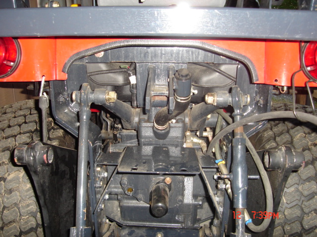

I hadn't read about leaving the BH on when changing fluid, but I can tell you it's a real pain to both hit the fill tube and see the sight glass when the BH's mounted. MUCH easier with it off. Here's a pic of my 2310 with the BH off. Fill tube is right there at the top, with a screw-on cover. Yours might be different, but I'll bet it's the same. ijk

As mentioned by DMW, if cost is not an issue use a high quality fluid. Keep in mind the system on a GC compared to a larger tractor. The GC does not incorporate a hydraulic fluid cooler anywhere within the circuit, any cooling of the fluid is achieved by the HST fan and the castings. You have less cooling capability than a larger system that incorporates a cooler therefore the fluid quality is more critical. Additionally, routinely check the fan on the HST input shaft and confirm it is secure. These fans can on occasion break the spot welds eliminating the fans effectiveness, usually you won't notice this until the HST is fried ! Ensure you always keep the castings and HST clean to maximize cooling, a blanket of grass clippings is not a good thing !!
