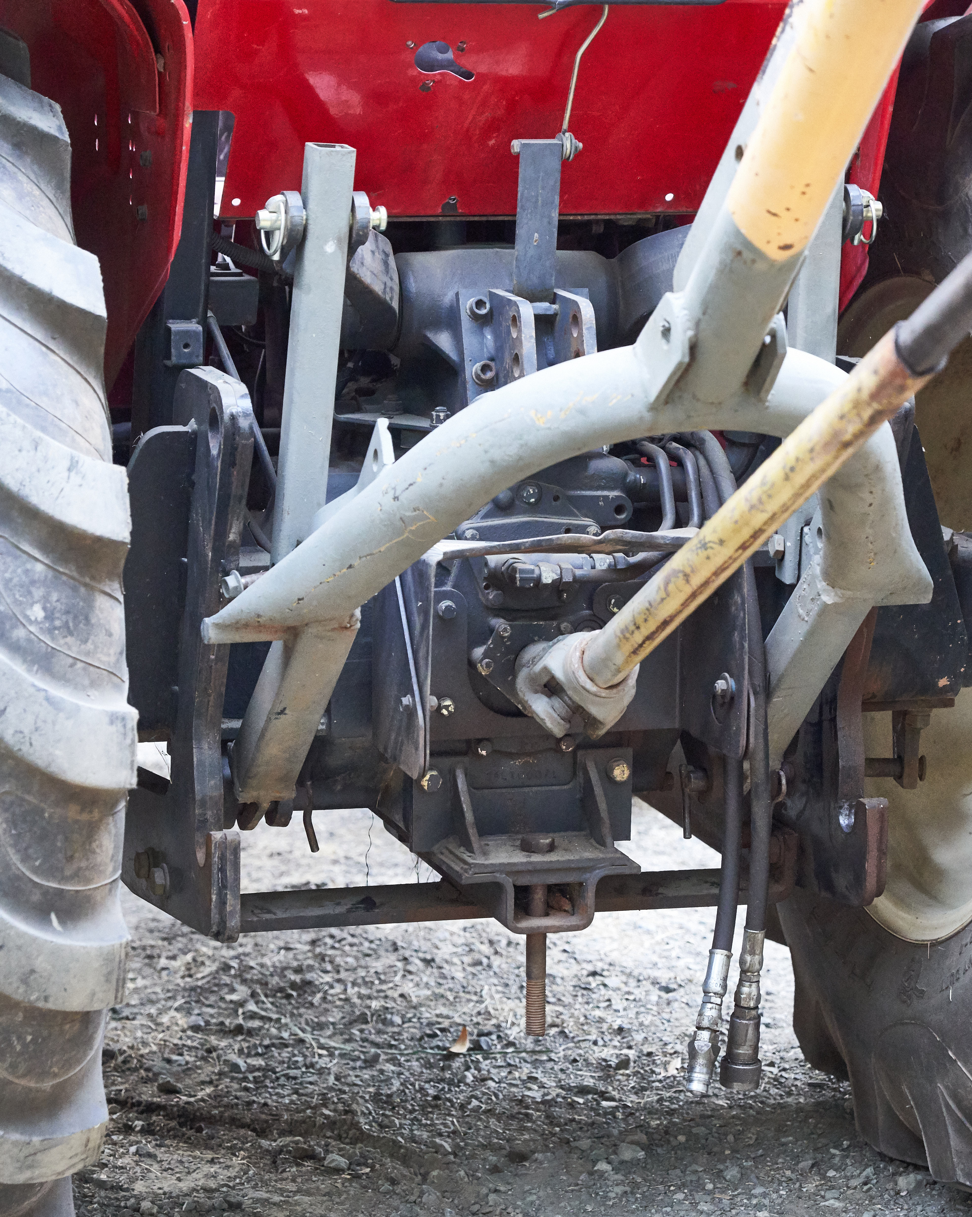

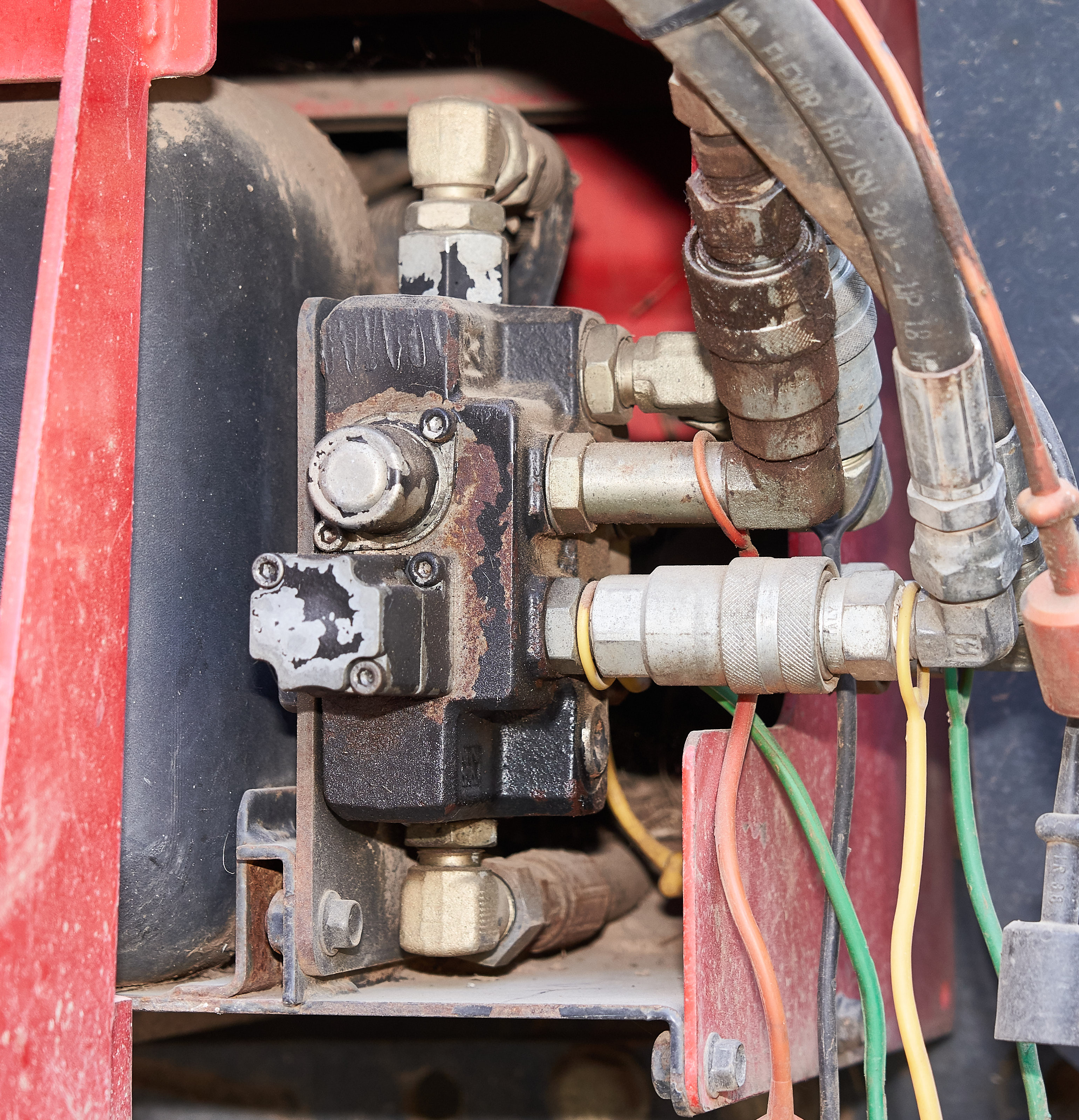

Hello Branson people. I'm new to tractors and new here, and I have two 3-Point troubles:
1. The lift and lower lever doesn't have any effect. I do have the lowering valve open. The loader and backhoe (when attached) work normally, so I would think low fluid is not the problem (although I haven't topped it up yet).

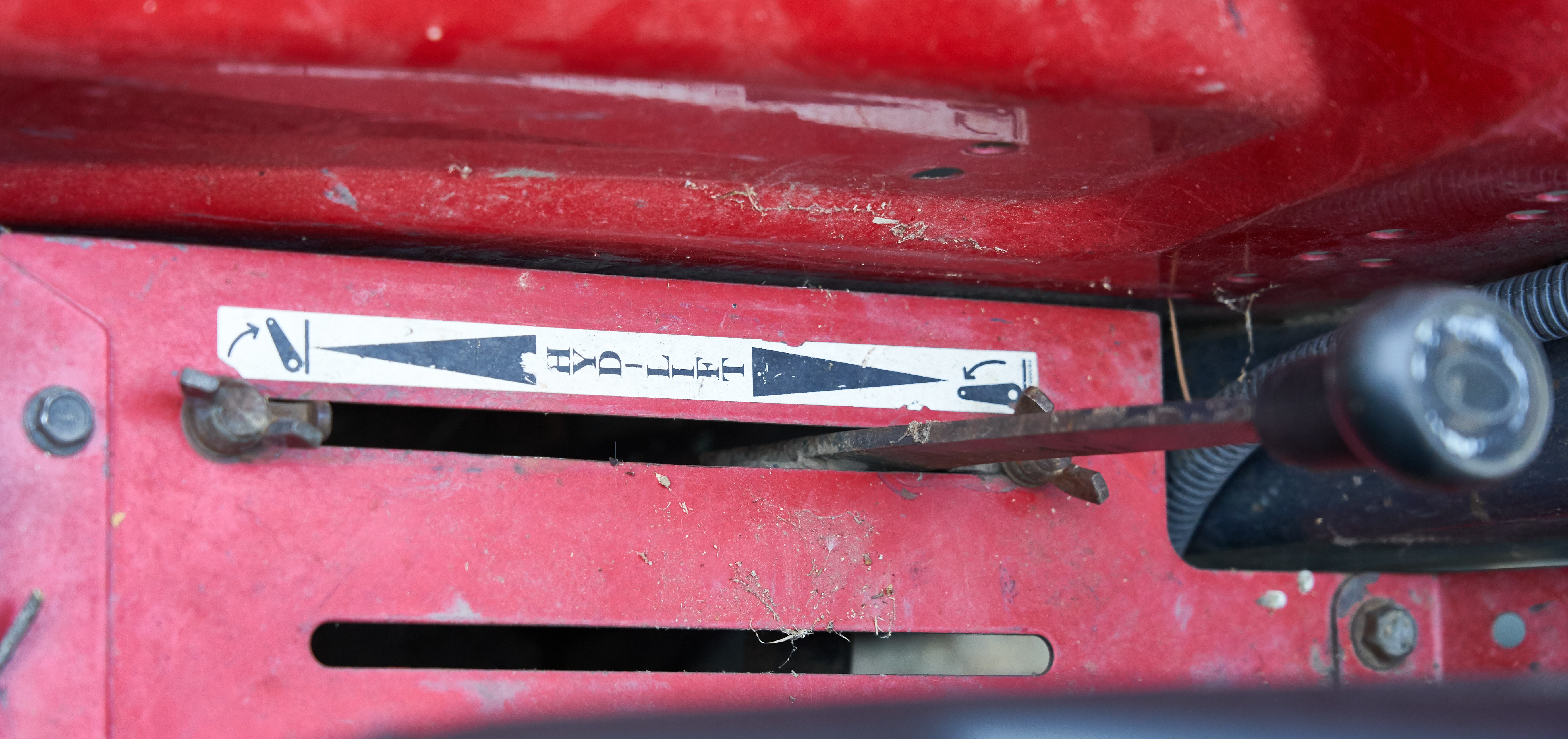

2. I can't get the PTO to run, likely because the PTO lever is stuck in the middle position which looks like disengaged judging from the icon on the sticker. I have the dial switch set to Independent, and the PTO light comes on.
I've pasted a few photos below. i'd be most appreciative of any ideas.

Hello, Welcome to TBN.
When you remove the backhoe, you have to connect those two hoses (hanging in the second picture) together to complete the circuit, otherwise the pump is deadheading and pushing the fluid through the relief valve which will heat it very fast and cause issues. Once you get the hoses connected, the 3 pt should work fine.
As far as the PTO lever, probably the previous owner didn't use it much or at all, and the linkage if rusted together. You may need to go underneath and either spray some WD40 or something similar or take the linkage apart, clean and lubricate.

ptsg, thank you!! I was wondering about that. So the backhoe is open-center.

As an added comment when those two hoses are not connected you most likely are dead heading your hydraulic system and forcing all hydraulic flow through the relief valve,
which will over heat your fluid and create unnessary pressure in your system.
   / 2011 Branson 4520R: Lift function dead; PTO shifter frozen
Thanks to you all! The 3pt lift and lower works great now!
Regarding the third function on the loader, here's a photo of the existing valve pack. I'll contact WR Long for a kit.
