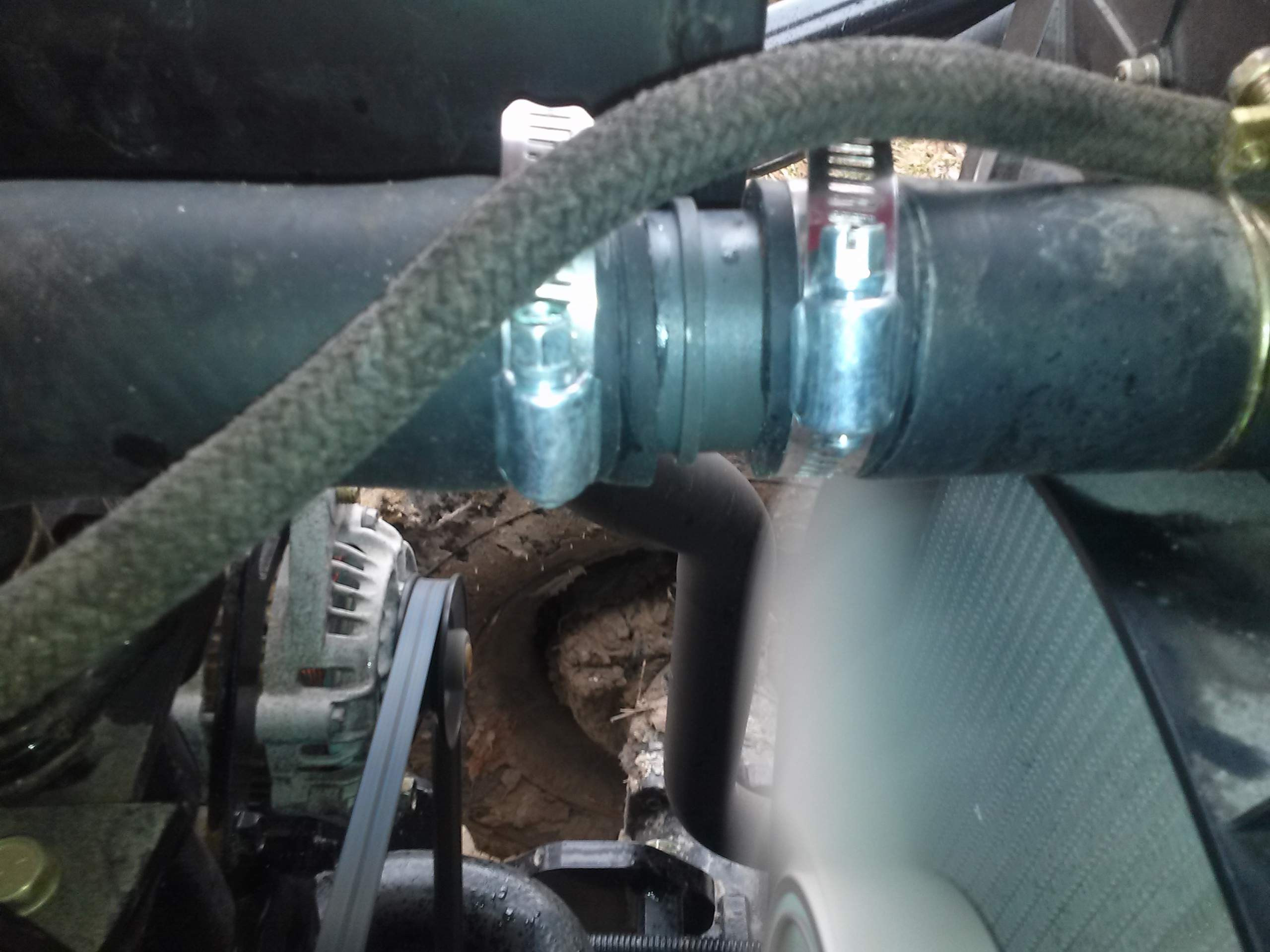

/ 2012 4010 Mahindra Daedong Engine Temperature Problem
Ok, I fixed it last week.
Problem
Daedong thought it would be a good idea to bypass the thermostat with a 5/8" line split from the upper radiator hose to the oil cooler. Because they bypassed the thermostat, the engine never gets to proper operating temperature (mine was around 98 degrees).
Fix
I took out the Y on the upper radiator hose and used a radiator hose repair kit ($5 from Oreily's) to join the hose back together. I removed the temperature sensor and spent $40 at the local hardware store making a new Y out to the sensor and oil cooler. Some trimming and custom fitting is necessary to get all the parts to fit.
Results
The tractor is operating at normal operating temperature and it appears to have to more power. Mahindra is still working on a fix. The rep told me that, instead of moving the sensor, he wanted to take the small bypass hose (bypasses the water pump, under the thermostat housing) and put a Y in to accomplish the same results.
(The Mahindra rep said he is working on it, but appears less than appreciative that a customer showed that there was a problem and how to fix it. The rep referenced the TSB on the 50 and 60 hp but was not aware of the 40 having issue. He confirmed for me that this was not just my problem.)
