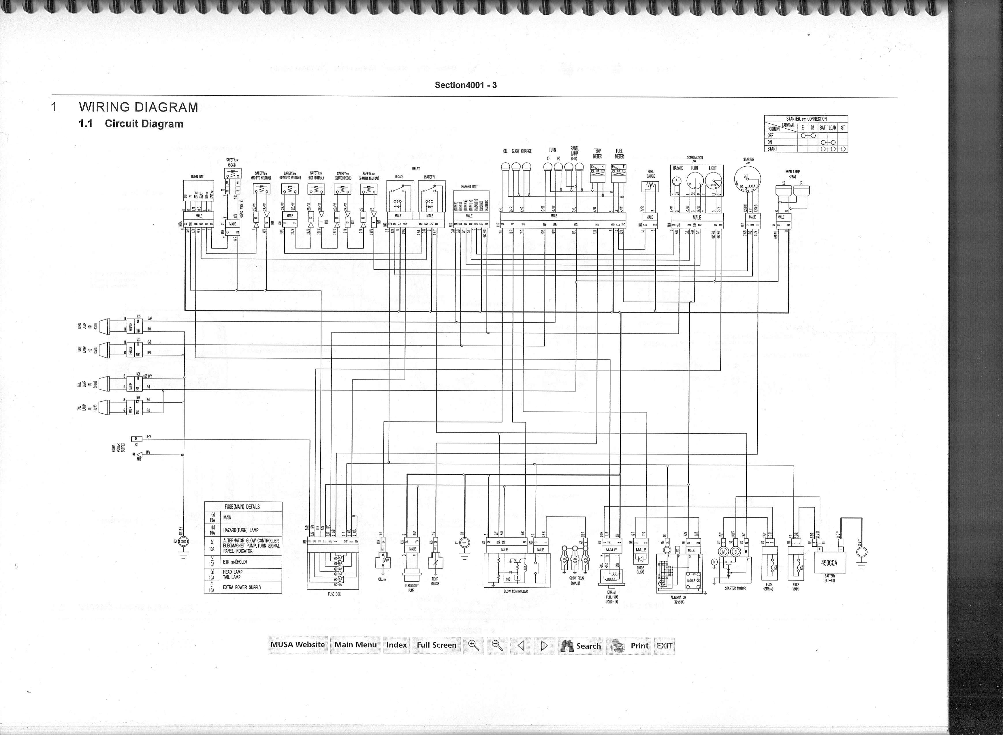

Believe it’s from a Max 26 but should be the same.

And big thanks to doneill127 for the wiring diagram. Made it much easier to isolate the problem area.
My eMax 22 HST has a 40A and 2-50A fuses. This diagram doesn't show a 40A fuse. I have a hard short that is blowing the 40A every time I turn the key (not to start it, just turn it to warm the plugs). Anyone have a diagram that shows a 40A fuse. I am trying to determine where to look for possible shorts or bad components.
   / 2012 Mahindra Max 22 Will Not Start, Electrical Problems. Not Safety Switch Related. #10
eMax tractors are not the same as the Max series. The Max and some of the other smaller Mahindras are MHI machines from Japan. Believe the eMax is Korean made by TYM I believe. So the referenced wiring diagram is not applicable. Sorry
