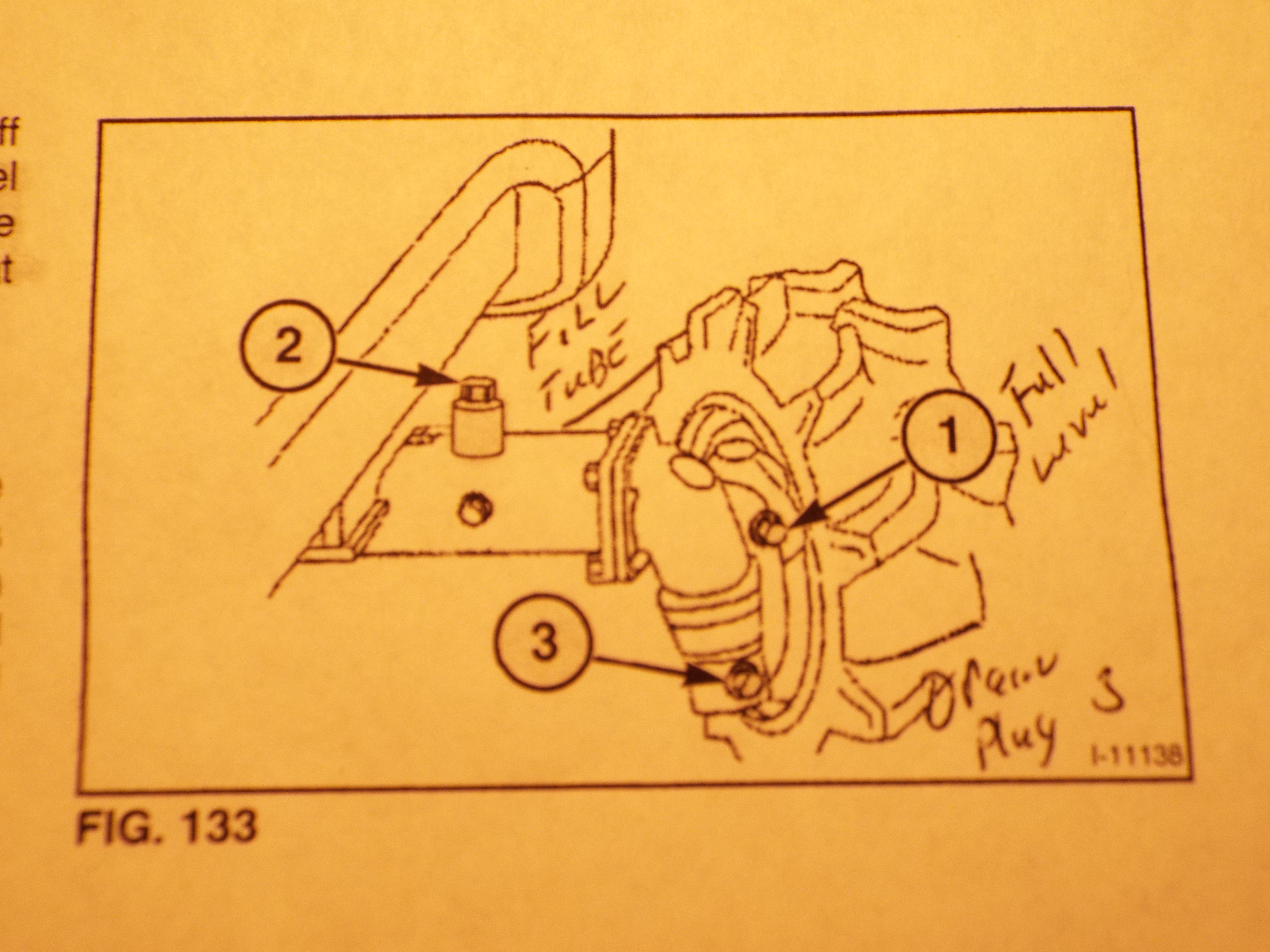

I have a 2012 massey ferguson 1529. I'll be darned if I can find the front axle Level Check? I know where to fill and drain but for the life of me I cannot find the level check plug. It shows it in this photo but it's not on my tractor. DSCF2688.JPG
   / 2012 massey ferguson 1529 Axle fill check plug #2
number 2 is where i check mine on a 1533 park on level ground remove number 2 the oil should be center of your axle shaft may have to use a light to see it
   / 2012 massey ferguson 1529 Axle fill check plug #3
Looks like there is a plug below 2 in cener of axle housing. Would think that is where level should be at.
