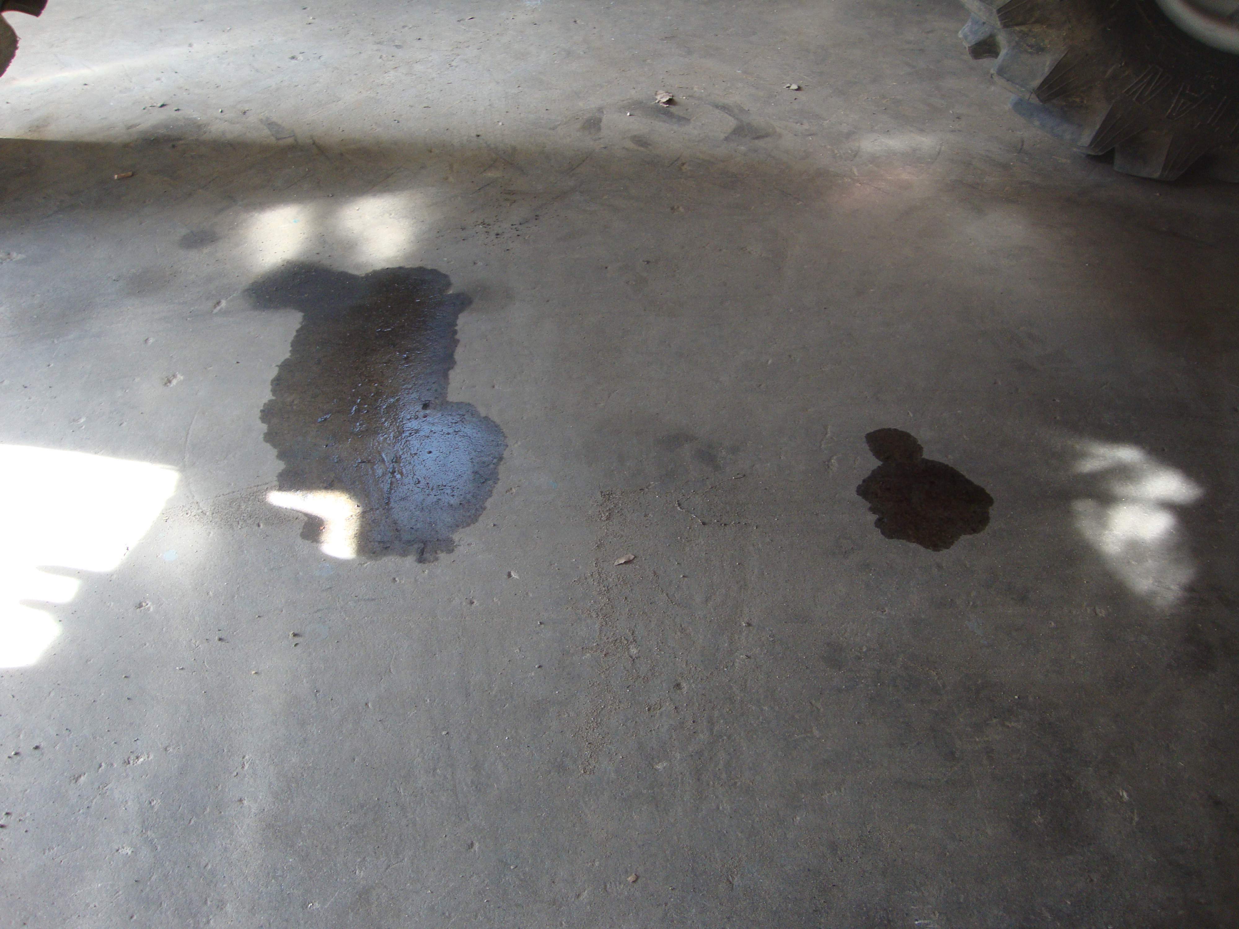

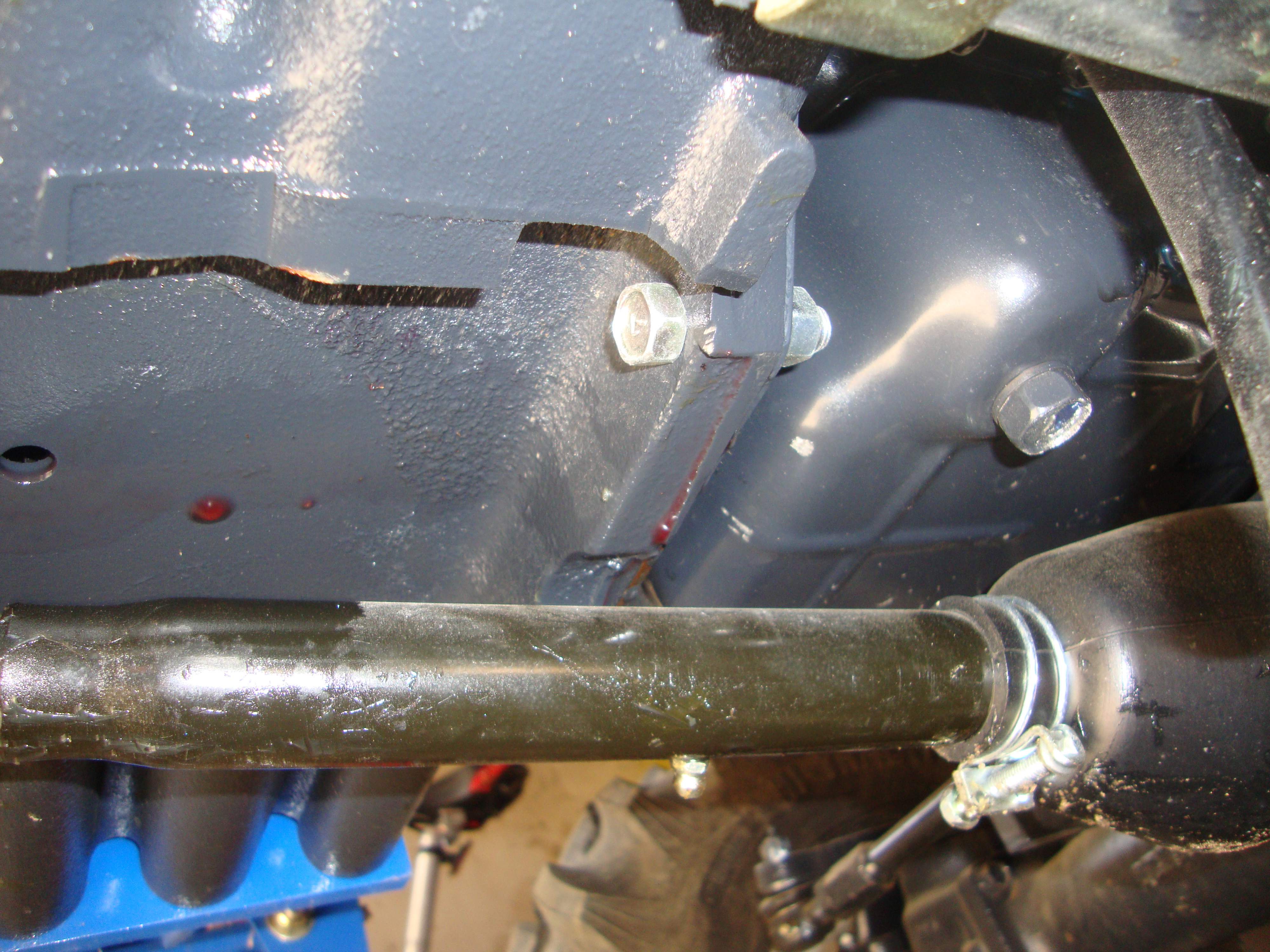

Looks like the same leak I had on my T1520 at about 100 hours. No they would not come and pick it up. I got a friend with a trailer to help me get it there. Got to see it apart they broke in half to fix the hydro seal. Was kind of neat to see and the dealer encourage me to come in and see it. I tried to drop a hint that I would like to add a set of remotes, but I got feeling from them I did not want to know there price to add... too bad. Learn my lesson get the at zero percent and when your buying. Mine had a plastic cover on the housing. They also told me the hydro ?pump? seal would have been a real pain to fix on a kubota

Sorry didn't get back to you guys sooner ...busy as **** with work. I got my hands on a trailer that barely just fits the tractor. So i took off the loader attachment and loaded it up and brought it to a dealer in Pine Plains,ny. Well they replaced an inner seal and supossedly everything should have been good. Thank god i park the tractor in the garage and I noticed again its leaking at the same spot. Called the same dealer and I have another appt to drop it off next saturday. Starting to really get annoyed now. I think theirs an imperfection in the tranny and its not completely flush where it bolts together at the seal...hence the leak again. Only thing I can think of ...
