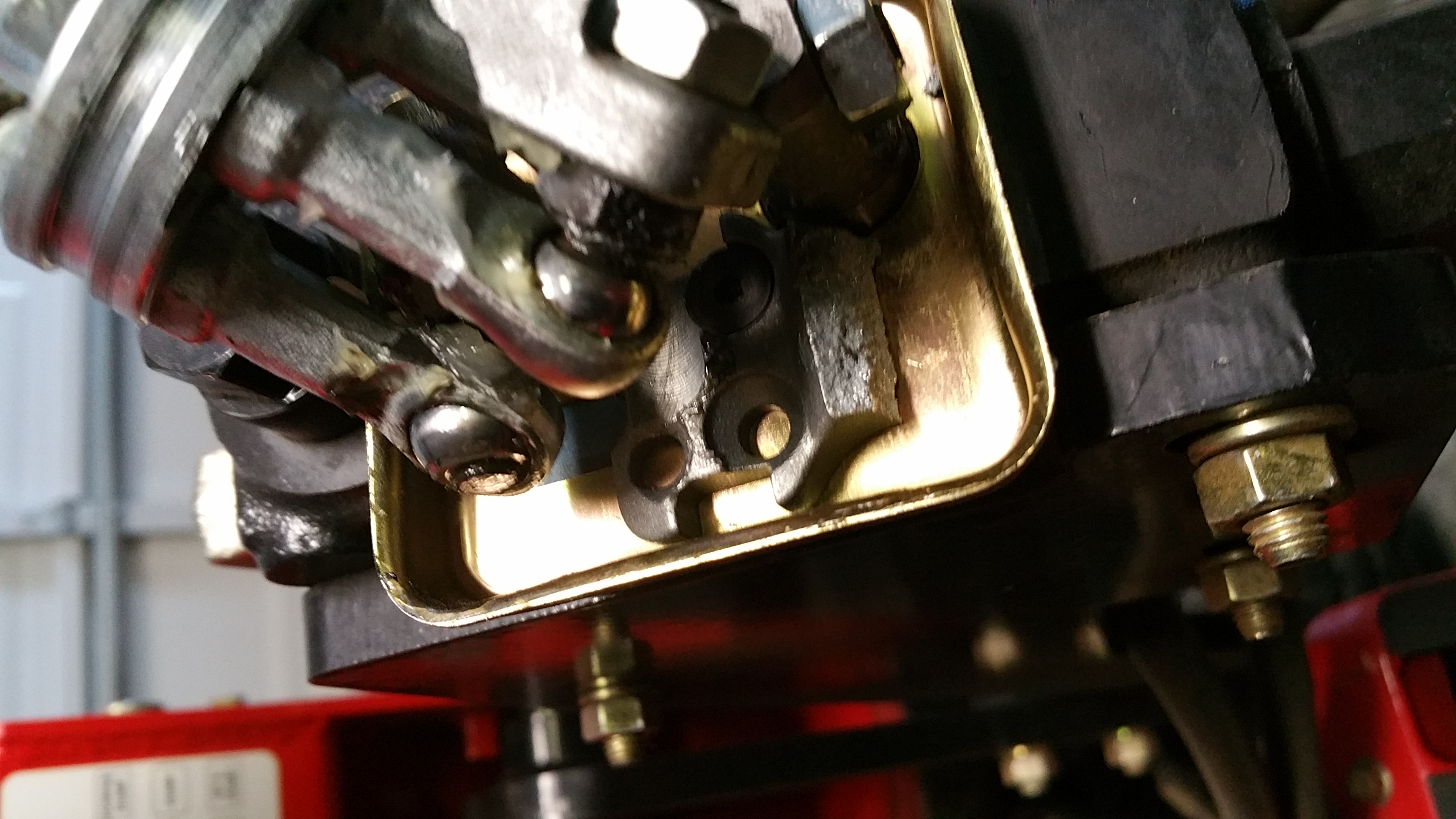

Last night I went to move a little bit of snow in front of my Garage and the Loader Valve on my 2800 hst broke inside. I went to rotate the bucket to dump and the handle went soft like something let go inside at the bottom of the handle. I was unable to rotate the bucket, but was able to raise and lower it still.
I still have some Warranty left on the backside of the 4 years and I am curious if this is covered. Or has anyone else had this problem with their 2400/2800 model Branson 4x4 tractors.

These are two pictures of the mount itself after I pulled the cover off to reveal that the attachment plate has broken and now, where can I find one. Considering I have only 71 hours on my tractor over 3 years, has anyone else had this problem. These are supposed to last a lifetime right.
   / 2013 Branson 2800 Hst Loader Valve broken
Well after reading several posts here on TractorByNet and several calls to dead ends, I ran across another post from 2012. I then called and was saved by Dave's Tractor Inc, A Branson dealership in Red Bluff, CA Phone: (530) 528-0755
These folks knew what I was talking about and went right to my part on the shelf. So instead of being sold a rebuild kit for $300. + or a complete valve for $800. + from 1 local dealership and 1 nameless in TX. I will have my part being shipped with a new Air Filter for less then $100.
Thank you again Daves Tractor Inc
