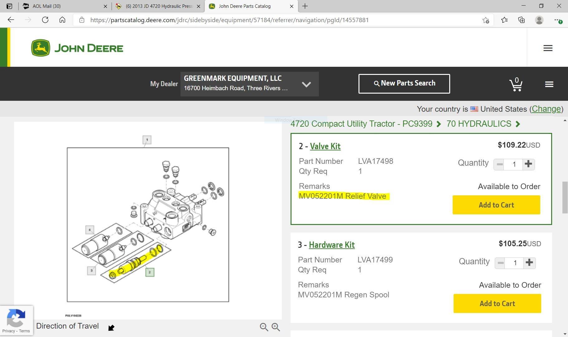

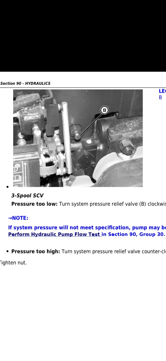

I am looking to increase my hydraulic pressure on my 2013 JD 4720 because I checked the pressure and it was 2300 psi. The problem I have ran into is I cannot find the relief valve to do the adjustment I tried to use the picture provided in the technical manual (photo attached) however there was nothing there and the configuration is different. If anyone has any information on how to adjust this it would be greatly appreciated. Thank you.
