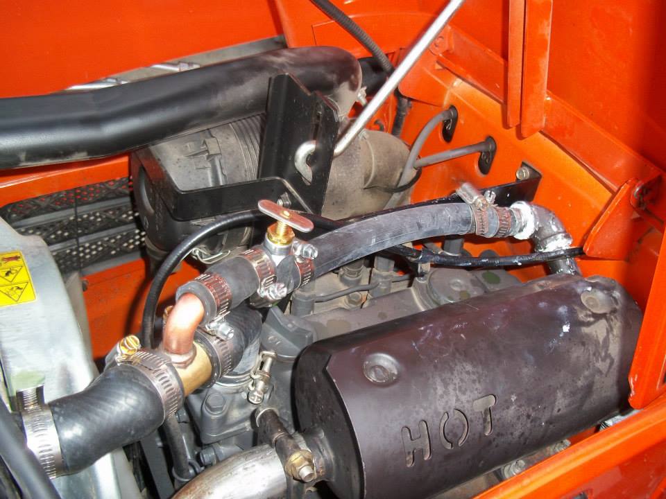

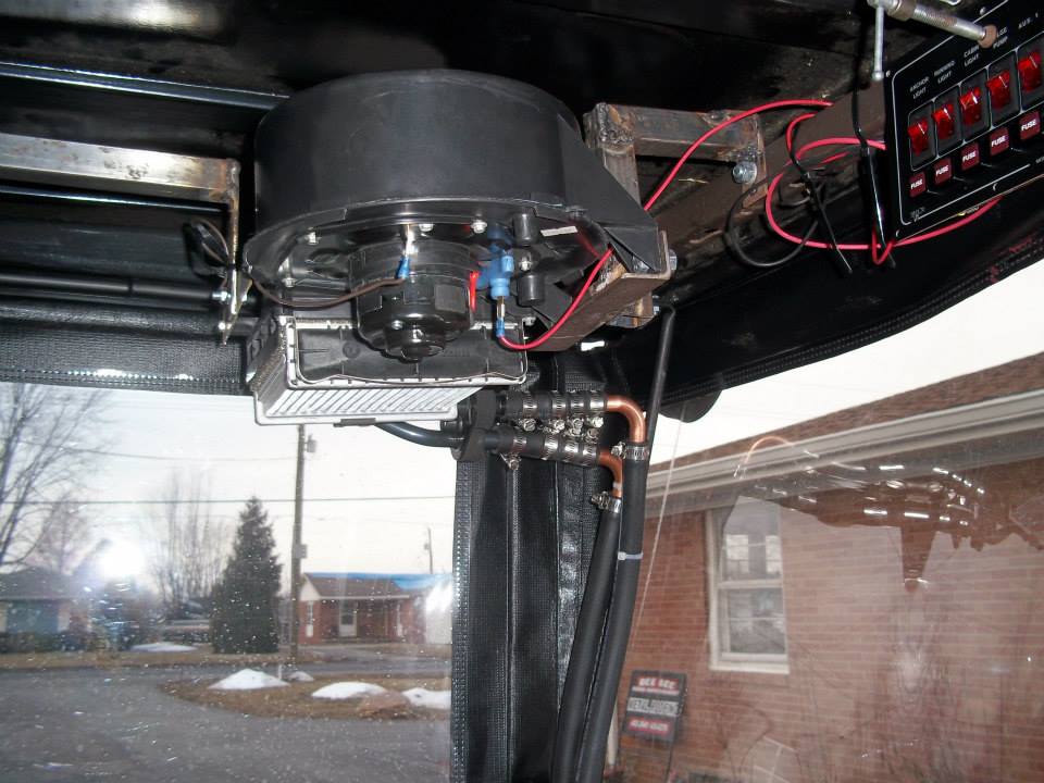

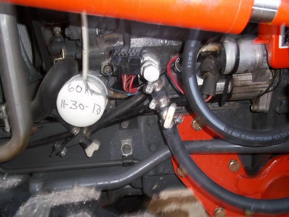

Here are more pictures of the heater. Right now I have the heater on an on-off switch, but intend to install a 3 speed switch. The heater assy is new, and for an Astro Van. It puts out about 12000 BTU's. Comes complete as a complete unit, for $68. Made my overhead mounts to hang it above me rather than down low. The B-2920 has little room for the plumbing. As you can see the plumbing was a chore. T- off the upper rad hose, shut off valve, hose, metal pipe. The pipe was needed as the pipe lays on the muffler. There is a block drain plug, where I ran the out-going hose from. Another shut off there. Works great! Kubota Heater 3.jpgKubota Heater 4.jpgKubota Heater 6.jpg
