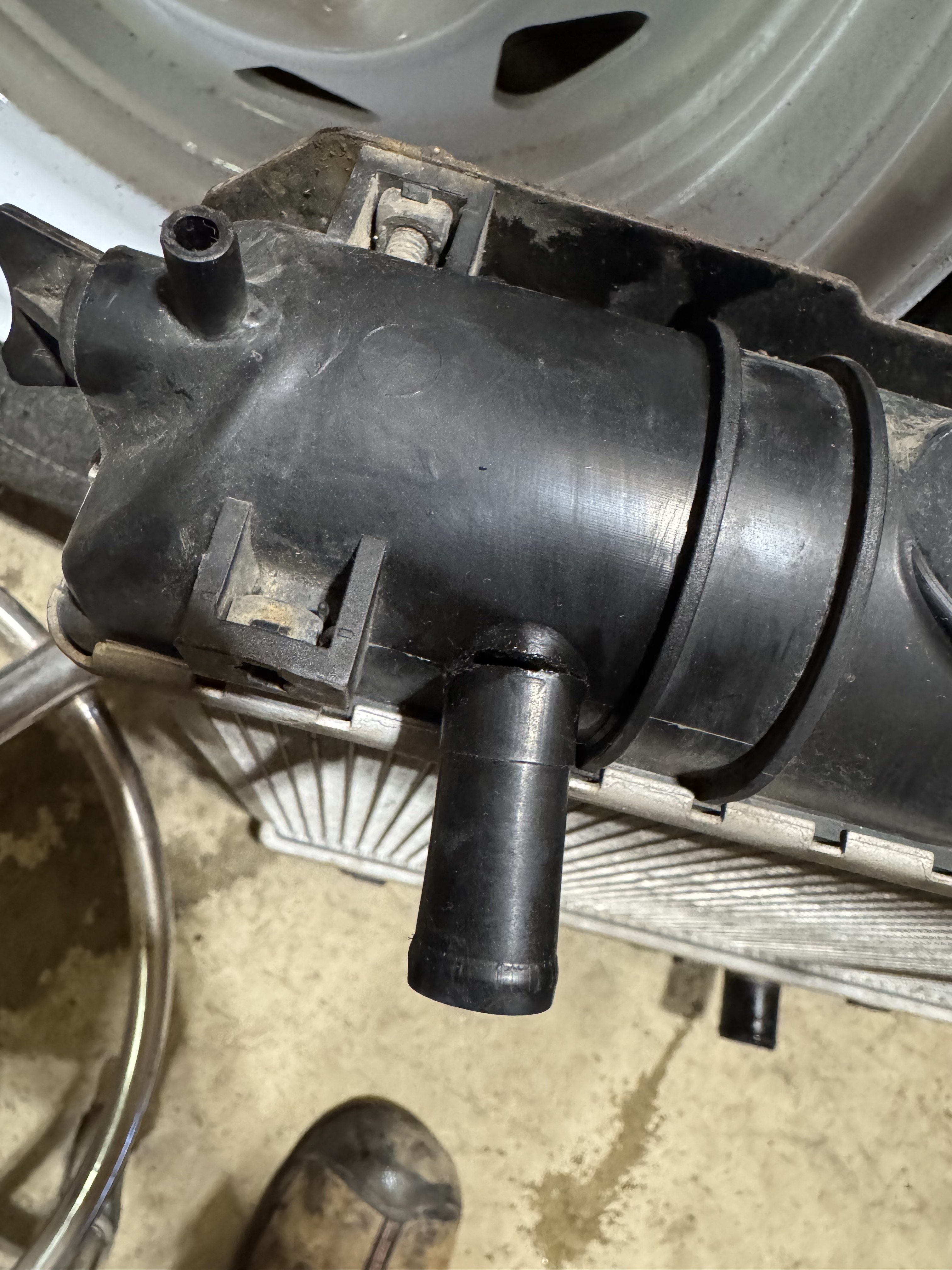

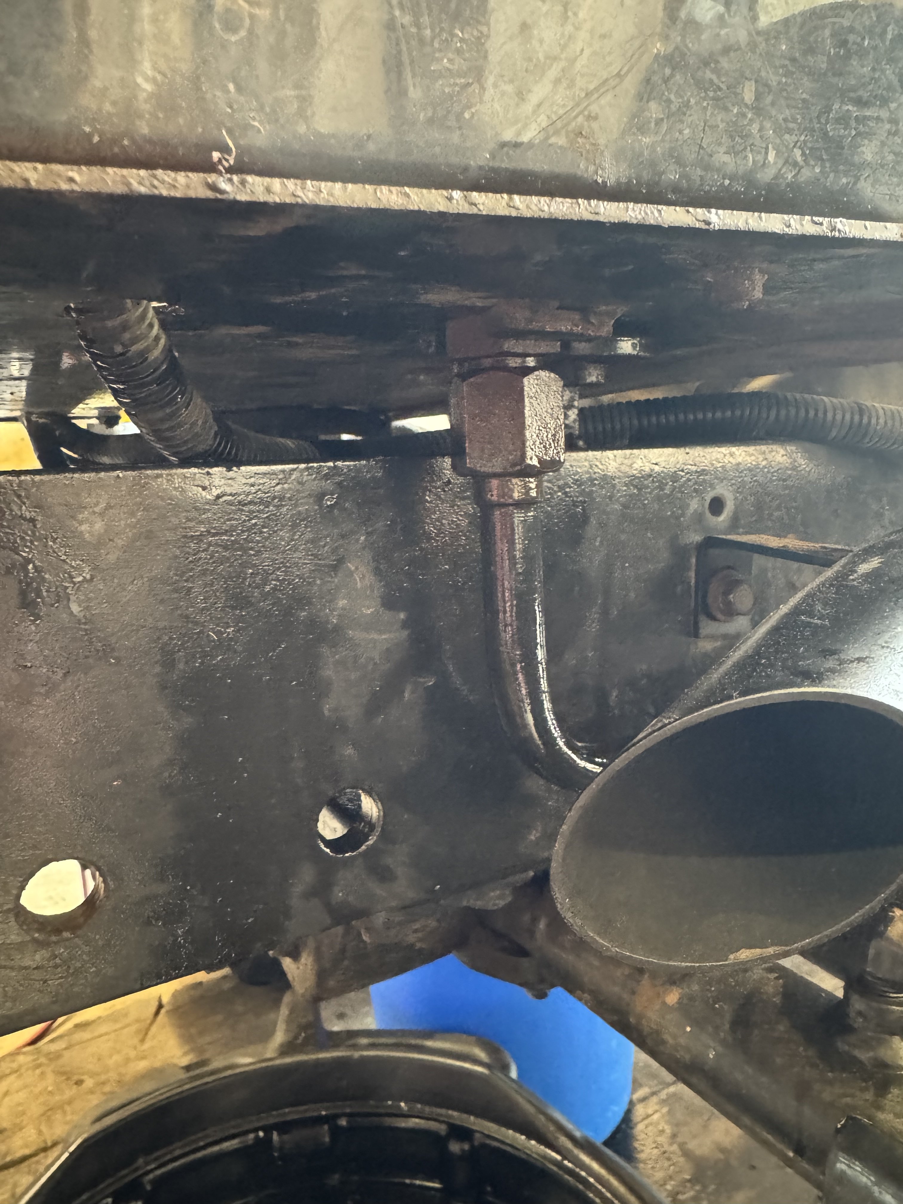

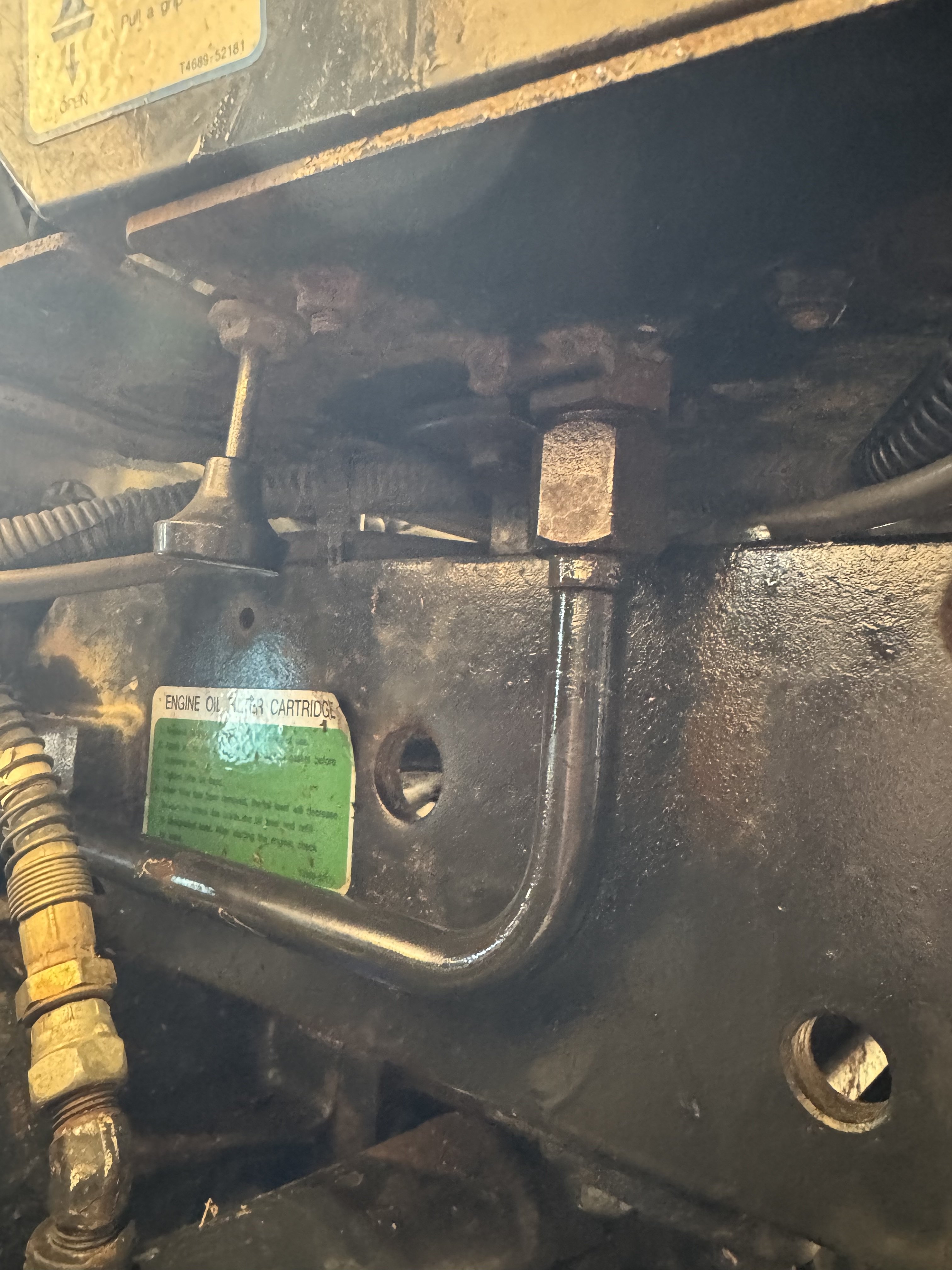

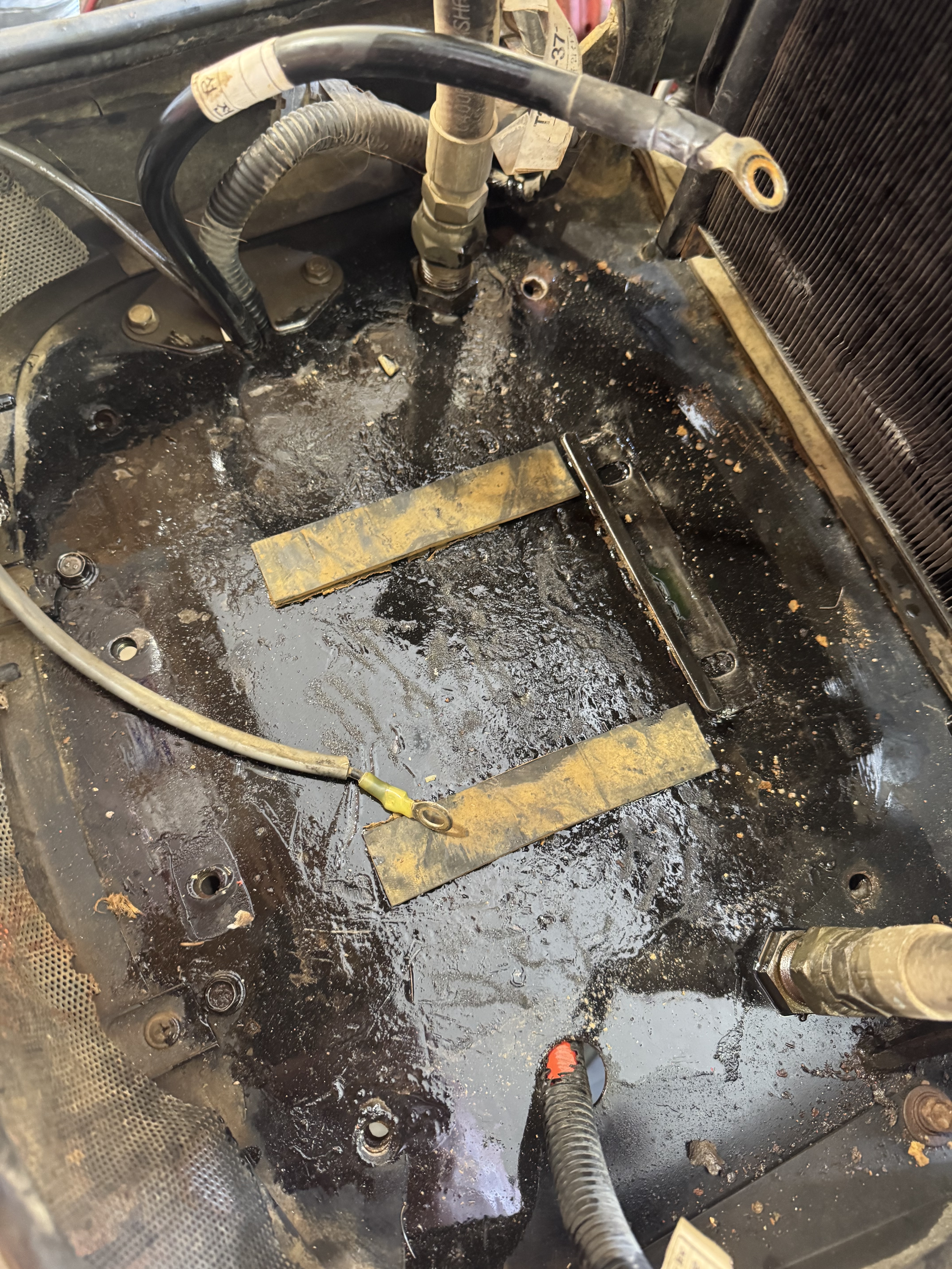

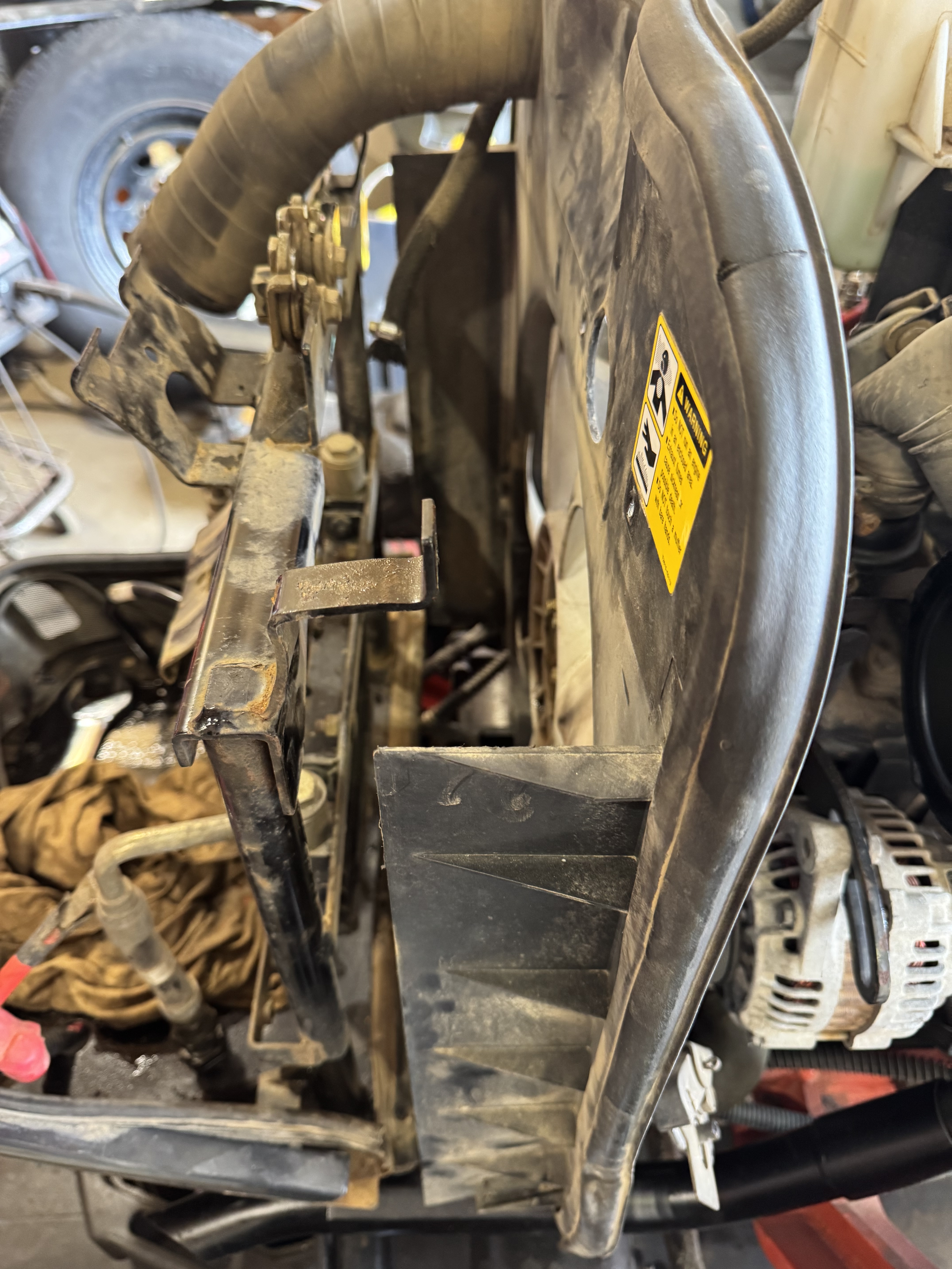

Looking for some advice on removing the rad from my tractor. Looks like I need to remove everything in front of the rad (oil cooler, battery and the tray that holds it all). Is that correct? Seems like a lot to simply pull the rad, but I can’t see any other way. Hopefully someone has a short cut that I’ve overlooked. 🤞
   / 2014 Kioti CK30HST Rad Removal #2
it's just nuts and bolts. You may beable to un bolt the fan shroud and slide the rad up and out.
I managed to get it out after. I did have to remove the battery and take out the four bolts holding that front tray down as well as let go the oil cooler lines temporarily to get enough play to slide the rad out. Now I have to fix the broken hose connection.
