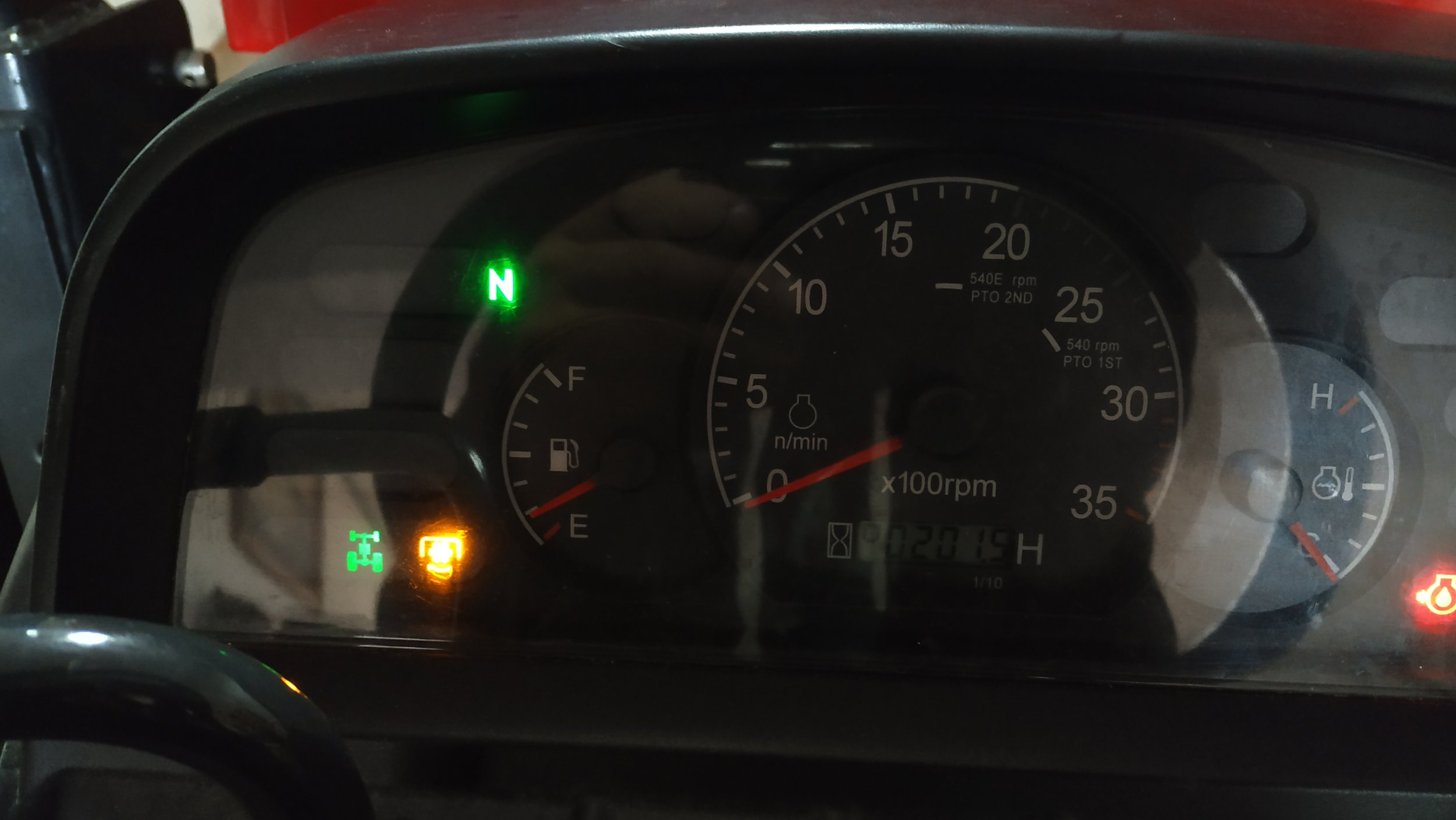

Thats awesome, Ill have to look, Id love the lights working like that, factory fail in my opinion to not have a light for each function. Do you happen to have any more info or tips? Thanks!
Here is post on how I made the 4x4 light work:
I believe it covers most of the stuff. Not sure if I mentioned or not but I used a 2 wire inductive proximity switch with a operating range from 5V to 30V if I remember correctly. Those are very cheap to get. I also used a low current fuse (something like 350 mA I believe) to protect the dash in case a wire rubs somewhere and creates a short circuit.
   / 2022 2515H with 34hrs dash dies #12
Seriously, but I guess if money is a major factor, I kind of get it, but Id pay an extra $100 for them to work from the factory!
Hell, as a former dealer sales/partsman & mechanic I would have split that with ya and paid $50 myself to not have to explain it all lol. But honestly, nonfunctioning lights was the smallest issue I had to deal with.
