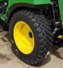

I have a 2018 2025r with the new R3 radial tires size 280/70 R16. I need some tire chains but I cannot find any manufacturer that has them for that size tire. My local dealer has come up with nothing as well. Anyone out there know of a supplier? I messaged several online chain makers and none of them can even make me a set until spring. Any help is appreciated.
Tread pattern

Not a tire expert but the sae equivalent should be a 31x11. Deere p/n pm2229r chains out of their light truck section show fitting a 31x11.5-16. I think as well that the 280/70r16 is only an inch taller than a 245/75r16. May or may not be helpful.
