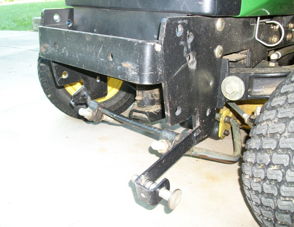

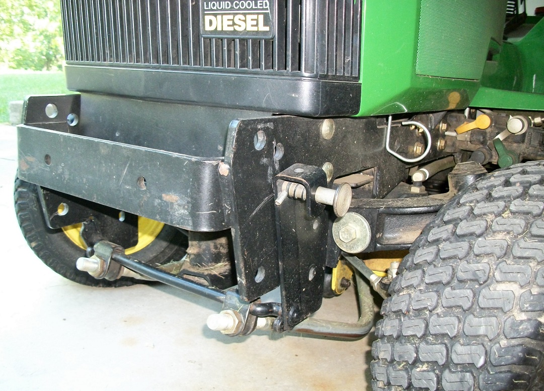

I've had my 2025r a little over a year. I have a 62 in drive over Mmm.
So I decided to take the mower deck off.
Watched video and followed directions. Could not get it off. Then discovered I had to crawl under and disconnect the pro as well as tie up the front mower mount. Looks like I got screwed with this "drive over" machine.
Anyone else had this problem?

"Drive over" is not the same as "Auto-connect". On my 2320 I removed the drawbar since I use a hitch on my quick hitch and that makes sliding under to get the PTO a lot easier. The front mount on my deck comes completely off.
   / 2025r
Yes, I guess I was under the impression it was A quick connect vs a drive over only. My fault there. A reason to trade a 100 hr machine for a 2032.😄
My front connect for mmm has a shiny metal bail that is connected to tractor by a pin on each side.
Do you remove these pins?
I had to tie mine up because I couldn't back over deck with it hanging down.
   / 2025r #6
On mine the front hanger hooks into the deck and sits on hooks on a bracket on the tractor. When you pull a spring loaded pin it comes loose from both the deck and tractor. Yours may be different.

A pic would confirm what you have, but I suspect it is the bail that just unhooks..
Does the front shiny bail look anything like this? latched and unlatched

   / 2025r
#9
Yes the bail comes completely off after pulling out the spring loaded pin. That's good.
