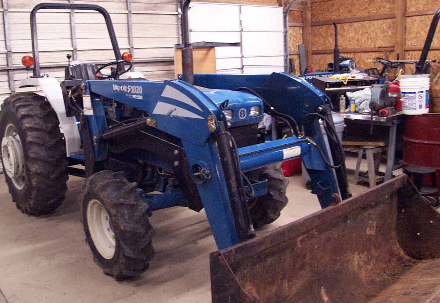

The 2120 weighs 3858 lbs with 4 wd. If the tractor has the 12x12 transmission, it is a hydraulic shuttle shift (can shift from forward to reverse without the clutch). There are optional ag tires 9.5x16 front and 14.9x26 rear. The two best loaders for the 2120 are the New Holland 7309 and the Woods 1020. Both have a 72" bucket. The Woods is heavier and comes with a quick attach plate to change the bucket like on skid steers. A dealer quoted me $4900 for the NH and $5400 for the Woods a couple years ago. The tractor will handle a 9' backhoe. It is one of the bigger compact diesel tractors. The price on the used one sounds a little high for the hours, vintage, and looks like it needs tires. I looked for 2 years and ended up buying a 2000 NH 2120 with the Woods 1020 loader, 375 hours for $15,500. It needed some tlc on the paint and front tires
