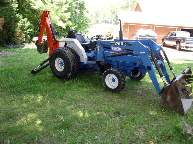

Firestone makes an 18.4-16.1 R-1 Ag tire.. All the major tire manufacturers publish complete sprcs including rolling circumfrence and overall diameter. I have the same size turf tires on my NH 1920 and found that the R-1 ag tires were 14.9-24 and 8-16 fronts. I found a pair of used rear rims and 14.9-24 R-4 industrial tires. The matching front tires are 10-16.5, 31 inch OD. Ford/NH never made a 16.5 rim so I am going to mount 31-10.50-15 mud tires on my existing rims. This will keep the lead/lag the same. Bill C

thanks for all the replies.
i was on the Firestone website and found the rear ag tires as well.
the front find is great!! i think i'll buy them. my fronts are in real bad shape anyhow. THANKS.
