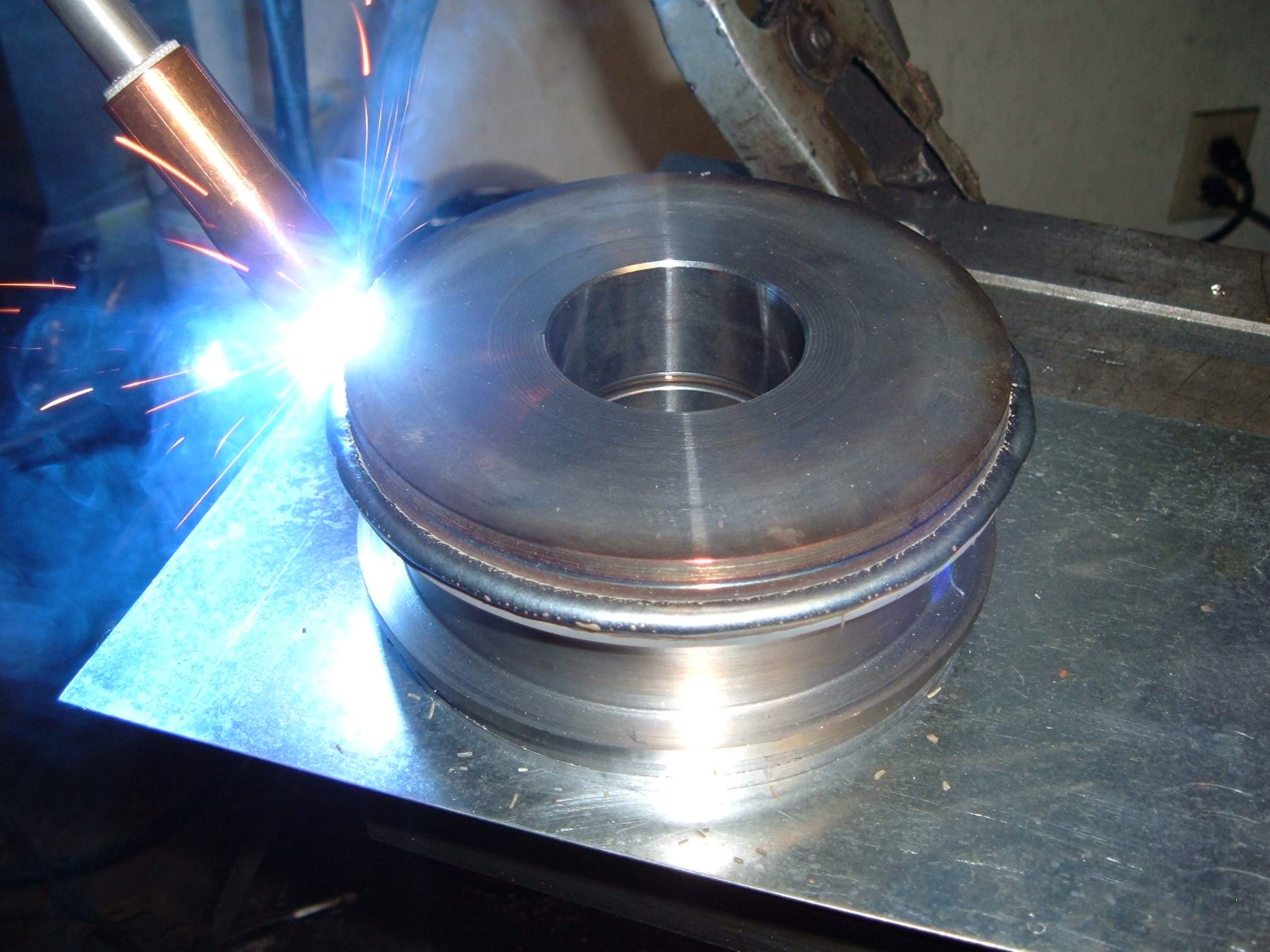

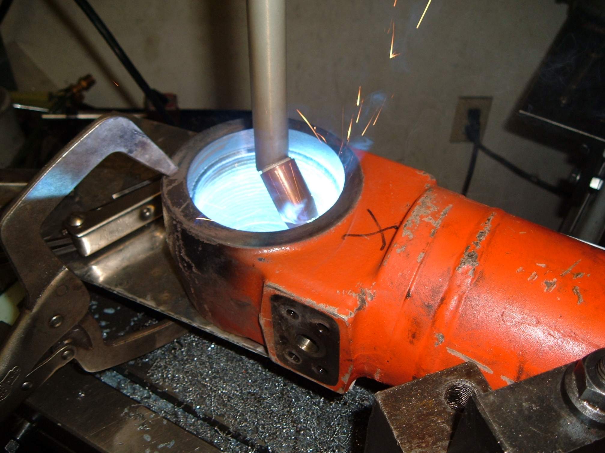

I don't know about your area but Portable Line Boring & Welding is a good business with Heavy Equipment Repair.....Material cost is minimal but equipment cost is extreme to get started......Here's a shot of repairs done in house (not portable) with bore welder......
I gather that this method of repair is to fix worn out pin pivot holes?
After setup, it is automated? What about machining the bore to final
size? Some of that industrial equipment has pins that are several inches
in diameter.
in diameter
Yes....it's the best method of repairing worn/trashed out holes.....the old fashioned way was boring out, press in bushing and weld in bushing....
At least this way does not weaken the original steel housing.....and it get machined back to original specs...
Our machine can weld up to 21" inches max.....
