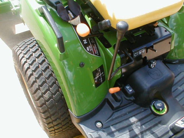

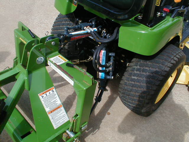

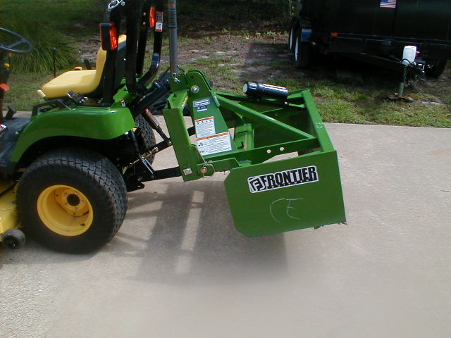

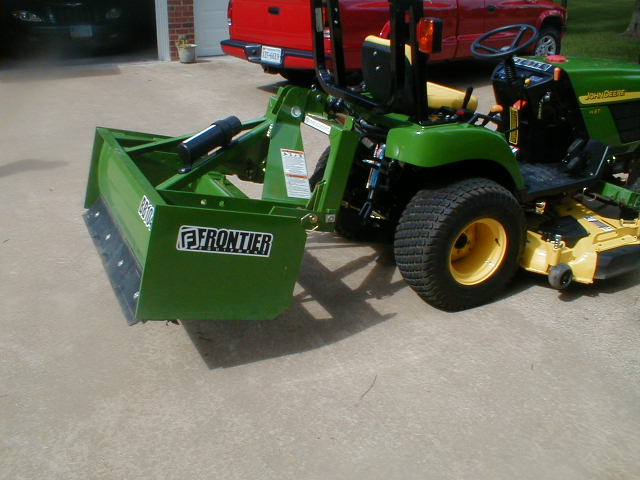

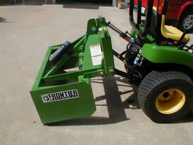

Hi beenthere:
The install was totally custom made by Jim. As I understand from Jim, his original TNT design for the 2210 was done using a prototype which JD changed when they manufactured the tractor. Jim was not aware of this JD change until they tried to install the TNT on my 2210.
No power beyond installed or 3rd or 4th SCV - not available on the 2210's. However, with Jim's TNT, I can now add additional rear SCV's to my 2210.
Chuck

   / 2210/TNT/Photos/Jim McCuan #18
Well got email from Jim today and he mentioned that if we could use the loader joystick and make a bypass to work the TNT separetly. Anyone else doing this?
TIA
