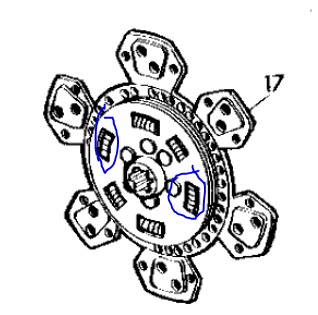

Well that makes it all clear now regarding the loader. I have come up against the extended or retracked roll cylinders before and can now see the need for the pressure relief. Thank you. I may have led you astray a little regarding the tranny but it is a little louder even when you are moving it around. I have not put it under any load yet but will soon. I was told by the previous owner that this tractor has a lot of PTO time as it was on a mixing wagon all its life. Tell me about the torsion damper please
Traction clutch hub is spring loaded IE torsion dampened to help absorb shock when changing directions or starting tractor to move. 2 of the 6 springs are outlined in blue.

Well I changed out and tightened the damper coupling at the front of the engine that couples the hydraulic pump and that cured a lot of the noise. Sound harmonics can play tricks on our hearing sometime I guess.
