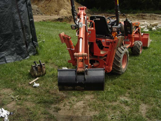

A while back TBN member Stef put up some postings in which he mentioned that he had a 24" bucket for his BX backhoe. I was the lucky recipient of that bucket when he decided to sell it because he was B3030 (lucky /forums/images/graemlins/laugh.gif). Well I finally got a chance to mount the bucket on my BX23 and have attached a few pictures. I got a chance to do some digging with the bucket and it does pretty good in sandy clay soil with some rocks. It does a great job if you are trying to dig a wide trench with a flat bottom - which is what I am doing at the moment.

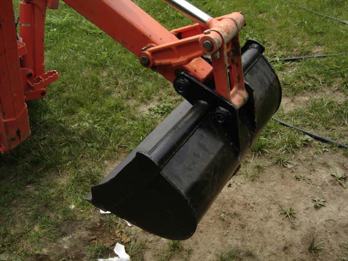

another pic..

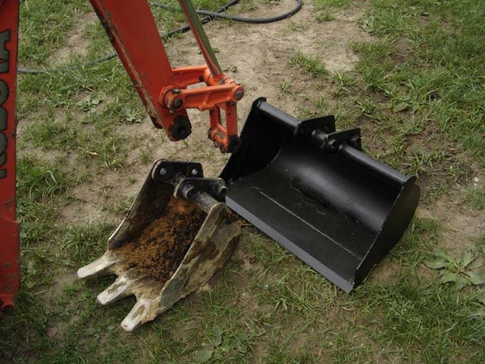

and another....

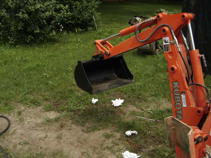

one more....

That bucket looks huge on the back of that bx. Nice setup.
   / 24" bucket mounted on a BX23 backhoe #7
Re: 24\" bucket mounted on a BX23 backhoe
Thats a big bucket for a BX , but if it does the job, ok!!!
   / 24" bucket mounted on a BX23 backhoe #8
Thats really a grading bucket. For cleanup, dressing topsoil and finish grading. You can use them to dig, but they are hard on the machine and rocks will bend them.
#9
That's pretty much what I intended on using it for. I wanted something that would make it a little easier to strip off topsoil, put a flat bottom on a hole, move larger amounts of material that is already loosened up, etc. Right after I mounted it I tried it out and it works pretty good for grading type work.
   / 24" bucket mounted on a BX23 backhoe #10
Yep, that's why it is called a "cleanout" bucket". They are definitely not meant for digging. But I doubt you can't do a ton of damage to it with the BX hoe. Nice bucket though....that will come in handy for a lot of things. Nice snag!
