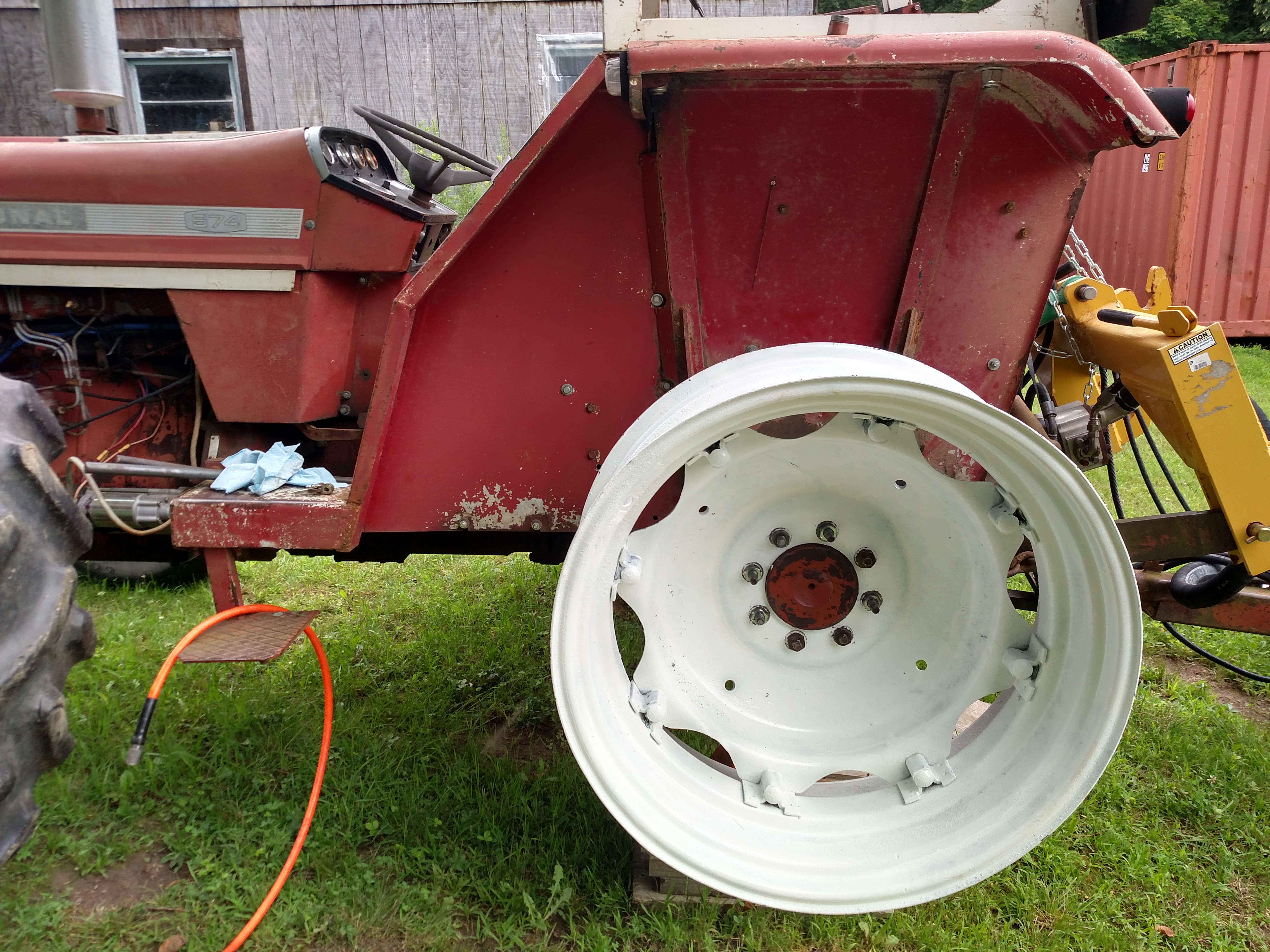

ptsg, GOT IT and thank you, was reading and came to a section called ‘wheel tread adjustment ‘ totally over my head do you know what this means ?
If your tractor has two piece rims, a center section with lug nuts or bolts like your truck wheel does and also an outer rim which fastens to the center you will have a multitude of thread spacing available to you.
As can be seen the outer rim section can be bolted to the center with the loops inside or outside of the center, also the loops are not centered on the out piece of the wheel so they can be rotated or used on the other side and again bolted on either inside or out side the center, that allows for four different treads widths, also some centers can be flipped in or out providing even more
