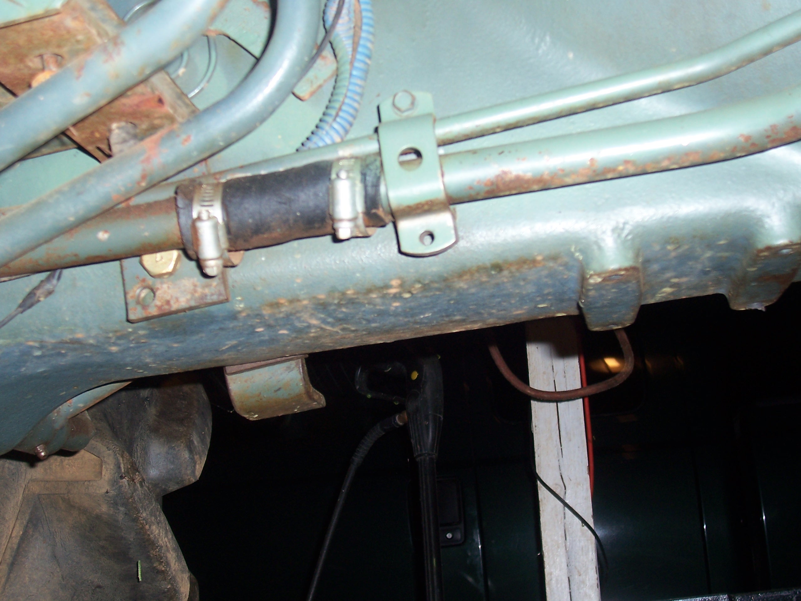

Sucking air? Check the hose connection on the suction line going to the pump. Got to be something from the strainer to the pump based on your findings on the pump. Even if the pump was worn it would still pump.

The only one that would come to mind that would be easy to damage and not loader related. And esp. working on it in the area on a 2000/240. Or possible Bad O-Rings here. Yanmar Tractor Parts: Hydraulic
