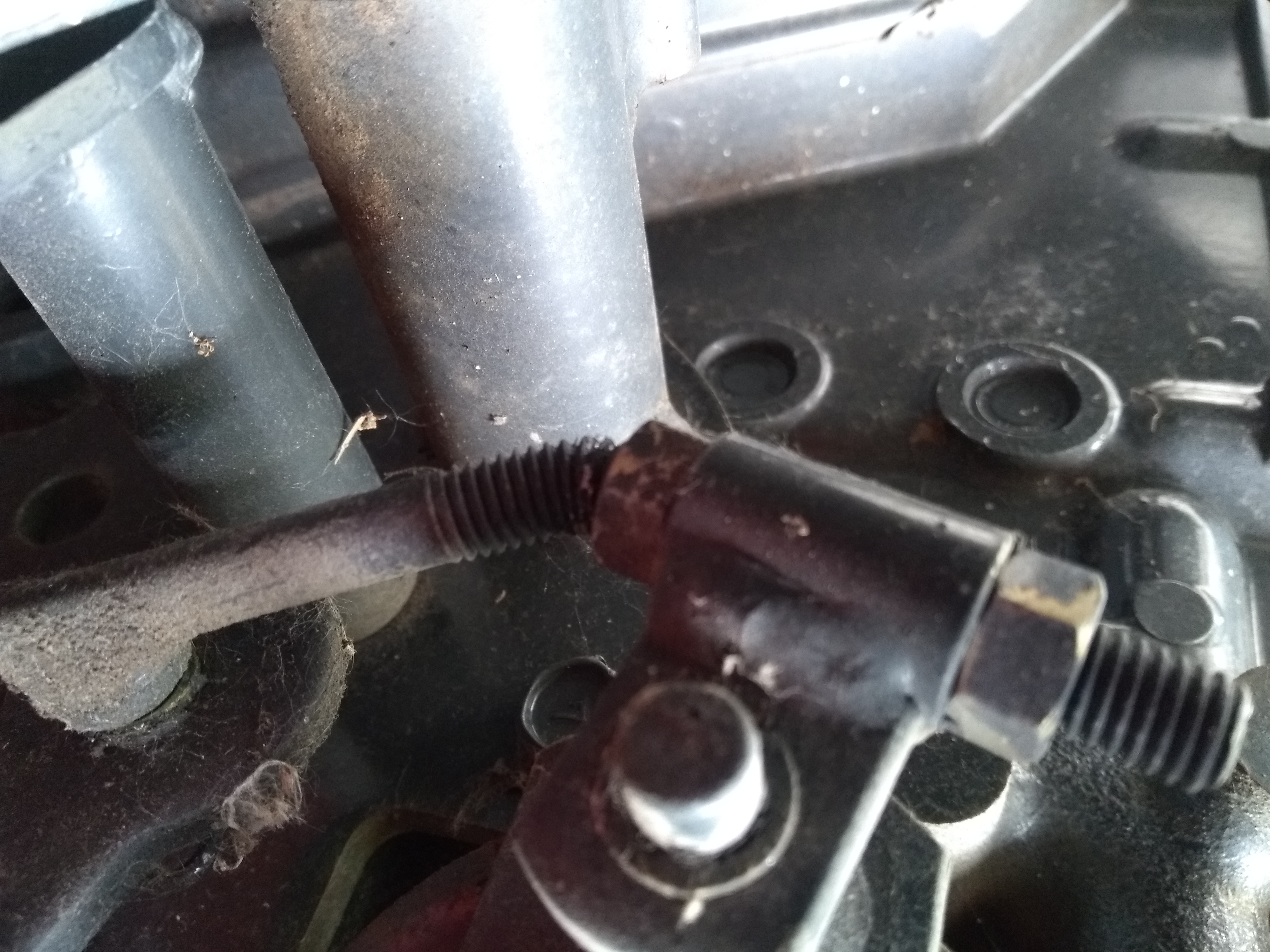

I have a Mahindra 2415 HST that I have just starting having problems lifting with the three point hitch. There is an adjusting bolt that I believe might be bent and be the problem.....if I am reading the online parts catalog correct, it is part number 10442427000 (adjuster) What I am wondering is if this is the part number that I have pictured and if someone might have a photo of the correct setting adjustment of it. Thanks IMG_20191124_103220266.jpg

If it were mine I would remove and straighten. Then thoroughly inspect. It is likely bent due to lack of lubrication at pivot joints. Years ago I noticed a stiffness when moving the three point hitch lever. I used a flashlight to make it easier to see any joints that were binding. I haven't had any issues since spraying a penetrating oil.

Much thanks, I am definitely gonna try to bend it back, hopefully that will work. If im looking at the right part in the online parts catalog, they want $40 for it. :confused3:

If you end up taking everything apart, make sure you measure the distance between the end of the thread to the nut or the part in between the nuts. That adjustment is important for the 3 pt to work right.
