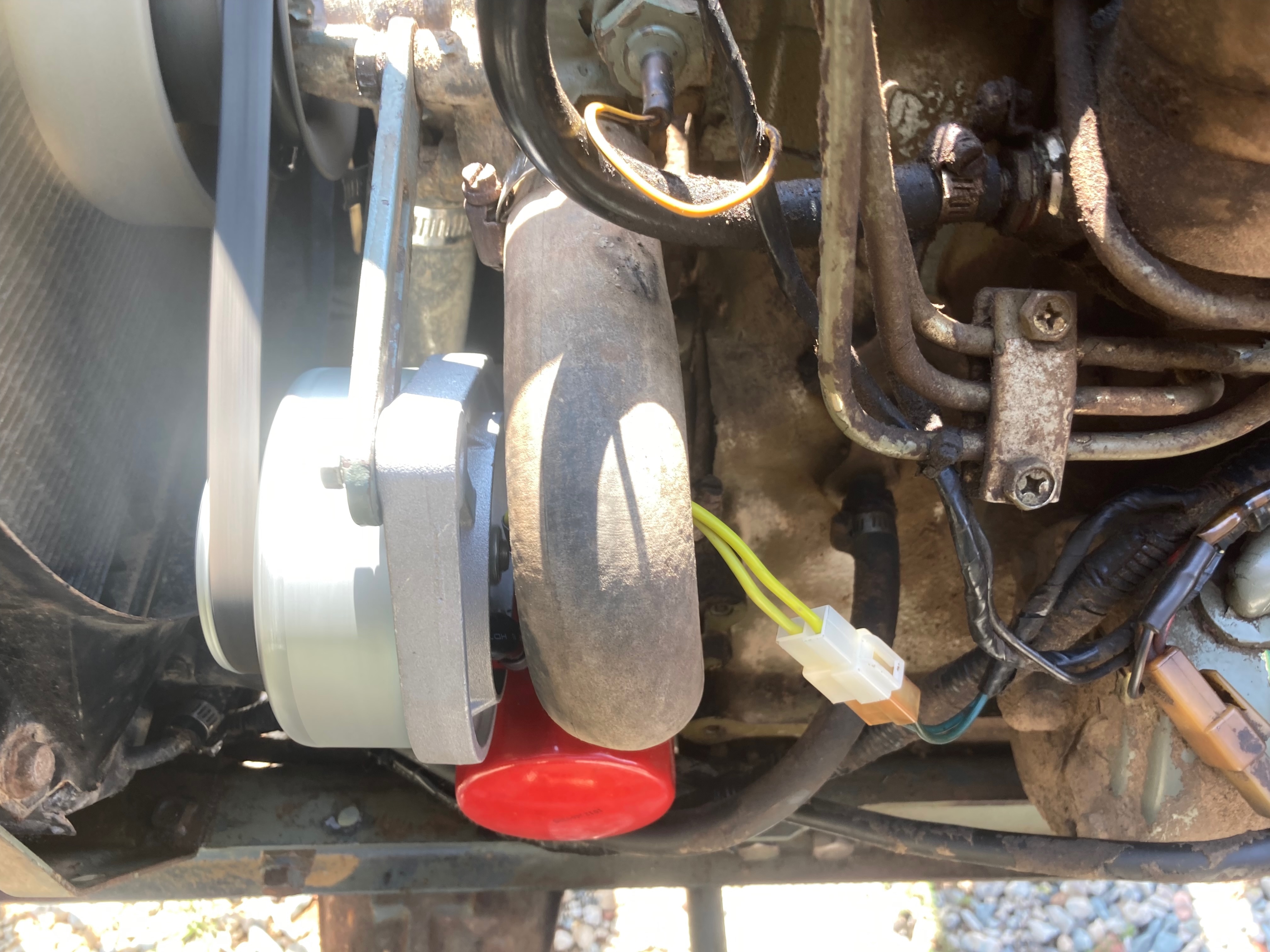

Good evening. I have a 2420D that has been a stalwart since 2006. In the past few months, it has developed some electrical issues resulting in a no-start.
For over a year, the headlights, horn, and turn signals stopped functioning, but the rest of the tractor functioned flawlessly.
Oil pressure lamp, glow lamp, temp gauge, fuel gauge, coolant level light - all worked. Thermostart and regular start worked fine, until they didn't.
Current behavior is as follows. I will get the thermostart light when I turn the key left, dash instrument lights, step on the clutch safety after the glow lights turn off, turn the ignition to start, hear the starter solenoid click, and everything goes black. After that the whole tractor is dead. No lights, no clicks, no nothing. Dead.
I checked the battery, it was 12.6v and brand new. Set it on a charger overnight and went through this whole process again. Exact same result.
Checked the fuses in the fuse box. 5A, 10A, 10A, 15A glass tubes, all fuses intact.
This caused me to to investigate and I pulled the covers over the starter and dynamo. I found that a wire was touching the outside of the dynamo, and its rotation wore away the insulation to bare wire. I suspect that may be what caused the initial issues with the lights. Who knows. Spliced in new wire and zip-tied it out of the way so no more contact with the dynamo.
Next, I checked all the battery connections, cleaned everything, pulled the battery ground cable from the frame, cleaned it, the hardware, blasted everything with WD-40, and reinstalled the battery ground cable.
Went through the whole startup procedure again and had the exact same result. A solenoid click, then an entirely dead tractor. No lights, no clicks. Anything.

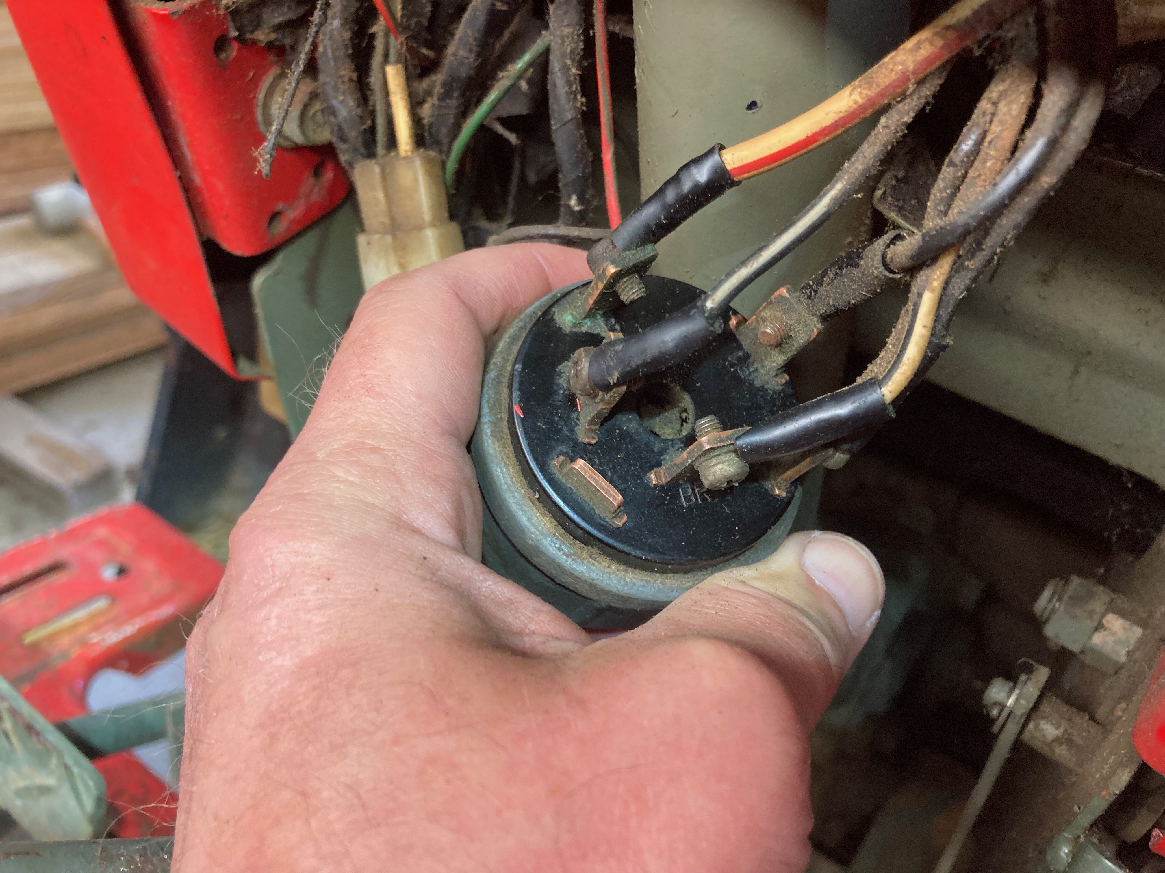

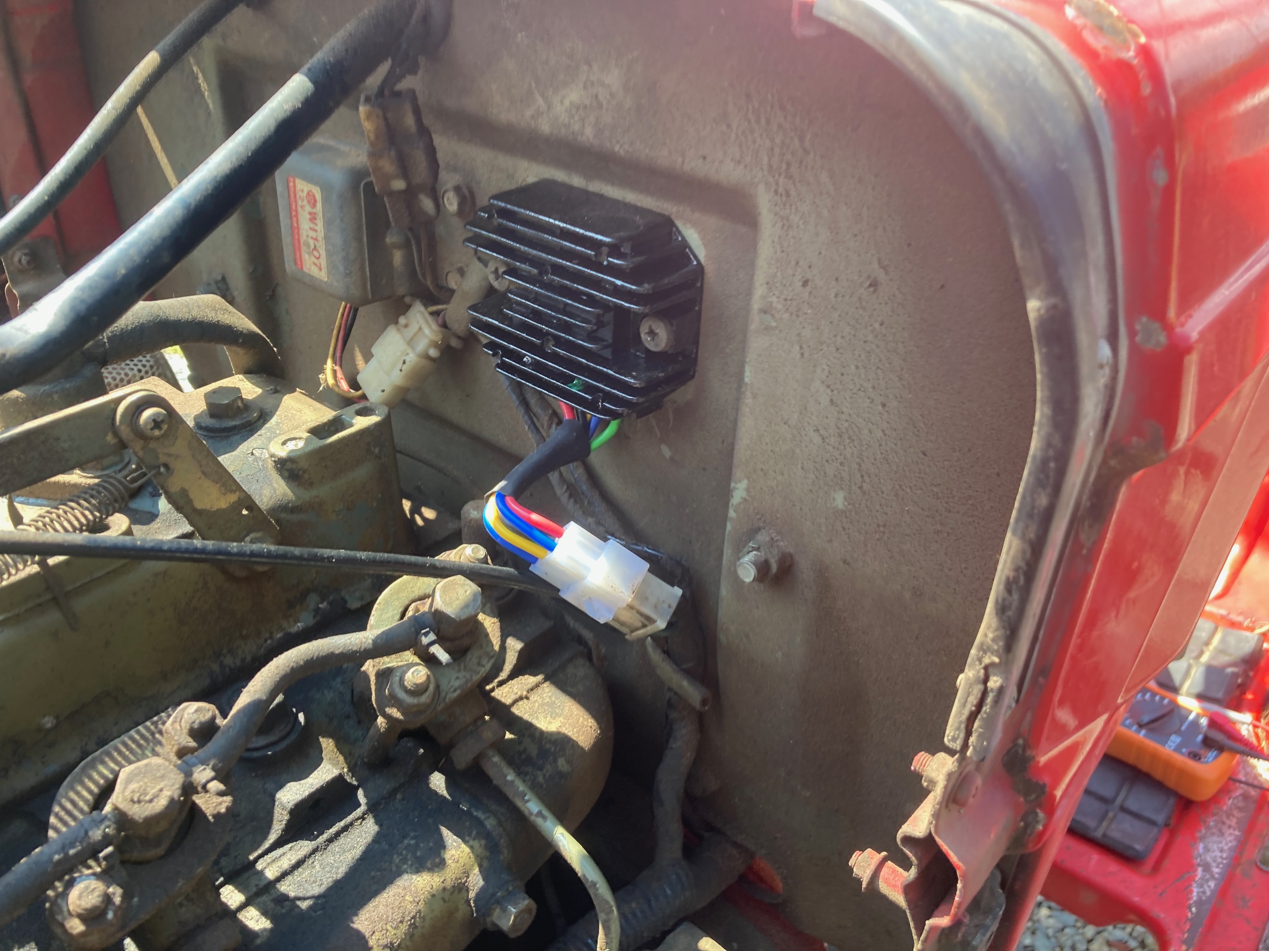

I replaced the dynamo, voltage regulator, and ignition switch. I got one successful start. Then it all went right back into this pattern. I was able to get a successful second start with an engine boost from the charger, but that hasn't worked a second time. When I got the start, I still had no headlights, horn, or turn signals.
Photos of the new dynamo and voltage regulator, as well as the wiring on the old ignition switch.
I am stumped. Thanks for any help / ideas / suggestions.

I'd say you've got a bad connection somewhere. Engine to frame, ground cable to engine and/or frame etc. You've got enough of a connection for something that doesn't draw a lot of juice. Minute you put something that draws a lot, the connection arcs out.
Are you >>sure<< the battery is good, voltage doesn't mean as much as it's ability to supply the amps. Think of it this way, you could have 8-1.5V penlight batteries hooked together in series and you'd read 12V but it wouldn't turn over an engine. Do a load test on it is the only real way to test it.

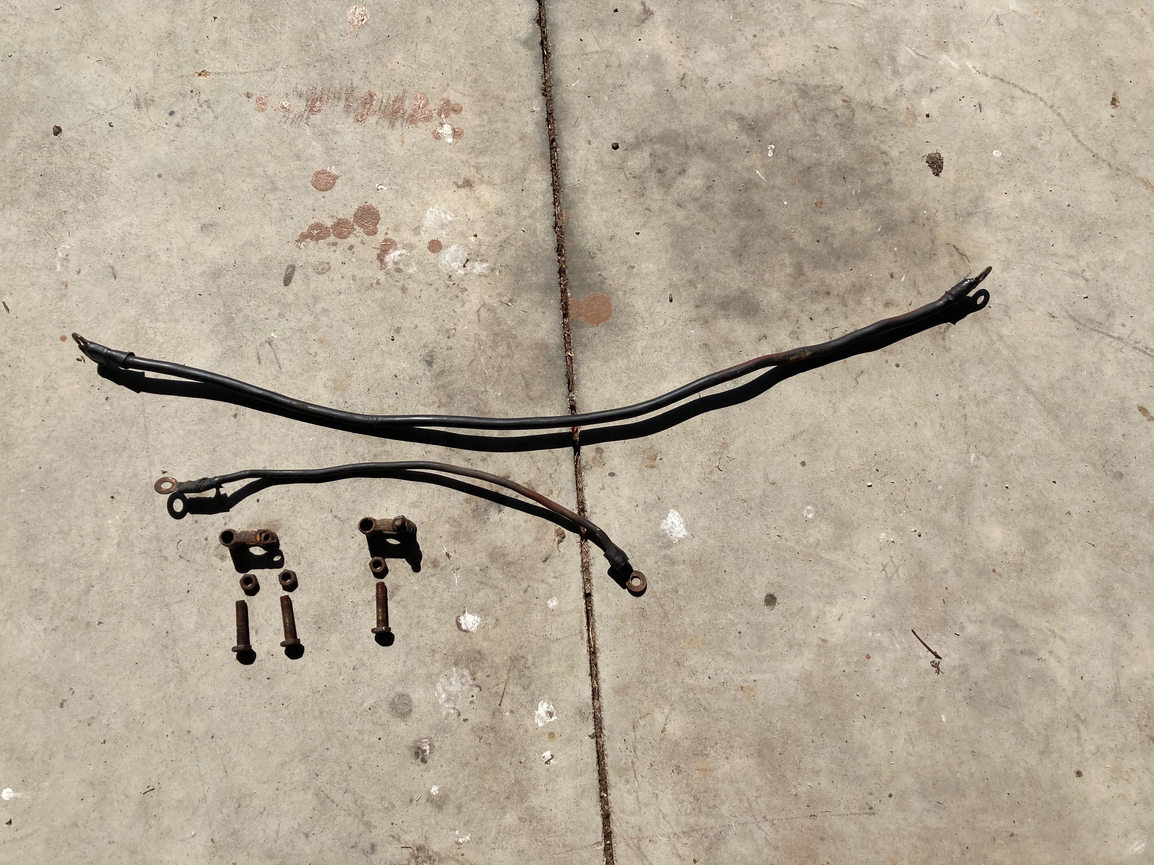

Since you've cleaned all of the high amp connections, consider replacing the cables themselves. They have been known to corrode on the inside, which would account for your symptoms.
The actual battery cables are the most susceptible.

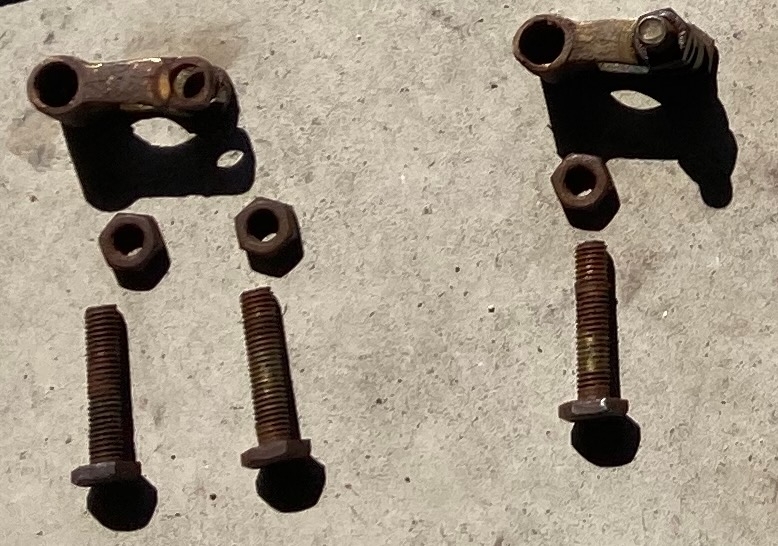

Update, gentlemen. Thank you all for the input. I am happy to report success. I did the following:
  • Replaced the old battery cables with new, 2 gauge wires
  • Replaced all the old fuses, cleaned all the fuse contacts inside and outside the fuse box
  • Cleaned the connectors of the light switch, turn signal switch, and horn switch under the dash
The results are:
  • The tractor runs reliably for the first time in six months
  • The turn signals work
  • The horn works
  • The main lights don't work and I think a new light switch is in order
  • I also nuked the set screw on the light switch knob, even after soaking in in Liquid Wrench for 30 minutes. The metal (brass?) was too soft and it stripped right out
Added bonus:
  • Take the extra two minutes to remove your shear bolt from the drive shaft and gear box connection on your bush hog, remove your drive shaft from your bush hog, and store it in the nice, dry indoors if you won't be bush hogging for several months. It saves you a couple of hours of hard labor with a come-along, chains, Liquid Wrench, scotch pads, and lube of every kind to restore your drive shaft to working order.😁
Photo below of the old wires and battery clamps. In the close up of old battery clamps, you can see the rust and corrosion. In addition, the fit of the bolts through the clamps was not flush. Note the interior diameter. There had to be anywhere from 1/16" to 1/8" of gap between the bolt and the internal wall of the clamp, which may have provided an opportunity for some arcing. Who knows?
