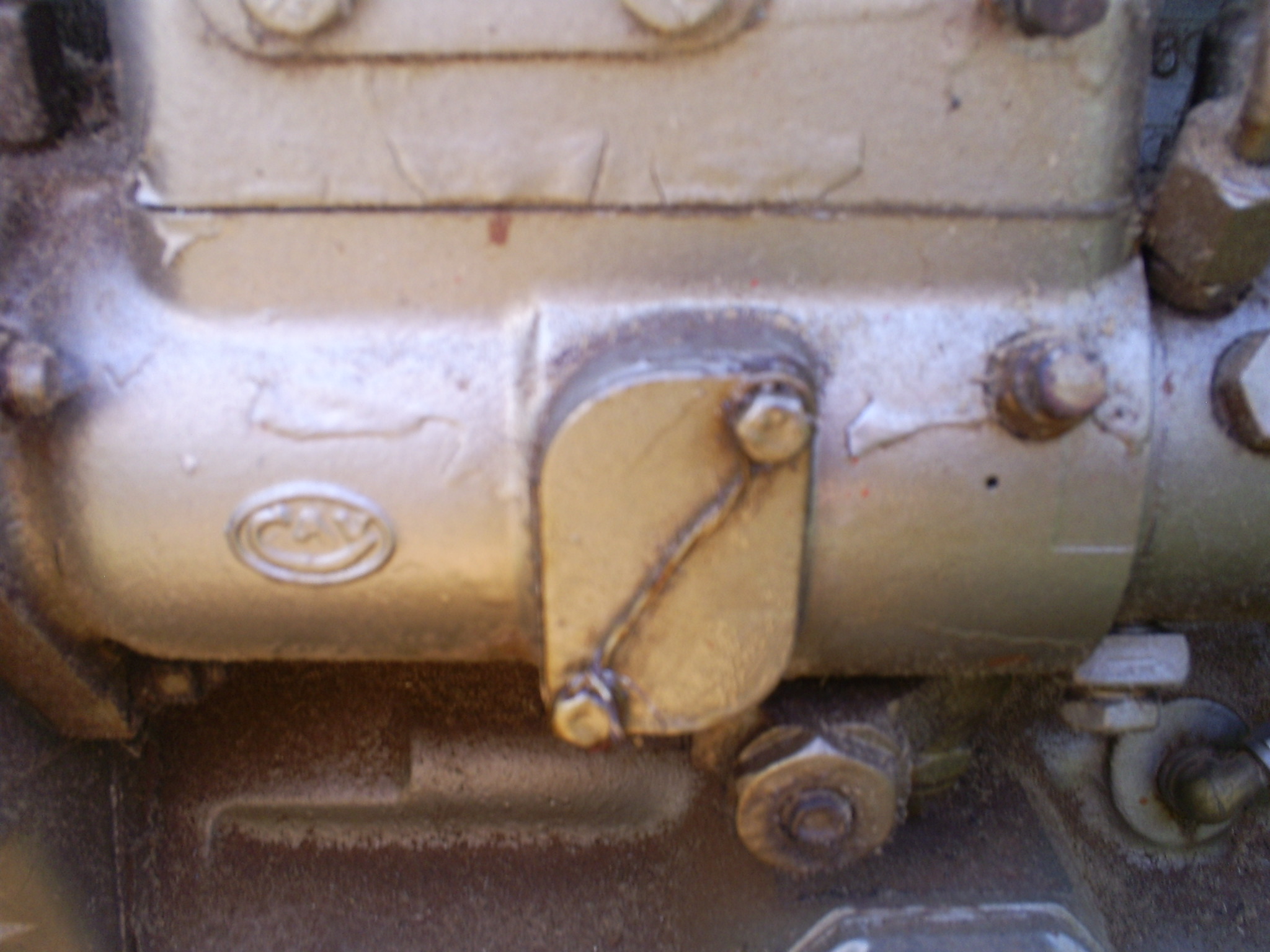

It is leaking around the plate with two small bolts connected with wire, can I take bolts off and replace gasket, other advice? Thanks

See if the bolts are tight, if so gaskets do get hard and brittle over time and start seeping. I have the gasket if you need one. I repair these pumps, can mail a gasket if you like. Call 574 893 4172 after 7PM if you have any questions.

Very nice, I plan on giving you a call, thanks.

Dieseltech helped me out tremdously!!! Can't say thanks enough :thumbsup:
