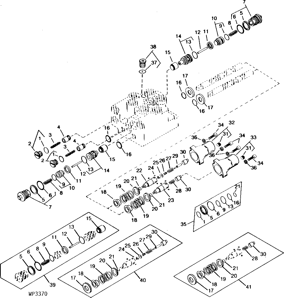

What I had not considered was the return springs in the valve are too strong for a shorter joystick. Of course the springs were made to have the drag of return 5 feet of cable plus the original joystick was much longer so there was more mechanical advantage to move the spools. If I kept these springs, especially in the bucket control spool I would have very tired hands after moving winter snow. So I have opted to change the springs to a softer one because now there is much less drag and less mechanical advantage.
Enough with the why, now the question: I can't figure out how the lift spool detent gets re-assembled. I have all the parts in order and have tried numerous methods but I can't get the 3 ball bearings and the 2 springs into the cap in their correct positions. There is probably a procedure but I don't know what it is and I was wondering if anyone here has had their lift detent apart on their Eaton valve and know the procedure. I am guessing this style valve was used on many of the 245 265 and other farm loaders in the 80's and 90's.

Mount valve in a vise, detent ends of spools facing up.
Use a punch to knock vent 31 from end cap 32 or 33. I knock out from the inside.
Insert from the outside of the end cap, through the vent hole, a punch/screwdriver/rod (choose one) that is longer than the vent cap
Use the punch/screwdriver/rod to push down on cone 30 to compress spring 27 or 28 until cone 30 is below holes for the balls 24
Continue to hold the cone down, grease balls or holes for balls, install balls in holes.
While still holding cone down, slide the end cap down the punch/screwdriver/rod.
Install retaining screws 34 and washers 36 for end cap
Install vent 31 back into end cap
To be clear, when I say use a punch/screwdriver/rod, you will only use one of these, NOT ALL THREE!. what ever works best for you :D

Just want to say thanks for the info. Putting it back together was very easy using your procedure.
