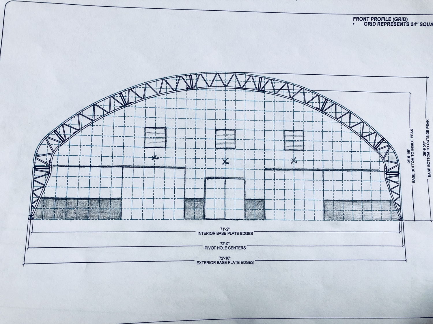

I’m having an end wall built on my 72’x 300’ clearspan fabric building. The end wall is going to be R-Panel to match my barn. It is dome shaped and 30’ tall in the center.
I’m on Texas black clay soil. I’ve had a handful of contractors come out to bid on my job and it seems like they each preferred a different foundation style... a giant footing wall across the whole 72’ front... concrete piers with base plates, or the metal posts set in the concrete like a normal fence post.
What do you guys think? I just want to make sure it’s done right...

I'm a little unclear from your description. Are the posts holding the weight of any roof, or are they just holding the wall?
Foundations are highly location-specific. There are two factors. First is the bearing capacity of your soil. Second is the local environmental factors. Around here you have to have enough area to support snow loads, go deep enough to prevent frost heaving, and have uplift protection for hurricane-strength winds. Other areas might have earthquakes or other factors to deal with.
How the post is connected to the footing is nearly as important as the shape of the footing: how deep it is, how much bearing surface area it has, and how it's shaped to avoid uplift. If the posts are just holding the wall and not any roof you're not talking a lot of weight so the footings don't have to be very big, just big enough to stay put.
   / 25’ 4x4 Metal Post in concrete or base plate on concrete piers? #8
Concrete pile with steel plate.
What kind of forces is the top of the steel post subjected to. Thinking of wind loading, flexing, and buckling issues.

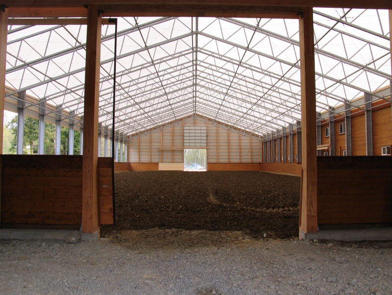

It’s just a large vertical metal wall that won’t bare any roof weight. The wall’s frame will be bolted to the main structure for more stability but it won’t really add much to weight to the load bearing requirements.
The drawing is what I’m having built.. the other picture is an example of what some one else did, but using wood to kind of give you a better idea..
