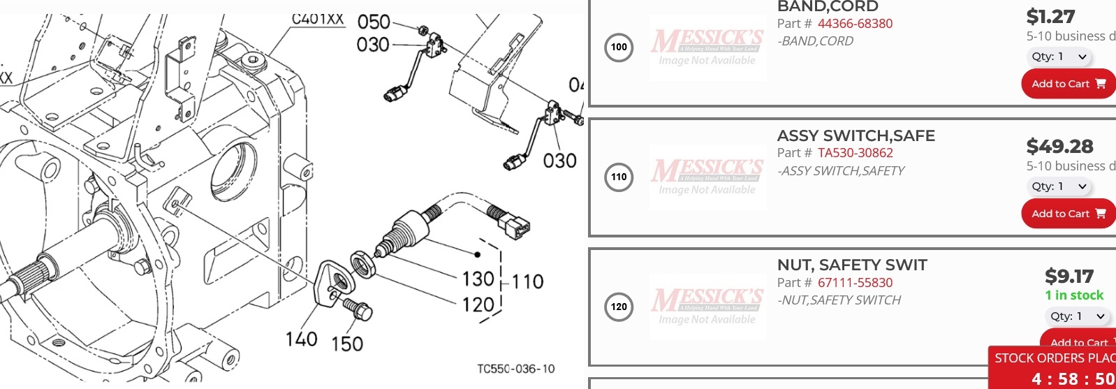

   / 2501HST Clutch Safety?
I don't spot the clutch switch.
   / 2501HST Clutch Safety? #4
Not 100% sure but check on the side of the transmission case where the transmission lever goes in...
You can look up parts in several sites...
Just looked again, I'm a dumbo
Looks like a cake-walk...
I'm "old and blind", might be better than needmoredirt - LOL
thx again!

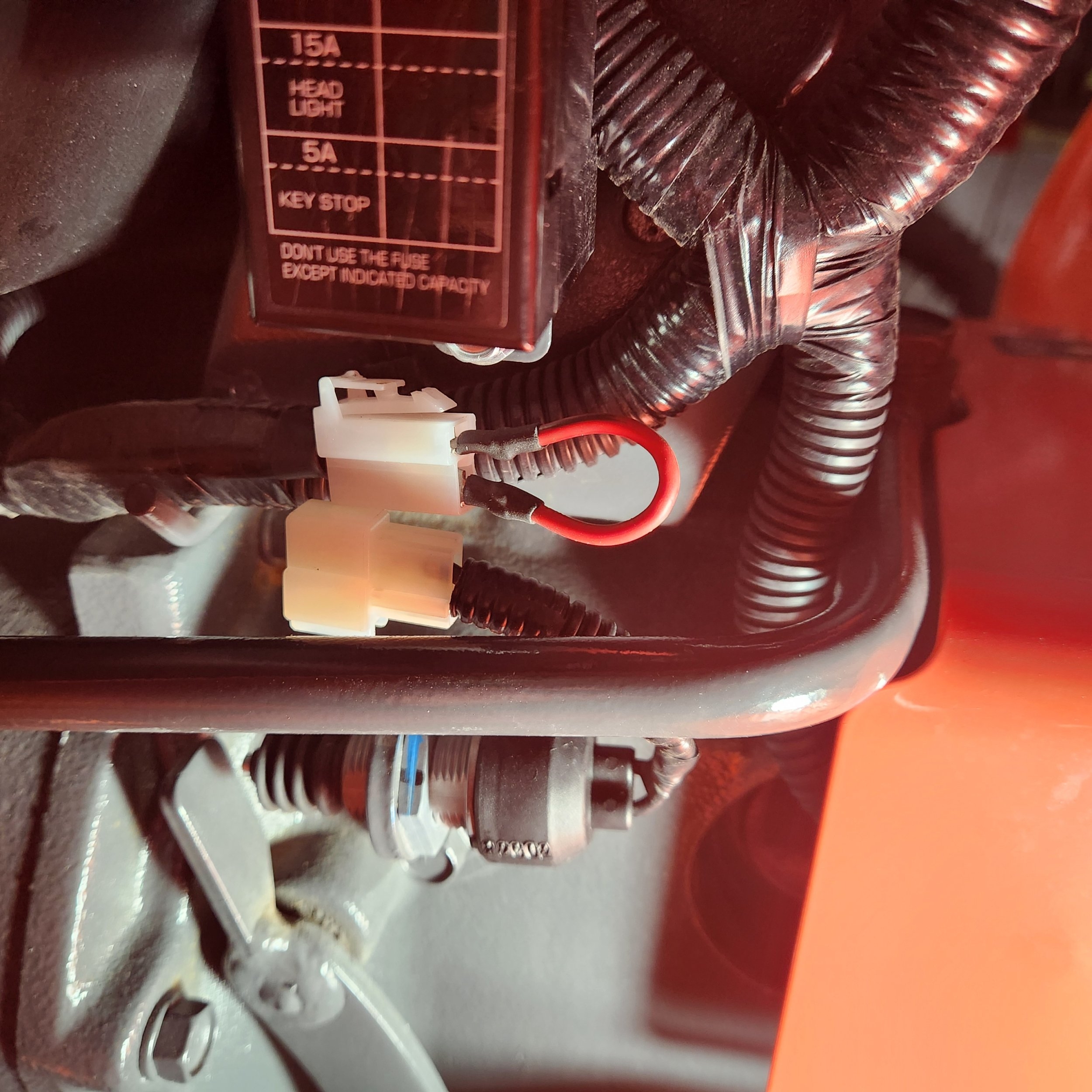

Sure, why not.. A couple male spades, enough wire to remove easily with one finger and some heat shrink.
Might need a drop light or flashlight to see under the fuse box.
   / 2501HST Clutch Safety? #8
I did this for the seat switch (though I didn't add heat shrink like you did).
I'm all for safety, including automatic things like the seat switch. But it was so damn sensitive! Whenever I leaned forward, like to set the parking brake or get a better view of implements and obstacles, the damn thing would die.
