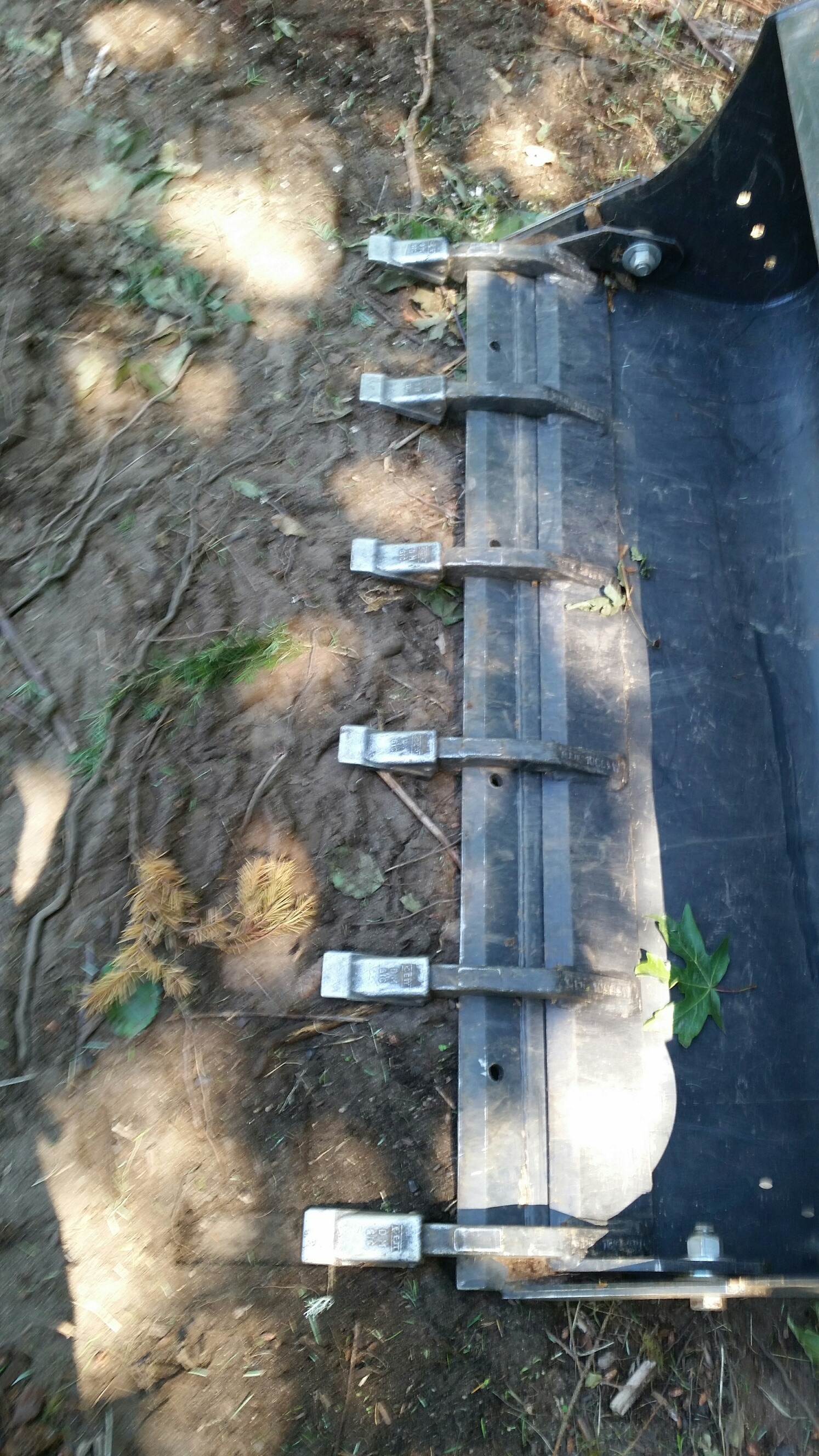

southern Al- Im going away for the holiday weekend, ill post some picks of the toothbar when I get back. Not sure on the manufacture, I ordered it through the dealer and there are no makers mark on it. HUGE difference in digging ability, especially if your trying to dig out stumps.

Here is a pic of the toothbar as requested:
   / 2510H Zerk fitting #8
I really like that. Anyway you can find out who makes it? Is that a 5 ft. boxblade?
