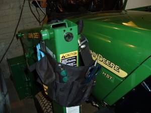

I got mine loose with big channel locks that I keep in a tool carrier on the FEL tower, after I removed that 12 mm bolt and rotated the assembly (the fuel flex lines allow this) up to where I could get to it. I've a chain wrench that would have worked, too. This chain wrench is what I used on the oil filter initially, too. Have sense bought one of those 3 fingered oil filter wrenches from NAPA for it.
I still removed the fuel filter assembly for the 2nd fuel filter change recently. It's easier that way than mucking around down there half blind behind the FEL tower. Found a 12 mm socket binds in there. Better to get a 12 mm box end ratchet wrench.
Here's a pic of my tool belt. It's chock a block full now. This is an earlier picture. The channel locks are to the left.
Ralph
