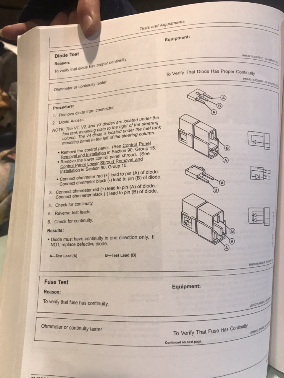

Picture A shows 4 diodes they all checked good only the one in the middle of the 3 goes to the fuel side of things. B not sure what it is but it has the main blue wire that goes to the plug on the solenoid. Not sure how to check this one nor what it should read. C has a orange wire going to the diode on the left not sure how to this one should be checked either. D is the plug to the solenoid I ran a ground and a hot from the batter. Grounded the top flat of the plug and touched the two side by side prongs, only one of those made it kick in. Replaced the fuel filter with no change to it running. I'm going to take C and D to John Deere in London Ky today to see what they tell me if you guys do t know. They may or may not help there not to friendly when it comes to questions.
