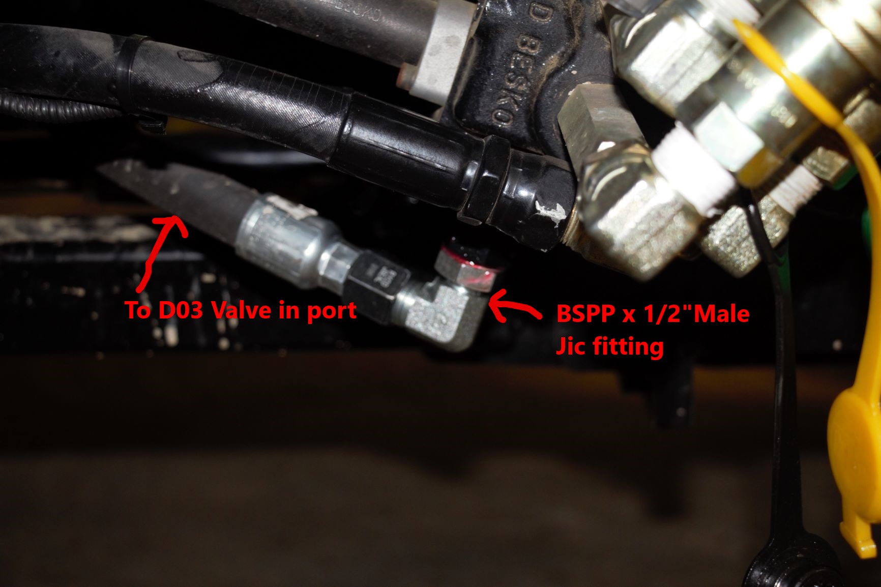

here is a picture. i built my own 3rd function(with as much local availability as i could....) but if your in the US, it is probably a lot easier to get a hold of WR LONG and buy their kit IMO.
the bottom fitting i refer to is the PB LINE. i bought an adapter to go from the original 90 degree fitting to a more common JIC style.again its locally sourced....
