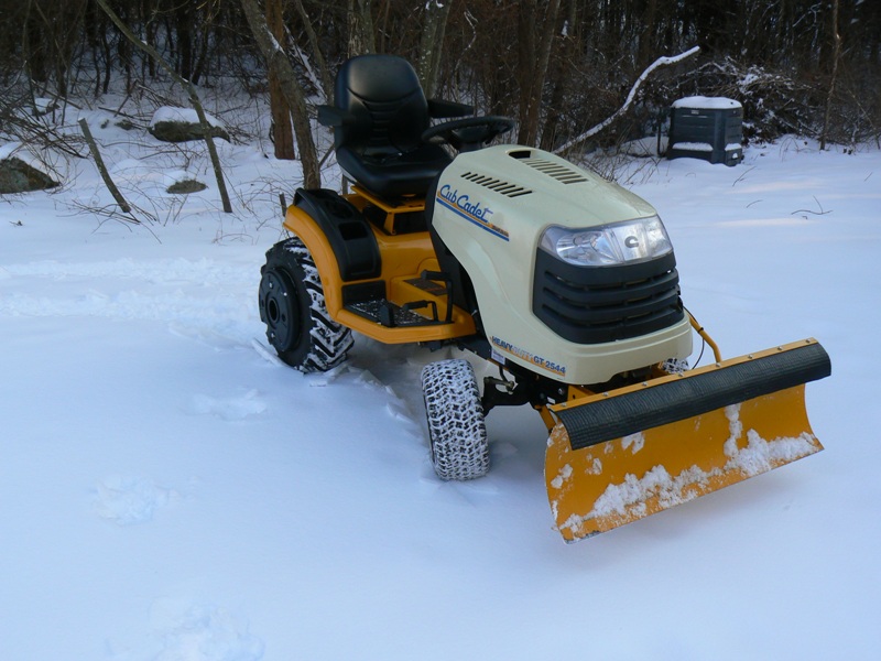

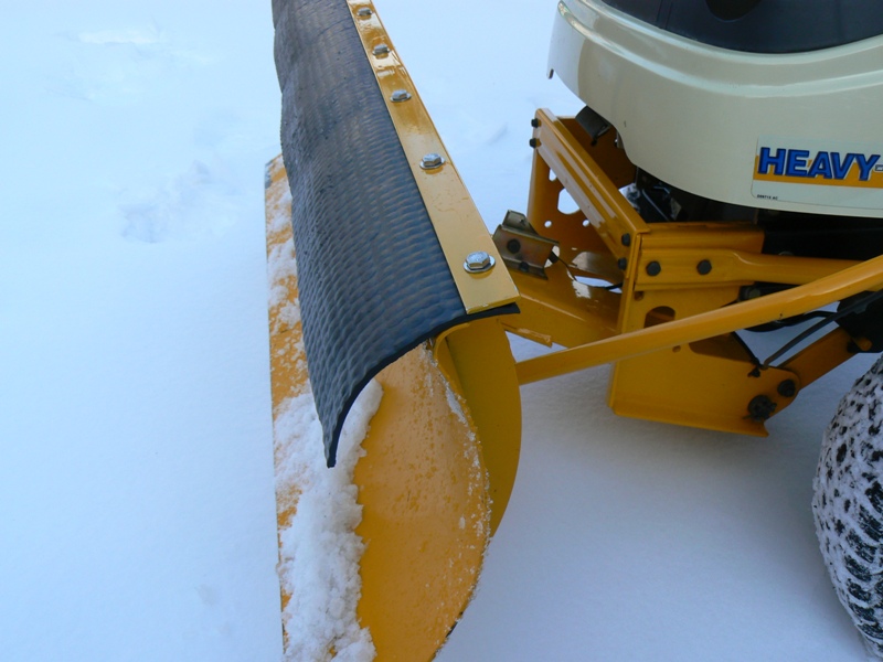

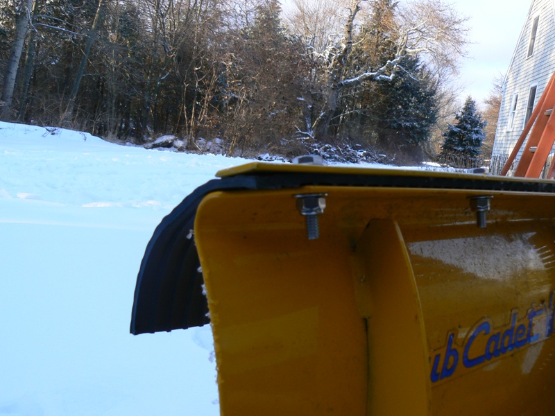

The last snow storm we had dumped about 9", and one thing I noticed is that the snow would roll over the top of my plow, even when angled. Basically I wasn't getting a good curl. So I decided to make a rubber flap like what the big boys have.
I started with a roll of 48" wide x 1/2" thick floor matting from TSC, and a 42" x 1" x 10-gauge piece of stainless steel from work. I drilled 8 holes in the SS, then clamped it to the top of my plow and templated the holes into the plow. Then I rolled out the rubber mat and positioned the SS onto it to template the holes from. Once I did that, I used a straight edge to trim the end of the mat that would be hanging free. I then bolted everything up to make sure it worked as I planned, and trimmed the excess rubber hanging off the top of the flap (behind the plow). I then painted the SS with Cub yellow and gave it a day to dry. Note: painting outside in 25 degree weather doesn't give the best results.
This morning I put it all together and gave it a try. There wasn't a lot of snow to work with, so I took a bigger bite per pass in order to load up the plow fully. The flap worked exactly as I had hoped. I was able to take almost a full blade's width with each pass, and the snow curled beautifully. I even dived into banks of snow that were taller than the lower end of the flap, to see if I could "trap" it, so to speak. But once the snow started to move, it just pushed the flap up and started to curl.
All in all, I am a very happy camper with this. The paint job sucks, but that's something I'll remedy when the weather gets better. I don't have any "in action" shots, unfortunately. The ones attached are all I was able to get.

How much of the flap hangs free? Looks like something I'lll have to ad to my plow. Thanks for posting the write with pics.
   / 2544 Snow Plow Flap
It's about 4-1/2" hanging free. I originally started with a 6" strip and left a little hanging out back so I could trim it right to the strip.

Looks like it would work ok as long as the snow goes up under it and lifts it up. :)
If the snow hits the front of it and pushs the flap back against the blade it won't work. :(
Not true, as long as the blade is angled. I tried it to see what happens, and once the snow starts to move it lifts the flap up and the snow curls like normal. If the blade is straight, then yes you can "trap" the flap, but only if the snow is 10" or more.
