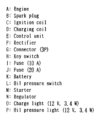

260 won’t start lawn tractor, put new pto on and won’t start. Power to starter, seat safety switch ok, trying to locate brake safety switch!

No not yet I polished the contacts on safety neutral switch, I guess I will order a switch next.
I don’t know if the relay switches go out very much I have three of them!
I wouldn’t think the rectifier would be a problem area. JD dealer was not much help. Running out of ideas.

It was showing 12.63 dcv not a load test, the battery is only a few months old. And getting a good reading at starter. I guess I was hoping to get another idea from the parts guy.
The starter bendix doesn’t even make any noise.

Could be the pto switch itself. It's part of the safety circuit. Even though it clicks the pto, the safety part could be bad. Seen that a lot as the current goes through that switch. Every time I replaced a pto, it got pto switch also.

That’s good to know thank you. So you think pto switch would be better to change than the neutral switch in transmission.

Nothing you haven't already considered, but it sure sounds like the starting system thinks the pto is engaged. Maybe check and clean the electrical connections on the pto and switch?
I had bought a switch several years back and grabbed it off of another chassis.
I cleaned and dielectric grease in connection but recheck it again. Thanks for a new idea.
   / 260 won’t start lawn tractor, put new pto on and won’t start. Power to starter, seat safety switch ok, trying to locate brake safety switch! #20
Neutral switch is easy check as in it works or doesn't. You'll need a multimeter of some sort to check it. Pto switches are more difficult to check with 5 - 6 wires running through them. Pto is money well spent since you just replace the pto clutch. Like I mentioned, I always replace them in pairs, pto switch and clutch. Good luck with repairs.
